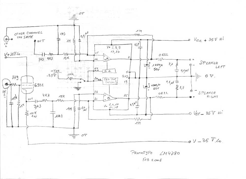

Hello,
Here is a shematic from an LM4780 with vaccum tube. 😉
I have write it while thinking of the homepage of our newest member - Joe Rasmussen on "the JLTi Tube Hybrid Amplifier".
I would like that you say to me that do you think about my shéma.
(Oh... sorry for my poor english) :bawling:
A lot of thanks
Almu

If something " sound good ", it must not be " end station ", sometimes is improvement possible. But if you are satisfied, let it be 😎 . BTW in many times was connections fifty ears ago better than today's, 'cos at this time constructeurs had know, what they make 😀 .
