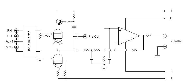

Simplyfied Schematic
Here is a simplyfied schematic.

planet10 said:
Joe,
What is the purpose of the high-pass filter on the input of the chip?
dave
Hi Dave
Basically, if you look closely, there is in fact
a band-pass filter. The initial cap in series is
needed for two reasons 1) isolate the DC off-set
from the Tube Buffer (about 1V) and 2) also to
make sure the DC off-set into loudspeaker is kept
down to a few mV.
The low-pass is inserted as a part of the feed-
back and is much more difficult to explain. It
too has two functions, one to shunt the feed-back
to signal ground (that's the cap you can see
actually go to ground) at frequencies well above
audio. This keeps the feed-back loop very short,
down to centimeters, where it is most desirable
(high up). We can do this because it's above the
audio. The resistor BEFORE this cap, in series
with the signal, forms a low pass filter (and
hence completes the band-pass mentioned earlier)
- 1st order and very benign - to reduce potential
slew rate problem in the 3875. I was actually
able to induce slew rate distortion just above
300KHz, so we need to be down by a good margin
at that point. Without this it sounded very clear
but also a certain brightness was eliminated. This
was confirmed by a number of members of my
unofficial listening panel. :)
Hope that explain things.
Regards
Joe

Joe, may I make a suggestion?
As I got, you try to mix the best from the two worlds.
On the page http://www.dself.demon.co.uk/thermald.htm there is a very nice distortion plot of TDA 1552. The thermal distortion really exists in power IC (gainclones). May I propose to reconfigure the feedback so the tube stage will appear the input stage of the whole amplifier. In this case it should be common cathode stage with AC overall feedback in cathode, now your amp will be free from thermal distortion completely.
My next suggestion is to make output resistance adjustable. You will need only several passive components for that.
Hi Dimitri
Tried the link you gave but it no longer seems
online?
I hear what you say, but to include the tube
stage is not practicable if you look closely at
the circuit. The buffer (unity gain) has no way
of easily accepting feedback.
I am loath to use a triode gain stage as there
is already too much feedback - I want to go LESS
not more. Also I've avoided 'warming up' the
sound - and adding a stage that increases 2nd
harmonic may well sweeten things up (and other
tricks). Actually lessening feedback did the
job for me and got the BALANCED result I was
seeking.

Hi, Joe
... include the tube stage is not practicable if you look closely at the circuit. The buffer (unity gain) has no way of easily accepting feedback.
You can reconnect from the follower to common cathode stage
I am loath to use a triode gain stage as there is already too much feedback - I want to go LESS
not more. Also I've avoided 'warming up' the sound - and adding a stage that increases 2nd
harmonic may well sweeten things up (and other tricks). Actually lessening feedback did the
job for me and got the BALANCED result I was seeking.
I could not get how you make LESS feedback, than in typical application from data sheet. What feedback makes wrong to you (and your gainclone)?
It 'warming up' the sound was not your aim why have you used the tube? For marketing purposes, just to add that nice word in your ad?
Hi Joe,
(Or should that "Hey Joe"?)
> not more.
Actually, I feel the reverse is true. Around the Power Op-Amp you need a lot of negative feedback. Anyway, views vary.
