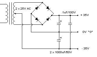

Here is my suggested Power Supply – keep in mind I am NOT supplying a PAINT-BY-NUMBERS project, this is for the serious DIY’ourselfer.

Note that I use a feature also used in the commercial JLTi Hybrid Tube Integrated Amplifier. When power is connected to the IEC socket the Tube Buffer powers up and stays in Stand-By mode. The Power Switch then only turns On of Off the Gainclone output stage. This so-called ‘Permanent Stand-By Mode’ means that when amp is plugged into AC, make sure that the Power Switch is set to OFF. In this way we avoid rude noises of the Tube Buffer as it stabilizes.

I've got the parts for the tube version on order, and I have a question about the PS.
For the +/-35V for the chips, I ordered a 50VCT 2A transformer. I assume this is is enough to power 2 x 3875's?
Now for the tube, I already have a small 24VCT transformer. Will +/-16V be enough to supply the 6922? I prefer to use this if possible since it would make for a nice low-draw standby mode.
Or would it be better to just power the tube from the main transformer? And if so, do I have to worry about implimenting minimal path distances and mounting caps right on the chip, or is on-chip mounting only an issue for the signal path around the chip? Or is it better to put 2 sets of filter caps, 1 on the chip and 1 on the tube?
Any other ideas welcome too.
100 VA for both chips? 300VA is recommended. I'm going to use a 600 VA i have been looking for a use for (should be good for 4 channels if it works out)
Tubes like lots of B+. The 70 V speced is already kinda low.
Yes, And then get a beefier trafo for the 3875s...

Well, I already ordered 2 of the 2A xformers, so I guess I'll plan on using 1 each per channel.
So, if I power the tube using the same xformer, I guess I should put a set of 1000uF/1uF filter/bypass caps right on the 3875, and another set right on the tube socket?

Dave: Is the schematic OK?
Shouldn't the CT become the 0V, and the output from the rect. the -35V?

Actually the 50VCT 2A (100VA rated) would do handsomely for the 6922s, but no way +/-16V be enough as the 6922 would only end up with about 15V across Anode/Cathode. But a tx rated as little as 5VA 50V CT could be used.
As for powering the tube from the main tx, not really recommended - the dynamic load factor on the secondary may modulate the 6922 supply too much.
In the end I would use 8 x 10A/100V Schottky diodes (or similar) for the 3875s, two discrete bridges (that's what I use in the JLTi) and each bridge for one large tx (min 160VA at least) OR better TWO, one for each bridge and 2x 1000uF.
Again same applies for 6922 supply, here I used 8 FRDs. But a single tx is sufficient with the same common secondary feeding both bridges.
So in all you will need 8 x 1000uF electros, preferably Panasonic FC.
Joe
No problems.
For the 3875 absolutely yes! As for the 6922 supply, the location of the 1000uF caps not quite as critical, but - I repeat - should not be powered from the same tx.
Joe
