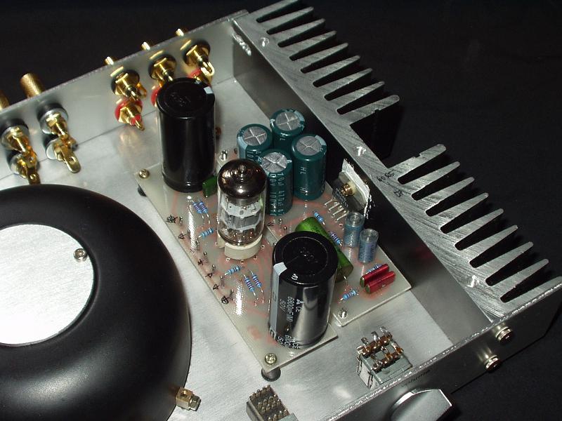

I've been completing the construction of my hybrid power amp with an E88CC tube as a buffer. I expect to have it finished in a couple of days, do some final measurements and then I plan on doing some listening tests and compare it with the small power amp Aleph3 I built some time ago. I could present the results of those tests here if there's enough interest. First, a few pics:
Regards

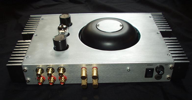

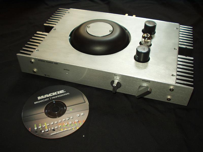

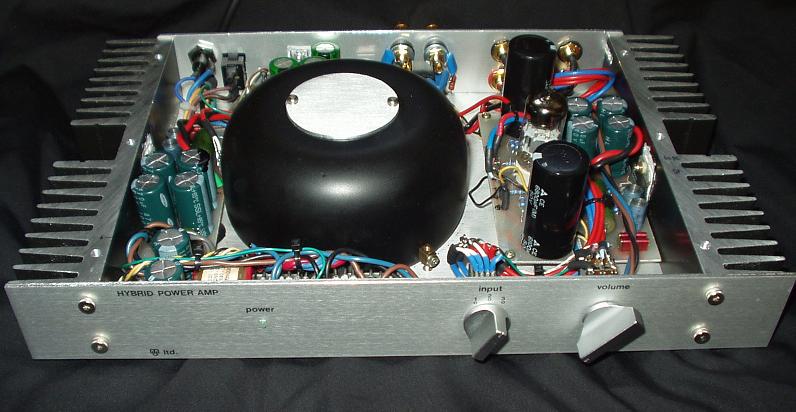

TGC measuring results
Hi all,
I finished my TGC amp a few days ago, and here are the results.
First, I wish to thank everyone for their support and interest. (Especially to Joe for this thread )
On construction:
When I was thinking about building an amp, I wanted to use as many readily available resources as possible and as less money as possible so I piled up parts from discarded equipment and stuff one would expect to find in the back drawers of, say, an audio equipment repair shop. The amp was built on 5 PCBs, designed rather sloppily using an ancient Protel version, then drawn by hand with a permanent marker and etched using HCL and H2O2 (my Protel design is of such a sub-standard quality that it's completely unintelligible and of no use for anybody else unless I sit down and re-design the whole thing).
The box consists of AL plates 2mm thick and 2 heatsinks on each side. The transformer is covered by an Fe lampshade 🙂-)) with an opening at its top, which I closed with a brushed round AL plate. That's all.
When I'm working on some project, I somehow always seem to find out useful new information only after I've already fixed the last screw, which is not only frustrating but also means that I would certainly do things differently with the benefit of hindsight. In this particular case, I wish I had made 2 separate mono-blocks and a bit more complex buffer circuitry.
The only serious problem I encountered (and had not anticipated) was a huge amplitude instability (switch on noise) occurring when the amp was being switched on and disappearing once supply voltage stabilised. This was caused mainly by a slow voltage increase on the ECC88 cathode, where the GC input cap (2u2) was connected, partly due to the slow charging of the filter caps, partly due to the slow heating of the tube. It was necessary to insert a "delay-on" circuit that would remove the noise. There were two options (IMHO) - the first one was to insert a relay at the output, which would connect the speakers to the amp output once the amplitude instability disappears; the second one was the shortening of the amp input until the instability stops. I used the first option because the second one needed two relays and it was more difficult to implement.
Hi all,
On construction:
