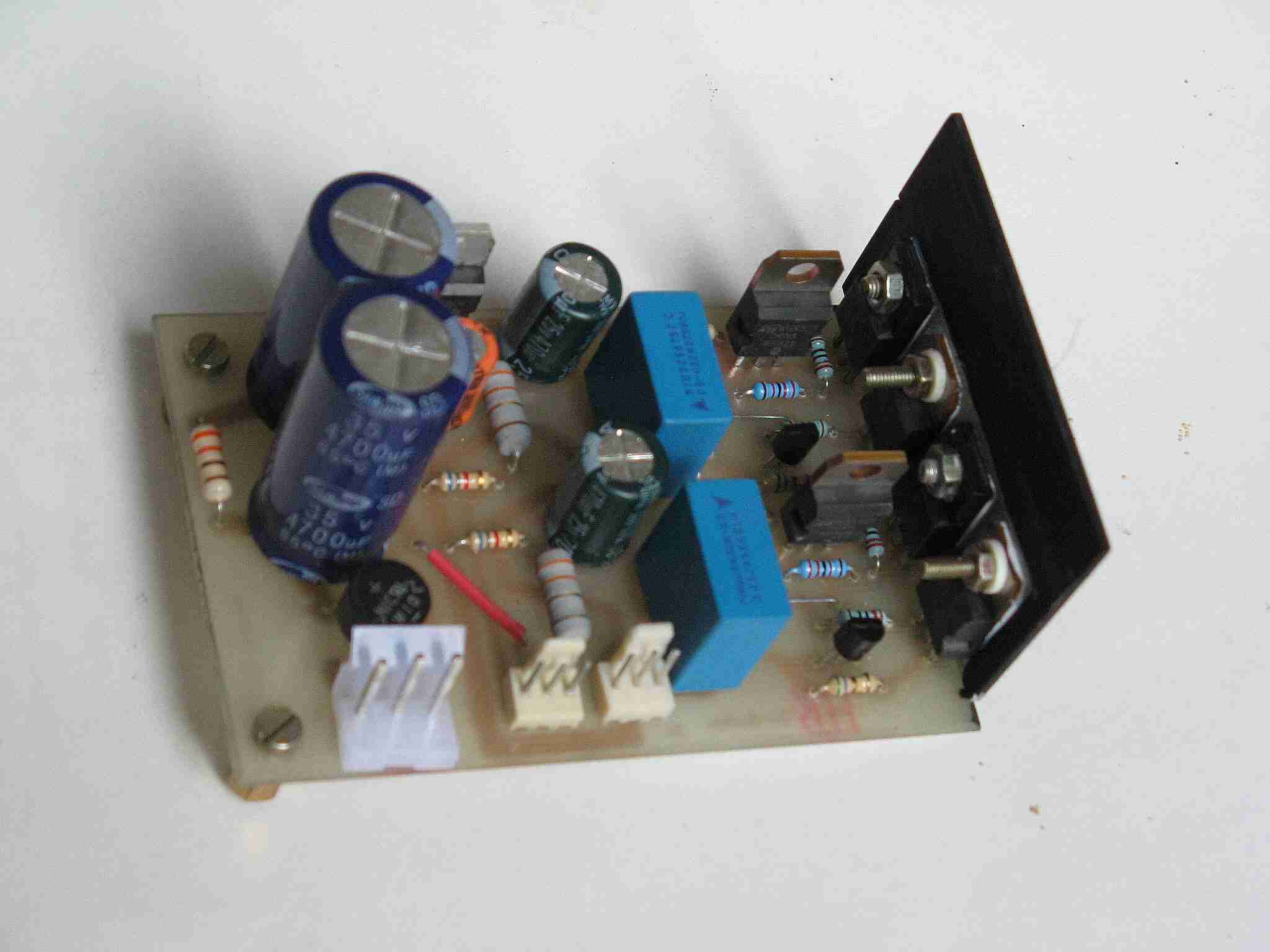

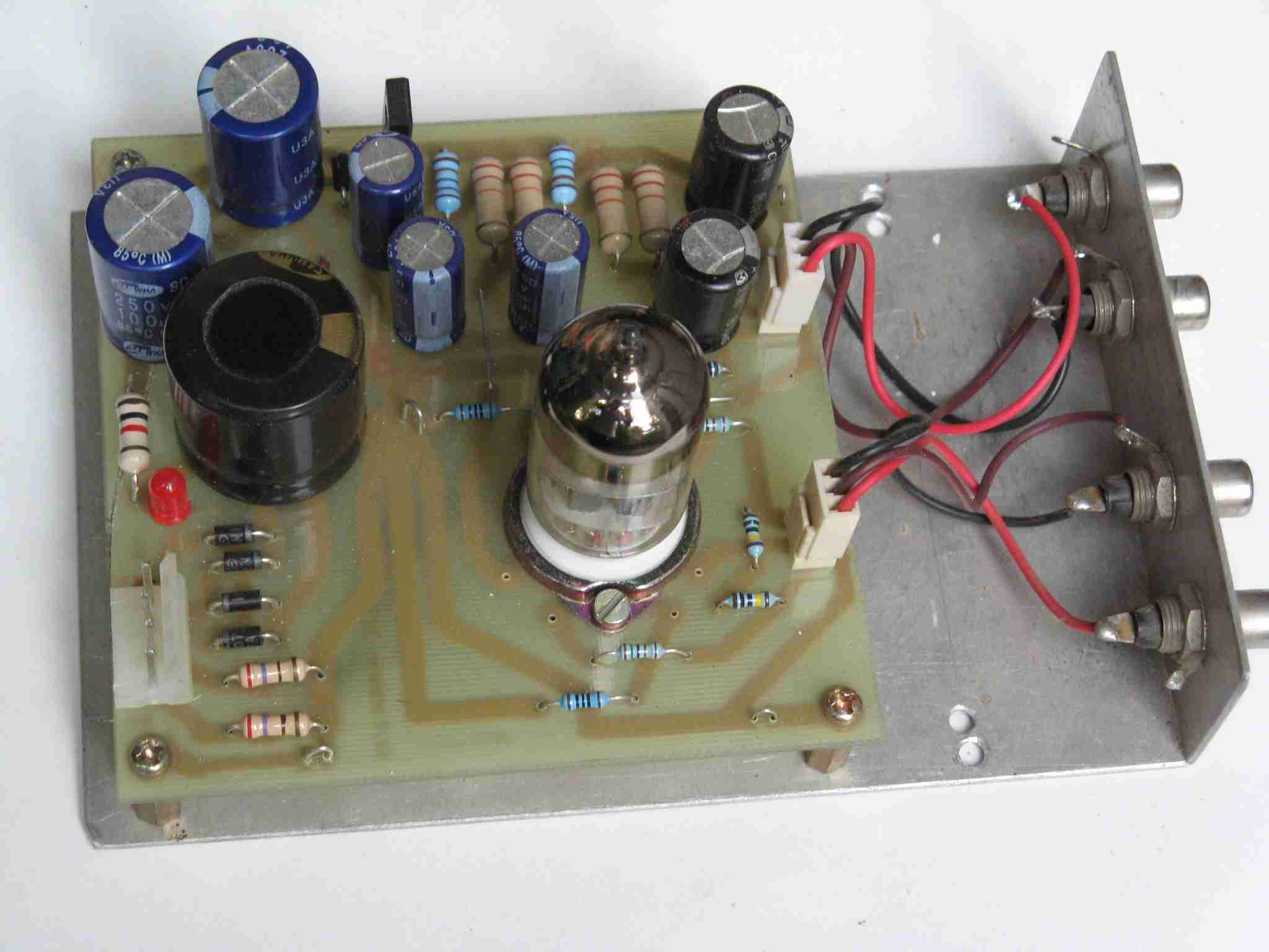

AR4,
Would you like to compare your amp with another scheme where you use the same tube input and use a CFP source follower using a mix of MOSFET and bipolar ? This will run off an 18 V supply and has ( yech!.....) capacitor coupling for the phones. In spite of the cap it does sound good.
I can spare you one pcb as soon as they are ready.
Let me know if you would like one pcb to try it out .
Cheers.
EDIT: OK I'm on a wrong thread. I was searching for hybrid headphones amps. This one is for power amps for speakers and I didn't notice that.
Neverthless the offer still stands !

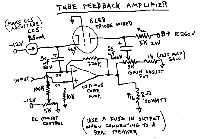

Hope this isn't OffTopic but I have a simple question. Before my PC crashed I had saved a link to a site showing a ChipAmp in a STC-design = SuperTriode Connection (*), where a triode is hooked up as a feedback element for the solid state amplifier. The info (and schematic) is lost, but has anyone seen a design resembling what I have described?
(*) http://www2u.biglobe.ne.jp/~hu_amp/amput3e.htm
Above schematic from : http://www.diyaudio.com/forums/tubes-valves/20686-se-sound-p-p-amplifier.html
R.C.

Sorry for being slightly OT. But here are some pictures wrt my post.
