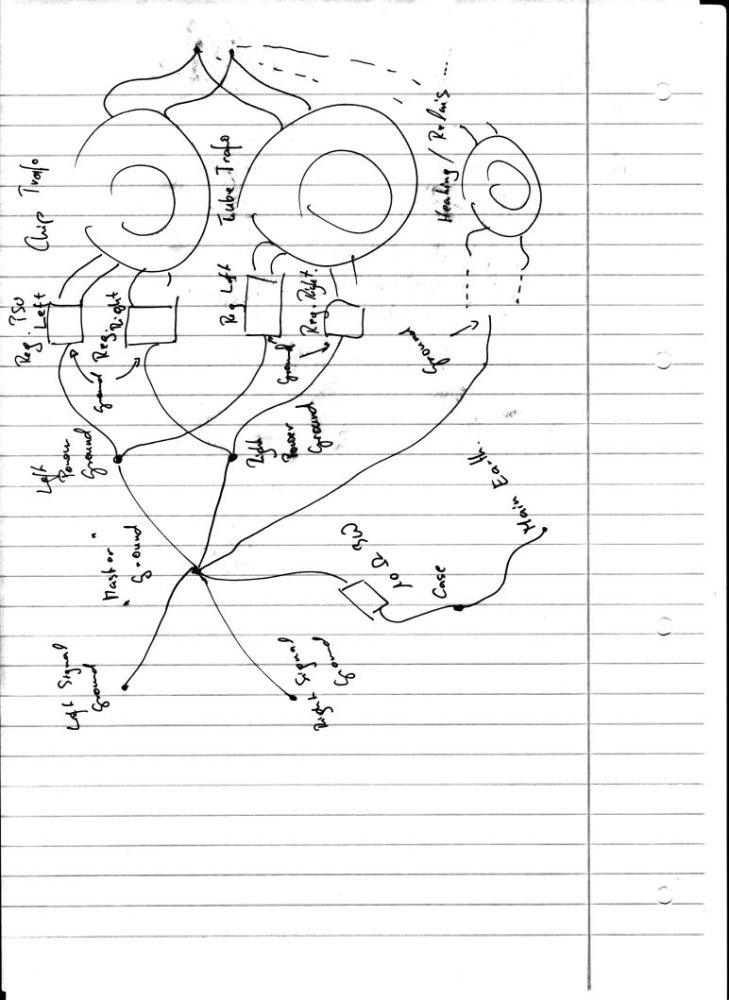

As i have slowly aquired all the parts and the idea for the case comes more clear I thought about grounding the jlti.
I will use 3 Transformers, one for the Chips (2x regulated PSU), one for the Tubes (maybe 1x or 2x regulated) and one for the Heating and the rest of the stuff. I drew a picture of how I would do the grounding. Maybe somebody can take a look and give me a go.
Thanks in advance, Shanavar
My neck is a bit sore and my eyes not so good at this time of night so I will just offer how I did it . 😉
