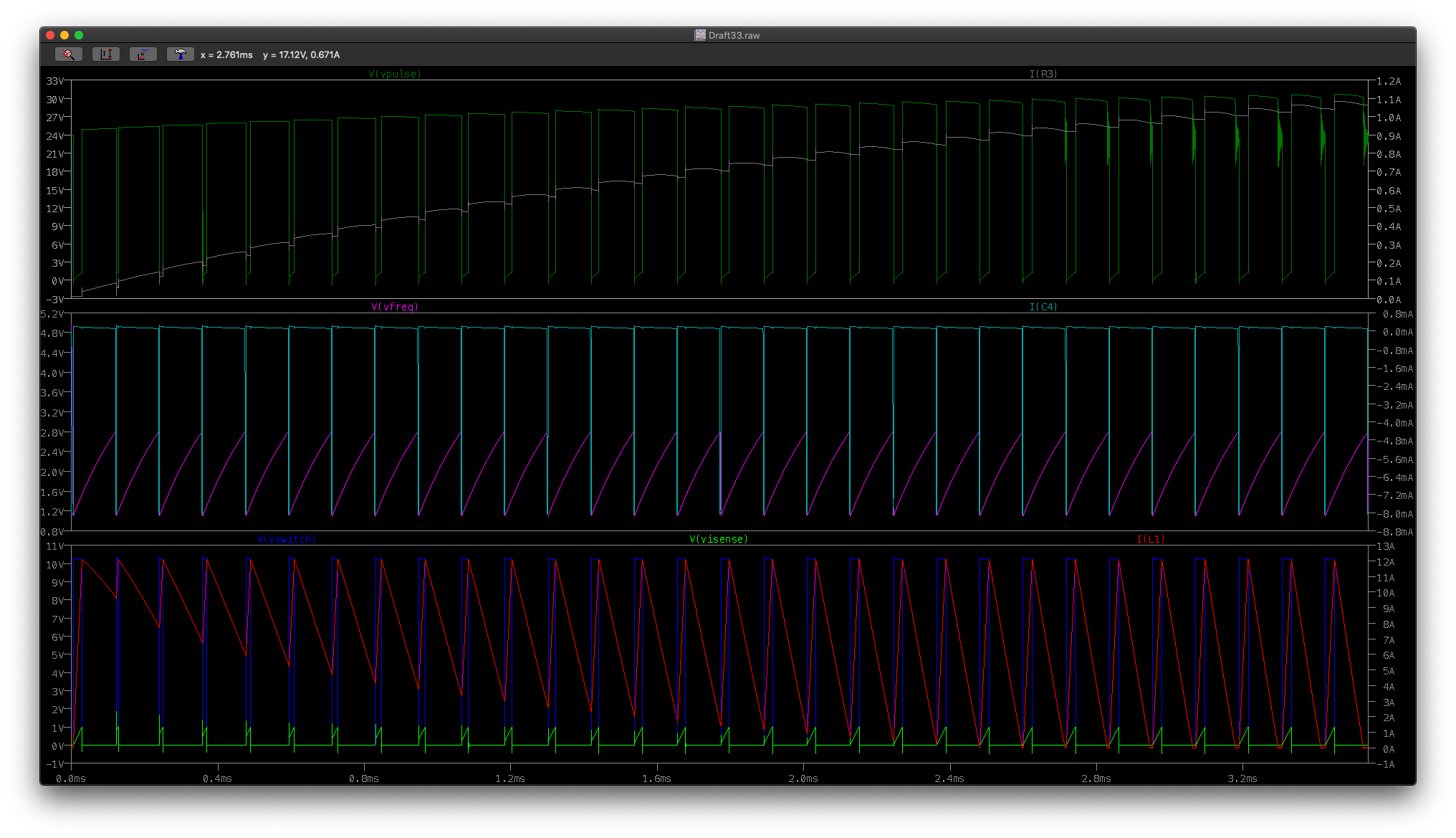

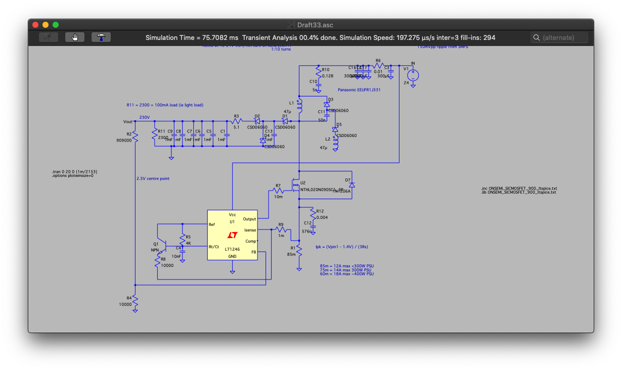

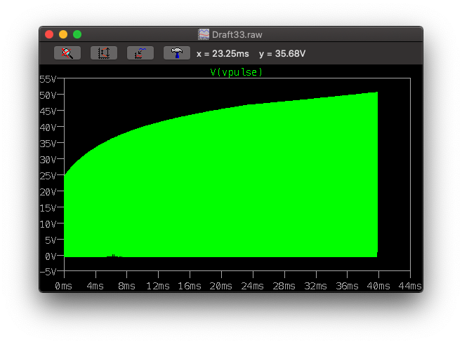

I've not finished with the design for the boost converter just yet - the proposed components aren't being modelled, I'll invest more time pulling this together once I have proved 'in-theory' the concept could work. (In-practice could be something else)
I've put the values of the main inductor from a coil craft that would fit the bill. I still have some noise reduction to do and D3 (playing with varactors) will be replaced by a safety should the high voltage diodes fail and conduct causing the rail to go HV. I've also got some tuning in terms of capacitance - that's simply a brute force approach but I wanted to test the boost with a large cap load.
I've got the supply set to provide 230V and current limiting to about 6A or there abouts simply to attempt to target 300W. In theory the RC oscillator control could be more active but it makes it easier to understand what is going on without it.
Currently running a full load test (see if the system sags) and then I'll run a 0V signal test to see if the system starts blanking pulses.

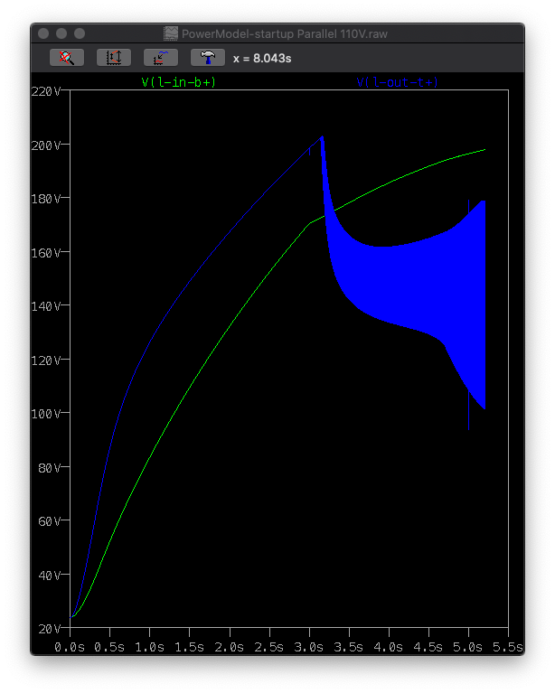

So this is looking good, this is with a 3.16V input on both channels (again one 10KHz, one 30Hz):

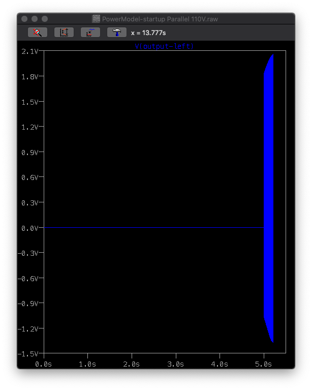

At the tube - front (green - cathode connected) and output (blue). Could do with dropping the B+ a little more but that's good.
at the 24V PSU input - this is looking very good, doesn't seem to have any problem supporting the current required.
Output Tube looking ok (still needs some tuning but it's good enough for this step)
The output looks good so far.
So in short this looks good. Next step is to lets this work through for a few seconds to see the noise level, then the next model will be zero input signal to see if the power draw drops too low and final noise model.

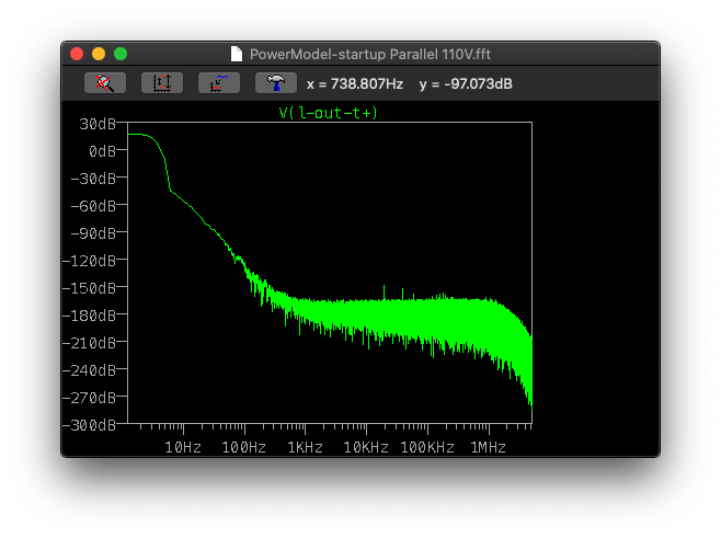

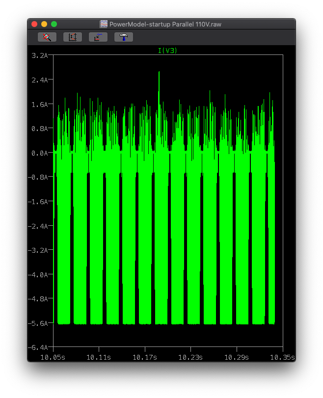

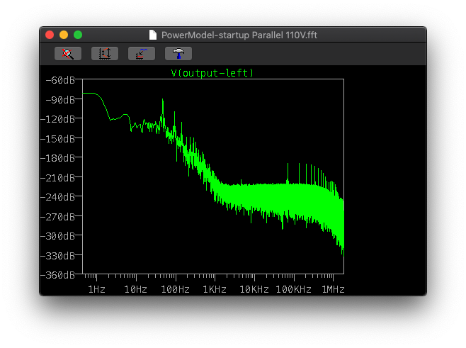

0V input signal to see how the power supply would behave. They say a picture is worth 1000 words:

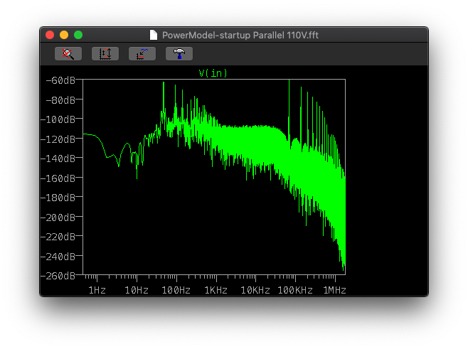

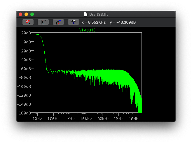

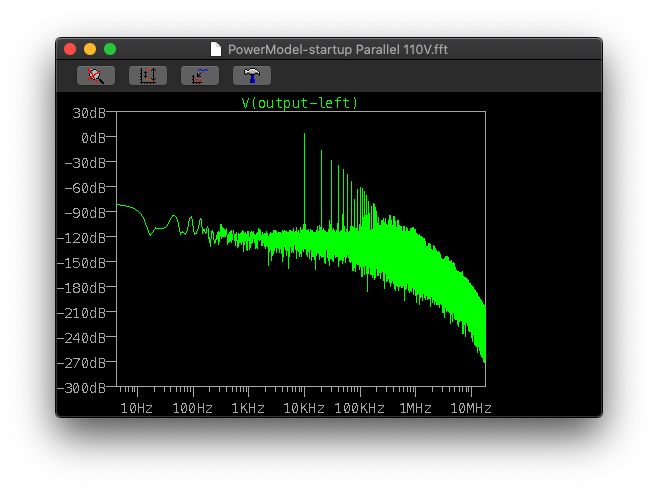

Output FFT 8-10secs on the simulation, so after the startup and in normal operation - note the low end noise <100Hz:
There's only one place that noise can come from in the system, so just FFTing the voltage source - switching noise.

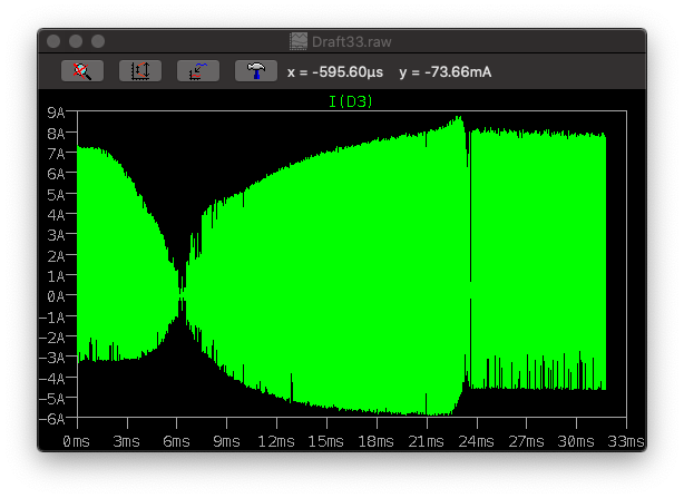

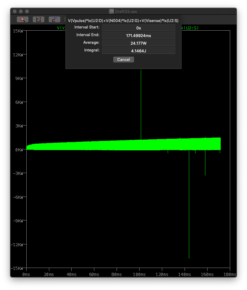

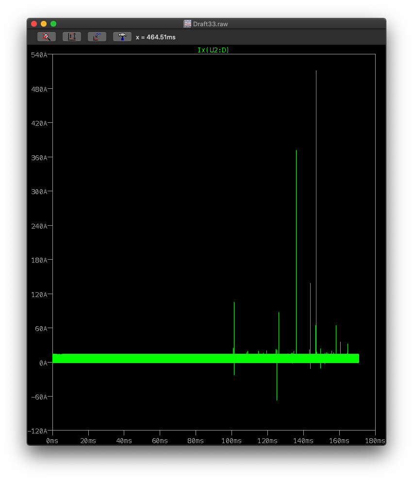

Looking at the current at this point - there's the source, blanking by the PWM chip to reduce the power:
Hmm I need to look at the options of varying the oscillator to reduce power before the chip has to resort to blanking.

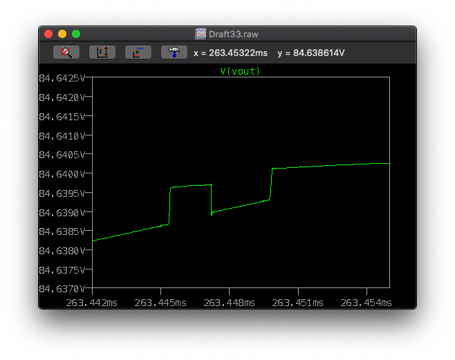

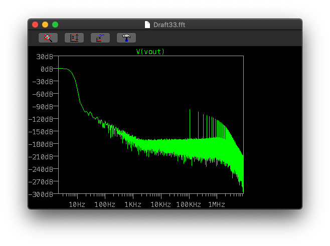

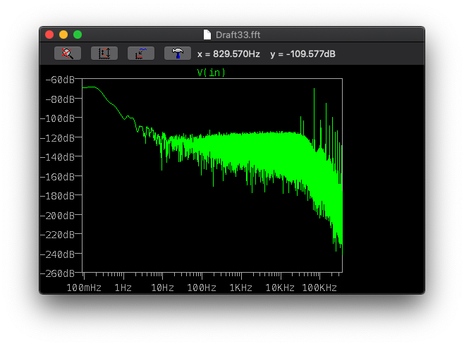

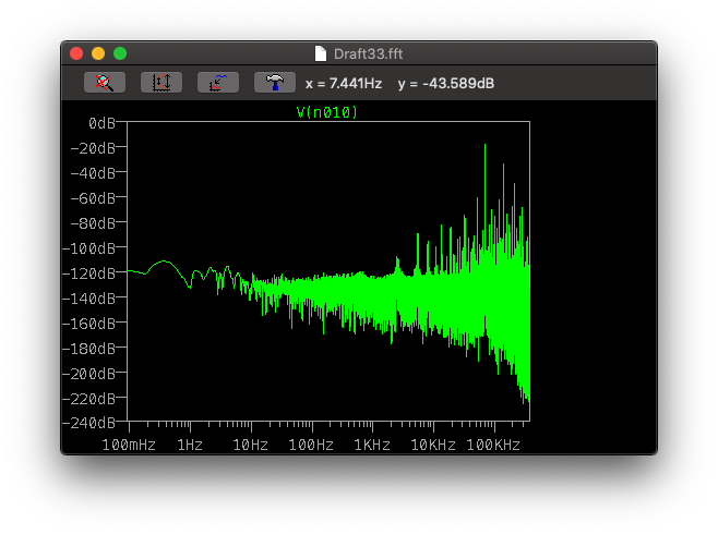

Initial run with feedback-based slope compensation.
Above is the is the oscillator, so it looks like I'm still getting sub-harmonics below 20KHz so I'll work through the maths later and see what I can do to reduce these.
The after that it's what can be done to supplement that if the voltage increases, how can we make the system less efficient without adding sub-harmonics to prevent the system from blanking and creating even more audible noise.

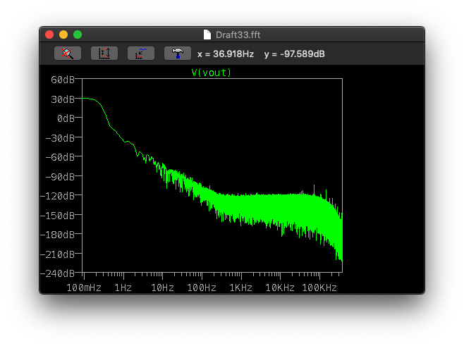

The filtered output seems to be cleaner though. This is full sim using just a non-loaded output - including the 6mF 1st order, so this really is the worse case for slow switching:

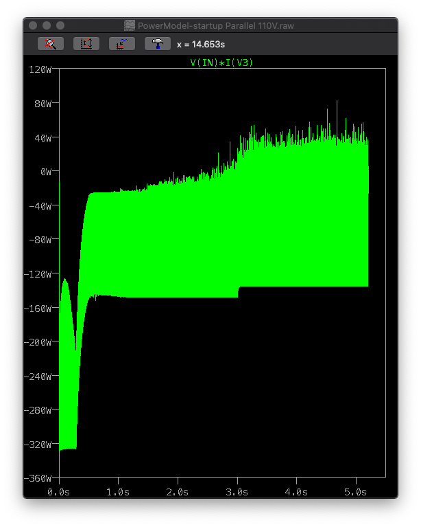

What the 24V psu would see:
As the LT1246 is a 100% duty capable at 1MHz it needs slope compensation and benefits from the capacitance to prevent oscillation and reduce sub-harmonics that become a problem with duty cycles over 50%.
I found a second interesting guide on this: https://www.ti.com/lit/an/slua837/slua837.pdf

So there are 56 equations in this design sequence.. but I need coffee and breakfast.
So I switched to a NTHL060N090SC1, a 900V 46A 60mOhm mosfet.
https://www.mouser.co.uk/datasheet/2/308/NTHL060N090SC1_D-1698980.pdf
The model is encrypted, but it seems considerably more finicky about the setup. It's also especially sensitive to transient noise causing the model to stop with a time step too small if steps aren't taken to reduce the interference. R11 is a simple load.
So changes:
* switch Cinput to 300uF low esr 63V Panasonic caps in parallel, same as C3. They're cheap but also very good esr for the size. This area should only have 24V but I'll put a 25V diode so if the system has a safety on shutdown (the inductor energy has to to somewhere).
* snubber on the input R10+C10 to help reduce noise cycling back to the Vcc pin
* non-dispersant resonator snubber on L1 - this recycles the spikes back by storing in C11 rather than just shunting to ground. This is sub-optimal at the moment as I'm using a second L1 essentially to make a mirror.
* U2 is the new mosfet - this is a fast fet, so caused me an absolute nightmare initially. You'll note the small gate resistor and D7.
* tail snubber R12+C12 to take the switch spike off the Isense.
* Q1+R8+R9 are a current slope compensation. This is mandatory as we can run 100% duty cycle on this chip and shapes the size of the pulse dynamically. If more power is needed then then you'll see a flat topped square wave, when the demand is less this becomes a slope from bottom to top as a sawtooth.
This dynamic makes filtering a little hard when it decides to reduce the output to a minimal amount- I think that's what may be causing the instability.
* timing R5+C4 is setup for about 40Khz at the moment, you can ramp this up and the mosfet will take it but be prepared to go through a re-specify the current filters in place.
The model is current have a longer run and I can already see some DefCon 1 appearing. So it's not entirely stable at the moment.
This is the only noise I'm getting out of it at the moment:
I found this On Semi document going over design aspects and different SMPS topologies. Worth a look if you're interested: https://www.onsemi.com/pub/Collateral/SMPSRM-D.PDF
In short - one aspect of that document is that it defines this PSU almost on the bounds of boost and half-bridge topologies. Many as the Boost topology needs at least 2xVout support from the mosfet and components. Whereas the Half-bridge and later full bridge only need Vin. The down side is that they have a transformer and bridge rectifier in the middle but can deliver more power.

So the new mosfet is exceptionally quick, so quick that it will pick up ringing noise returning through the Vcc supply and act on it as it comes out of the output drive for the mosfet!
So I'm now running to 630KHz and it seems stable, I won't know until it passes the full run..
So it's extremely important to implement ringing control - such as a 50mOhm+21n RC snubber to damp the initial ringing spike (switch off capacitance 25A spike at 34MHz was enough).

So after playing a little.. I've figured out that the mosfet is bounding on the inrush current - is short 1A 18V gate drive causes it some problems, so I now have two resistors in a divider to drop the voltage to 8-9V this means that current switch isn't as harsh and the system is (within reason) behaving itself.
It's running at about 250KHz and it's now up to 98V.. although it's blowing a few Defcon 1 messages.. so I suspect there's hell to pay on the current spikes and EMI.
I'll leave it going .. it's just about stable..
If that average is anything to go by, that's not bad..

Timing graph for those interested.
Top pane - the voltage between the inductor and mosfet and diode. grey the output current from the LPF resistor in the output.
Middle the RC oscillator, cap and pin showing sawtooth.
Bottom - the inductor, mosfet gate and the Isense.
So back to the 47uH, I've tried nH too, but interesting here - as we go from CCM to DCM mode where the inductor bottom L1 is grounding out the current to 0mA - we start seeing a load of harmonics being generated in the green voltage between it and the switch (top green).
So if we can keep in CCM mode, the amount of harmonics should be less and we should have less noise.
So what I'm aiming for is a ccm with about a 5A-pp at the inductor within the 10A without either topping out or grounding out.
The Rsense provides max current but we need to shape the on waveform to manage the minimum drop. That way it should remain stable.
