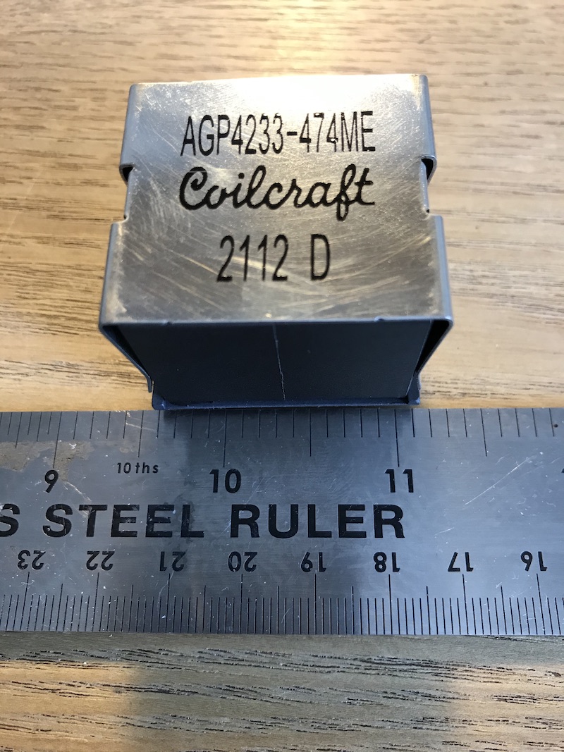

1. The booster maths ties Ipeak * frequency * L = C * duty cycle
2. The inductor maths 1/Ltotal =1/L1 +1/L2 + ... for inductors in parallel. (ie Ltotal = L1*L2/(L1+L2) )
The previous PCV2 inductors coped with high current, providing 560uH each with little saturation impact, the down side is they have zero EMI shielding and act as BBC Crystal Palace radio mast transmitters.
The switch to shielded AGP-series inductors sees a lower 460uH and 30% inductance drop at about 4A, so although they can take 12A each their inductance would drop considerably at that point.
Doing some quick booster maths - the previous setup
75kHz, 24Vin, 260Vout, 600mA and 0.1Vripple gives us a 90% duty cycle, with 23uH minimum with a requirement of 13Apeak and a minimum of 80uF Cout. The diode seeing a good 13+Amps. I Use 260Vout to give some room for regulators but so far we've been seting this to 230V for all the sims..
The PCV2 inductors max was 7Arms. Hence two in parallel may drop the inductance to 290uH total, the current handling is 14A. Hence two were chosen originally.
The AGP sees both lower 'usable' average current and lower inductance - 470uH which in parallel is 235uH, so either peak current has to increase (nope!) or frequency (easier).
If we can target a max working current of 2x4=8A (with 24A peaks acceptable) then we can use two AGPs. The inductance still exceeds the minimum required (235uH vs 80).
So pushing up the frequency to 95kHz with a 90.7% duty cycle, we see the minimum inductance required (L) drop to 17uH for 13A. With our relationship from point 1 at the start.. we can that for Ipeak * L *C = C, we don't worry about C, so if we want to drop Ipeak we need to increase L. So if we have 235uH vs 17uH minimum, we're 10x that so we can reduce the current. 1.3A in an ideal world so it's likely to be more.. in reality that's going to be higher but the simulation shows it's very happy running at 4A per inductor - 2x is 8A. So we're dropping only a small amount of peak.
Now plugging the frequency back into the calculations.. we see we only need about 60uF minimum Cout for 0.1V ripple.. So happy if that's 100uF.
The AGP series plots show it's very happy up to a good 300kHz before it slowly starts increasing, so it's stable at 95kHz.
So the simulation for 95kHz and a max of 8A on the current sense limiting sees the system apply push the desired 230V 600mA giving the 3080 regulator space for 200V 1mVripple I want.
For giggles I already know that given the duty cycle, freq that the system is probably balanced for the choice of components and current limits. When you look at the maths, adding another inductor won't work, adding more frequency helps a little but in the end because duty cycle is Vin/Vout pushing 400V from 24V means a 94% duty cycle regardless of frequency with 20A.. >50% duty cycle is a danger zone from a stability perspective and we're already implementing slow compensation. At this point, going high in voltage/current from 24V is probably worth switching from a simple Booster to a different topology. This aligns with the industry norms, where we see switching to half-bridge with active secondary rectification etc.
It's possible to switch to 48V for 400V, the duty cycle naturally drops to 88%, and additional work on the IC side so a boost could work. All depends on the inductor voltage and insulation ratings.

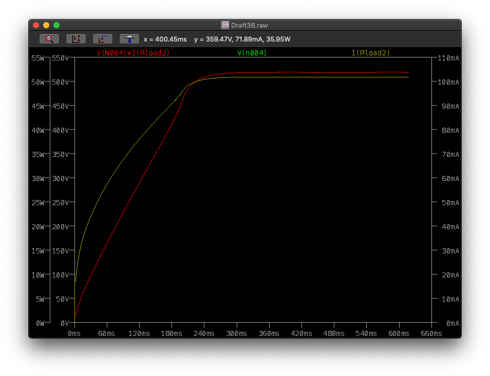

So a cheeky little test whilst I'm working late.
Switching to 48V input, with the same parallel inductors and max 90% DC. With he same 370ohm load.
This is running about 2A RMS per inductor. 4A at 48V total ~192W.... and 155W output.
Just running a test into a 5000 ohm load, I'm interested in seeing the maximum voltage this will do with reduced current...
48V to 500V 100mA into 5Kohm.. 85W in and 50W out 😀 That's with the same current limiting in place.
Now I'm not sure I want 500V anywhere near the inductors! 😱 I'll certainly be soldering cables rather than using screw fits!
Coildcraft give no statement on the inductor maximum voltage.. I suspect that it would arc over internally.
So after more simulations, I'm certainly considering moving to 48V.
