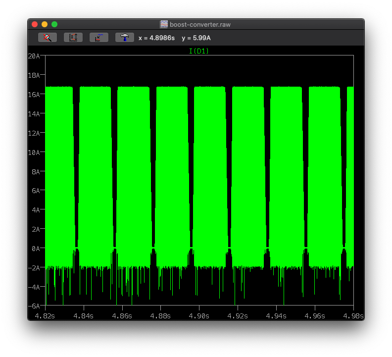

Just looking at diodes. The diode in the model is a MUR460, a 600V 4A If, 1.8A Irr device, however they don't give the Qrr value, the switching time is 75nS. (data sheet: datasheet). The assumption here is more current for longer = higher power.
This may be a better option: datasheet it's a 600V 3A forward but a 1.2A Irr, Qrr=17.5nC and the recovery time is around 9nS. It copes with 32W and can be heatsink mounted.
So 0.5*1.75e-8*200^2 = 0.00035 joules per switching event.
78000*0.00035 = 27.3W of reverse power.

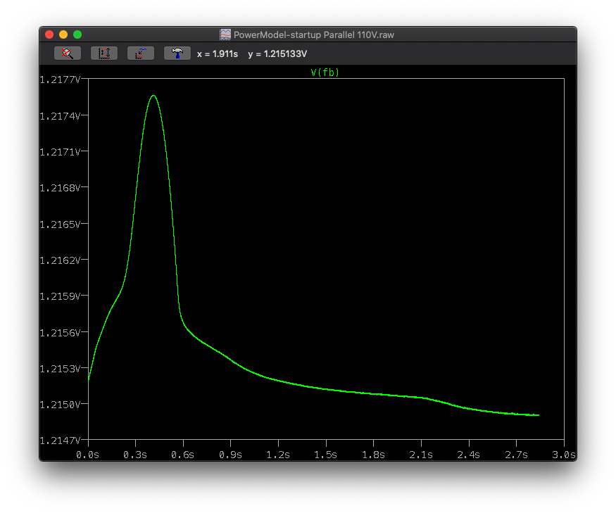

Well the main comparator compares the FB with 1.22V. Using 6mF of capacitance helps this point about small signals " The feedback loop requires the output pole frequency to remain below 200Hz" as the output is subject to a 0.5Hz LPF which gives a -35dB at 200Hz.

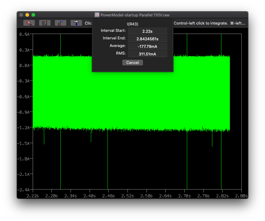

The average here is 177mA which may be causing an issue with the 190mA minimum.. RMS is 310mA which is less than I'd expect but the amp is running 447mA not full transient 3.16V input.

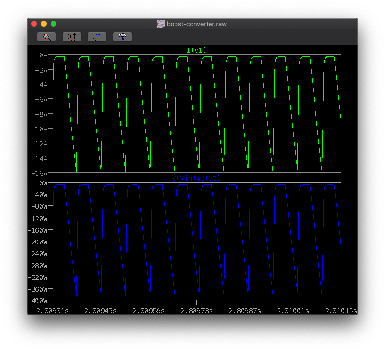

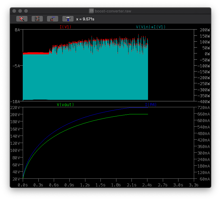

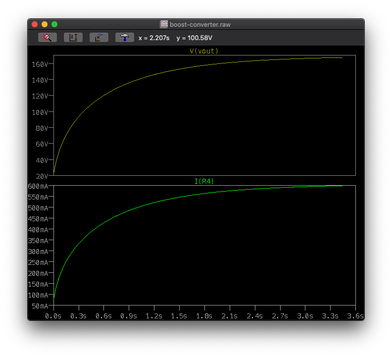

I was doing some final checks and decided to look at the a couple of calculations for the transformer.
In short the transformer can't supply enough current in the pulse periods to support the power levels.
I couldn't put my finger on it until that point.
The transformer has a maximum power output with that chip of 136W which works out at 654mA at 200V, however at 70% efficiency that's actually 95W then when you start looking at the uH needed, that's where it breaks down.
The raw maths ignoring the switching periods mean that it would be absorbing 25A at 24V or 600W but only getting a small amount out. So when you look at the rates and the clock pulse lengths, that when it becomes obvious that the clock pulse with 24V can't cause enough current thus you end up not getting power to the output.
C'est la vie.. now back to the drawing board again..

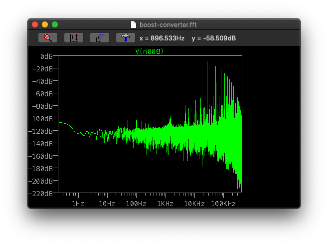

Compared to the LT3751, or at least the LTspice model, it seems noisy as hell - with careful noise control needed pretty much everywhere.

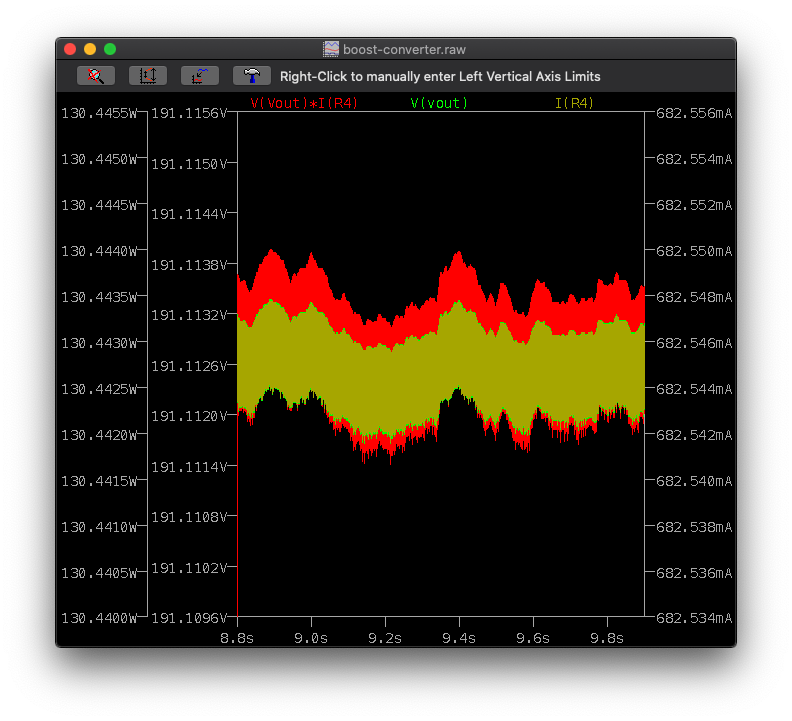

Here's a snapshot of the B+:

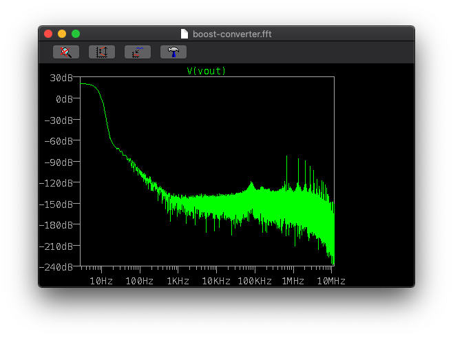

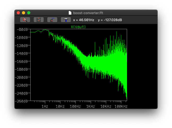

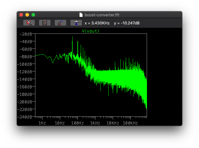

FFT across the whole model 400ms period.
It's looking promising, this was simply the first run to try the idea so with some tuning this may be an option.

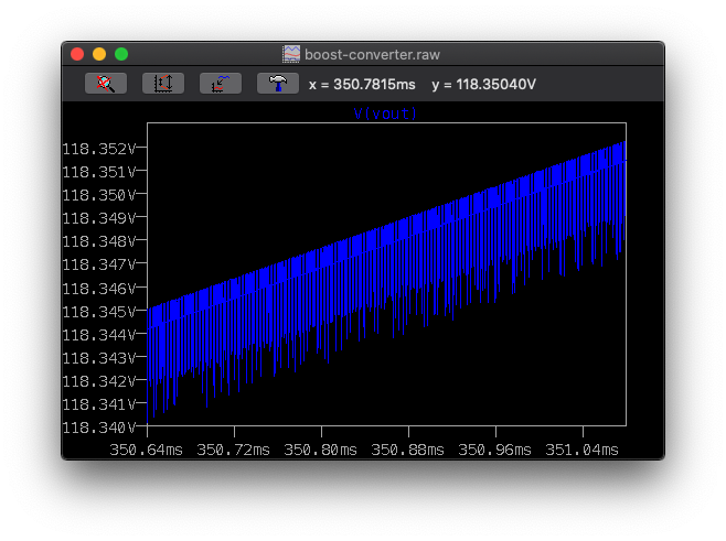

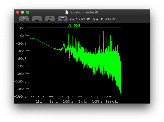

Hmm..
I noted an interesting cycle occurring, given it's now running at the 200V, almost like an idle rev-stop-rev-stop-.. when you look at the current across the diode.
Looking at the output - this is obviously causing a slow oscillation, when you zoom in.. sure enough:
Looking at the oscillator RC.. hmm not here (although I can see a trace)..
Looking at the gate output.. that's the source of the 50Hz noise..
I suspect that the FB is causing the system duty cycle, so the system keeps the same frequency set by the RC but then duty cycles by cutting cycles out causing the revving idle.
This could be fixed - adjust the oscilator to produce less power per oscillation (ie increase the frequency which would make for smaller transfers), or reduce the current which would mean more on time to keep it from idling but that would be difficult to perform using a static system on a dynamic problem.
I'd removed the dynamic slope compensation to keep to simple to get the thing working - that could help, adjusting the slope based on current could work...

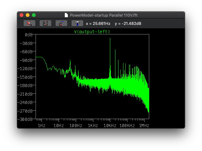

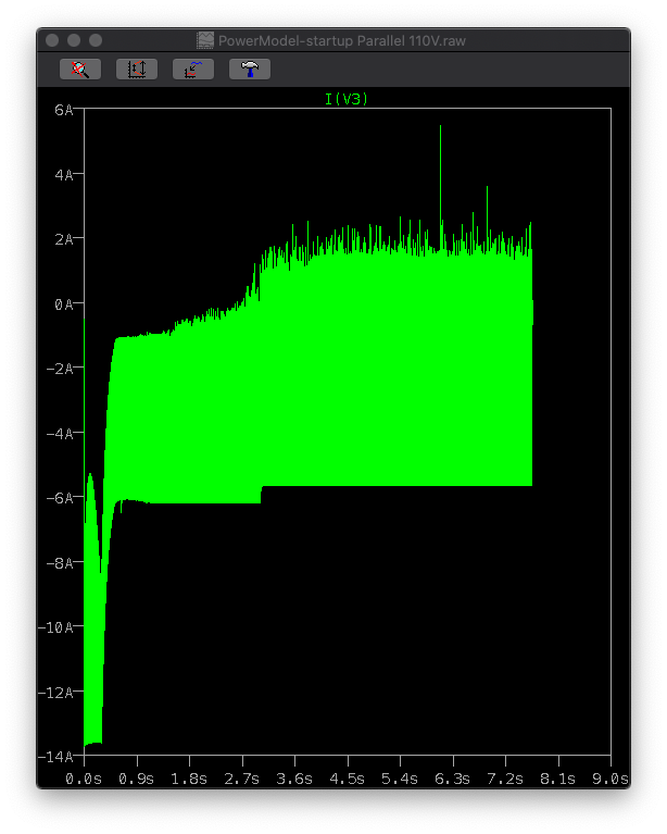

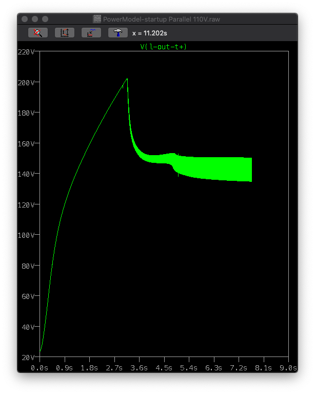

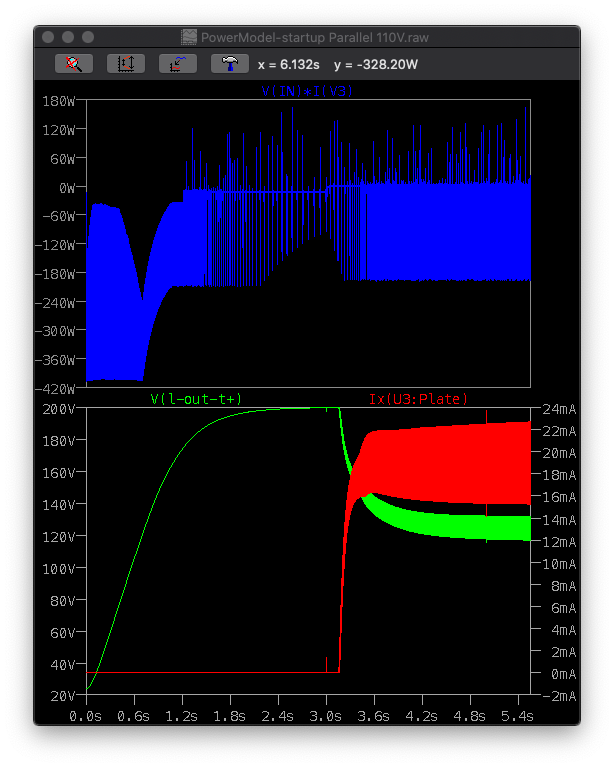

So this is the full amp model, 3 seconds in the negative bias is switched off, 5 seconds the mute is disabled.
The amp needs tuning but that's irrelevant at the moment - the B+ needs boost ing 20V to get the right 150V at the tubes. What I was interested in is the behaviour of the power supply input (blue) that would be connected to the 450W 24V MSP supply.
So there's the initial capacitor charge before 3 seconds. As the voltage gets close to 190V, the system starts blanking pulses to reduce power. Then at 3 seconds then all 12 triodes in the system are released from the 0V grid, 24V cathode (ie -24V grid) clamp and the system starts conducting. One ecc99 (red) shows this - this should run at 25mA ±30mA max signal once the B+ is corrected (due to additional filtering).
You can see the switch back to supplying power again as. The rough average of power draw at this point is 38W - ideally this should be about 45-50W to not drop below 10% power limit. One option is to simply reduce the PSU to a 300W and then alter the boost converter, limit the max current draw (sense resistor) and then have it always be above the 30W minimum it would be with that power supply.

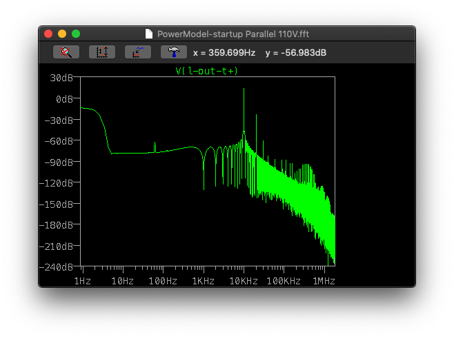

Just on the portion around the 5 second mark, the FFT shows a strong 10KHz this is the input 10KHz sine wave being amplified. I am concerned about the ~63Hz spike that could be from cycle skipping (the other channel is running a 30Hz input).
