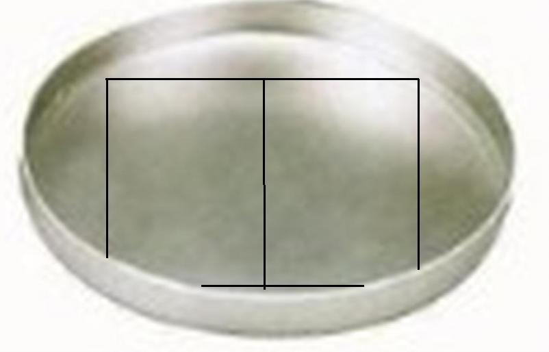

Tekko,Those arent heatsinks!! You need something atleast 10x larger than that.
aw..... then i'm going to have headache..... here those heatsink are rare things... and its expensive to purchase thodr, can give me rough dimension ? (width x length x height)
10 by 10 centimeters, squared aluminium blade, one to each power
transistor will be good enough.... you can bend it and make it U shape, or L shape.... well, this up to you.

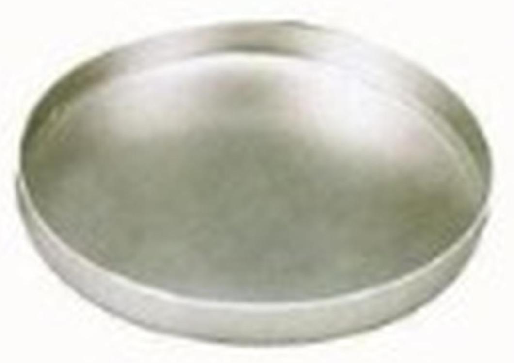

Aluminium from old food pots may help... that aluminium rounded thing we use to make pizza.... that aluminium can be good ..just cut it and fold it the way you want.

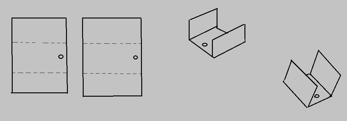

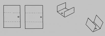

Diy heatsinks
In three steps you can make yours.
-1 find a pizza pot...old or new.
-2 trace lines and cut it the way shown.
-3 bend it as shown i image three.
ready to go!
Carlos
ready to go!
Carlos

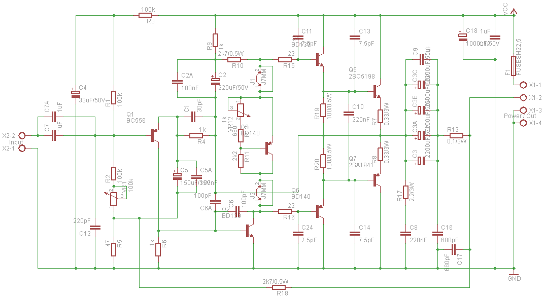

wahaha, uncle, I'm planning to reconstruction the amplifier (well.... alot of problem) so there is some question about the circuitry.
What is the usage of C16 and C17, which is 680pF ? It seems serve no purpose.

Carlos,
What is the purpose of R18, that connects the output from the speaker terminal (i.e. after the dc blocking condensor) to the bottom of the feedback shunt capacitor ? - is this to alleviate turn-on and turn-off transients whilst the output and feedback condenser are charging up ?
Why is the bottom of the feedback shunt capacitor connected to the input -?
It is a feedback, but i cannot remember
This changes damping, is a voltage divider considering speaker and that resistor, but i cannot remember... three year is to much time to my memory.
I knew..but i do not remember the reason why.
I hope someone remember.
Have you readed the entire thread?.... i do think i have explained that..before it was deleted from my mind.
Try to simulate it to discover the effect,... with and without it..use complex load as a speaker instead of a resistor as speaker...i have no more simulator files of this amplifier.

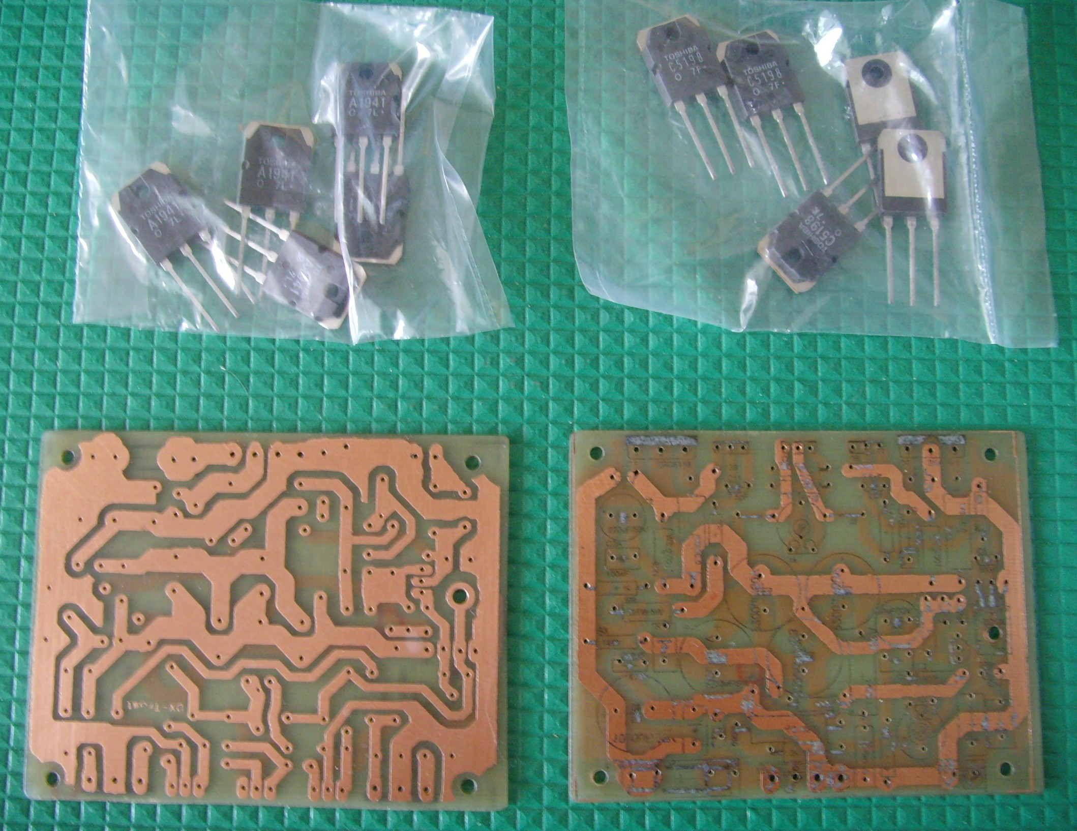

Thank you very much for comments and encouragements.
My build is progressing rather slowly (as dyi projects should do) and I am still hunting for parts.
But half of the parts are already in, the transistors will be next after I have figured out how to match them without a hfe-meter. I wonder if a simple setup like this:
Successfully choose complementary bipolar transistors | EDN
or this:
Transistor matching
will do the trick?
About the PCB's, they are made using the toner transfer method. I did a lot of experimentation and had a hard time finding the right paper type. So far I had the best luck with thin glossy advertising paper. Double sided PCB's are challenging since the alignment is difficult and the whole arrangement moves and changes shape during the ironing. I ruined one board and must have re-ironed the patterns at least fifteen times before getting it right!
I choose to make the PCB's double sided as an exercise and also to get better current flows to the output transistors. I made a few mistakes in the layout, mostly caused my designing the boards before having the actual parts at hand. Good to know until next time...
Next step is to design the power supply board but that should be relatively easy.
More to come, I will keep you informed as the build progresses.....🙂
