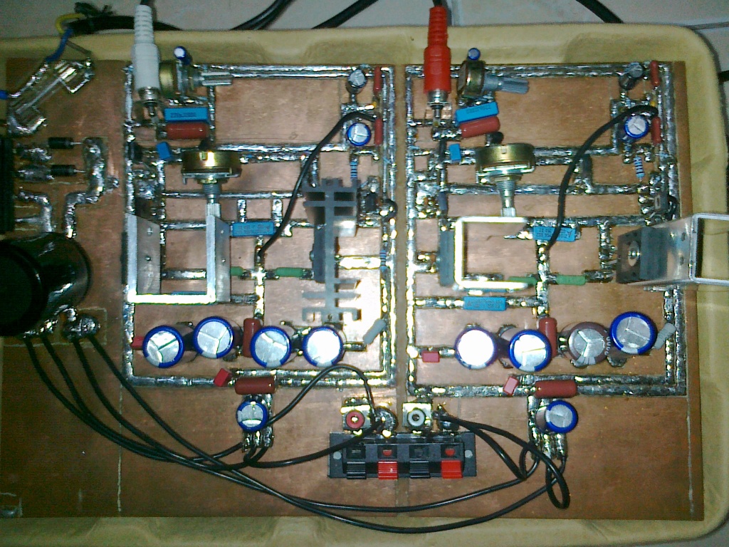

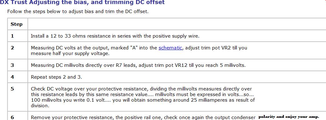

The instruction in the website, is meant for DX Amplifier, not for DX Trust ( i really go and compare all the post you wrote about gain (sensitivity adjustment), at least the numbering is wrong.
About the bias, i remember it written is about 25 millivolt.
about the low heat produce, i once try to booming (to try the speaker's limit), but the transistor able to go very high without heating (not over 35 celsius), i will try to measure the voltage of the output transistor at night (need to go or classes).
About the heatsink, if i put different type on those 4output (2 channel), it won't effect the performance ? (at least not too much) or it has to be same to share heat ?
Preferably both outputs for one channel on the same heatsink, for this low power amp, a large pc cpu cooler per channel should work.
If the outputs stay cool on idle with no heatsink what so ever, you cant have much if any bias current going through.
My amplifiers idling around 50mA does get to around 35-40deg C and around 50-60deg C when played loud.

lol.... mine really very cool.... gonna measure the parameter.... ohh yeah, your transistor at tthose temperature with or without heatsink ?
Any idea why the output transistor is so cool ? (at least not hot)

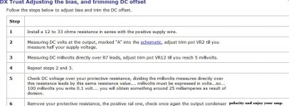

about the idle current, it should be measure directly in series with power supply, or in series with a protective resistor (33ohm i my case), which in series with power supply.
(my main concern is with or without 33ohm resistor, which doesn't include in amplifier circuit)

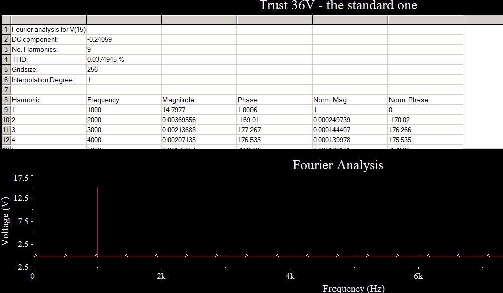

This one is a very nice amplifier.... sonics is delicious
Here you have some comments..... fourier was wrong in the video attached..and this explains why distortion was different than our spectationseo..i have used wrong output....image attached show the real thing about harmonics:

Measurement is in series with your supply...cut your positive wire using scissor or another tool...insert multimeter adjusted to current..then switch power on and measure.... current is 25 miliamperes plus 20 percent or less 20 percent.

Dear uncle carlos,
I had already adjust the bias and DC offset, to roughly 20-25mA.
My amp's output started to warm as the idle mode (i'm adjusting bias), the temperature is same as previously when i play music. It was my bias is too low, make my amp produce less heat, even booming style. (and i electrocute myself once just now, hahaha)
Just to ask, if i were to leave my amplifier like previous state ( low idle current, low heat produce even booming, transistor never get hot (40celsius above)), what could be difference or advantage after i made it were intend to be ? (25mA idle current, transistor get warm only *idle mode*)
I also have a buzzing sound when the input were blank(not connected, idle), happen both before and after the bias. But even i'm connected to my input and no music is played, the amp doesn't produce buzz

Reducing bias you may have one or more transistors in the conduction threshold.... this means it can produce noises during transition... in the crossover region...this may put some "dirty" spikes together music when volume is very low...some guys likes...they say this made sound crispy.
Ahahhaahahahh!😉
Increasing bias you may have a little better results...less distortion...more linearity.... but you may have heat...and this will change transistor parameters a lot.... efficiency will be reduced..supply voltage will drop more in stand by mode and in operation...this will reduce your output voltage swing...may compress a little bit your audio...may reduce some high frequency low level treble tones.
This is something to try, to make experiences...experimentation, research and tests....you can do it and inform us...i do not remember if i did it or not..i do not remember my dinner last night..... or if i had a dinner last night..... i might be tested...usually i do these things..but was a billion year ago (considering my memory problems..one day to me is 100 years for you).

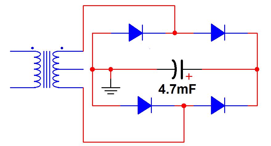

You supply can be modified in order to offer you more voltage
video:
Trust supply example - YouTube
Another way is shown in the attached image....there are several ways.

haha, if i were to make my 2 x 25V into the supply you drawn, what could be the output voltage ? is it roughly 80V ?

Is you 25 Volts Dc or Ac?
25 Vdc will result 50 Vdc, naturally.
But if you are talking about AC,then you may have aprox. 70 Vdc.
Your filter condenser and output condenser will need to have high insulating voltage...80 volts or more....better to use 100 volts..and this is very expensive.
Also i do not know if BD139 will survive.... you will need huge heatsinks...also other issues may appear...amplifier not tested can explode!

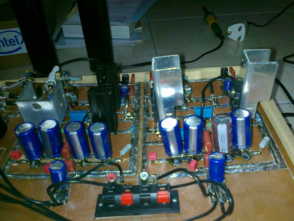

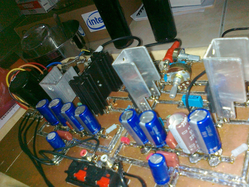

hm.... i already checked the voltage, its around 500mV so no problem now, maybe previously(before adjusting bias) it was too low.also check voltage from base to emitter..it must be from 450 milivolts to 640 milivolts...check all transistors to see if you have something strange on that...be carefull not to make short circuit from base to colector with your multimeter probe tips not to damage transistors.
More updated picture
found ways to lock them with screw 😛
hm..... uncle said before that the heatsink with electrical contact have electricity on them, so i make them not to contact with other component, including each heatsink 😉
Is this ok ? since the heatsink is kinda different 🙄 (haven't tried to turn on them and try, haha)
** also please ignore background items **
