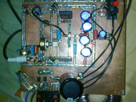

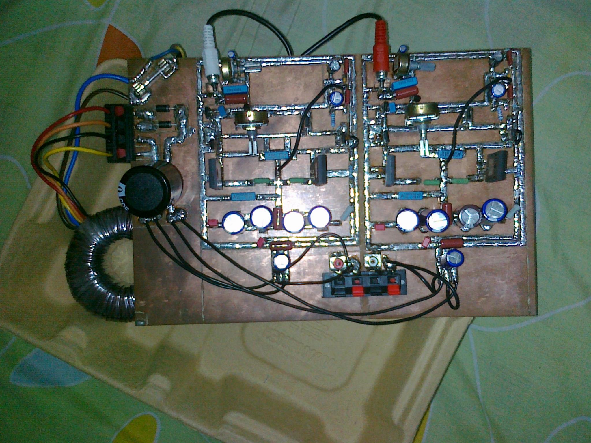

yeah, i done my amplifier, uncle , thanks alot for your help !
(although i only finish one side, and accidentally blown my fuse)
although i miss something before, but i manage to fix it back after few diagnosis ! nice sounds of this amp came out ! going to test it with good excellent weekend X.x
haha, going to complete the another one channel today ! .... the amp is excellent for me ! (better than the one i previously brought. The old speaker even sounds better with this amp, compare to the new modern speaker.

hey uncle ! done both channel !, work and sound nice ! although i haven't adjust the bias and sensitivity X.x (lack of trim-pot) and some output
Going to buy it tmrw and complete your work X.x
My lousy speaker aren't that lousy ! Just that previous amplifier paired with it can't go up power to its level !
Ohh yeah, a occurrence that i dunno how to solve X.x The power supply condenser keep those charges, after i turn of the amplifier Ac supply, the amplifier will still continue playing using contained charges, it dissipate until very low voltage/charges.

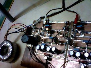

haha, yeah ! I have improve and finish all soldering job ! (left adjusting trim-pot)
I make the output connection of 2, RCA and spring clipper in parallel (use either one at a time only)

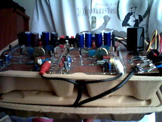

you see the wood fiber packaging is my amplifier shelf, which contain spare fuse and the toroidal transformer at the top layer.
Second layer contain all my cable such as power cord, and input connection. (can take out easily whenever i need to use my amplifier)

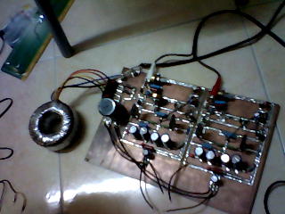

Uncle, i dunno its my mistake or circuit's properties, the amp will produce a small static noice when idle (cannot be heard at the range of 0.5m), and a large buzz when the input is leaved open (no connection).
Can you help me to point out what could be the possible error ?

But my speaker do not vary the volume when i turn the potentiometer..... I measured the pot with multimeter beforehand, that is works as intended....
Usually this is due to grounding errors... missed ground... well..human mistakes
Also too much high sensitivity (gain resistance too much low..wrong value there).... also supply big mistakes...also potentiometer not shielded, not grounded...well.... i cannot say exactly..... uncle have not developed these super powers to travel to your place, to hold your board in my hands, to inspect and check it.
Go ahead...now it is hard work to find where is the missing ground...the wrong part, the missed connection.

And about the adjust bias, it need reading of 5 millivolt, but my multimeter's smallest range was 0.1V ......... any idea to do adjustment ?
Also my output transistor was almost no heat produced can be detected.... (my hand can't feel different between air and transistor, just doesn't felt coldness of those during touching metal) even i don't install heatsink... (just trying😛)
End up only my transformer getting warm (not hot...note that my toroidal transformer have no any mounting nor enclosure)

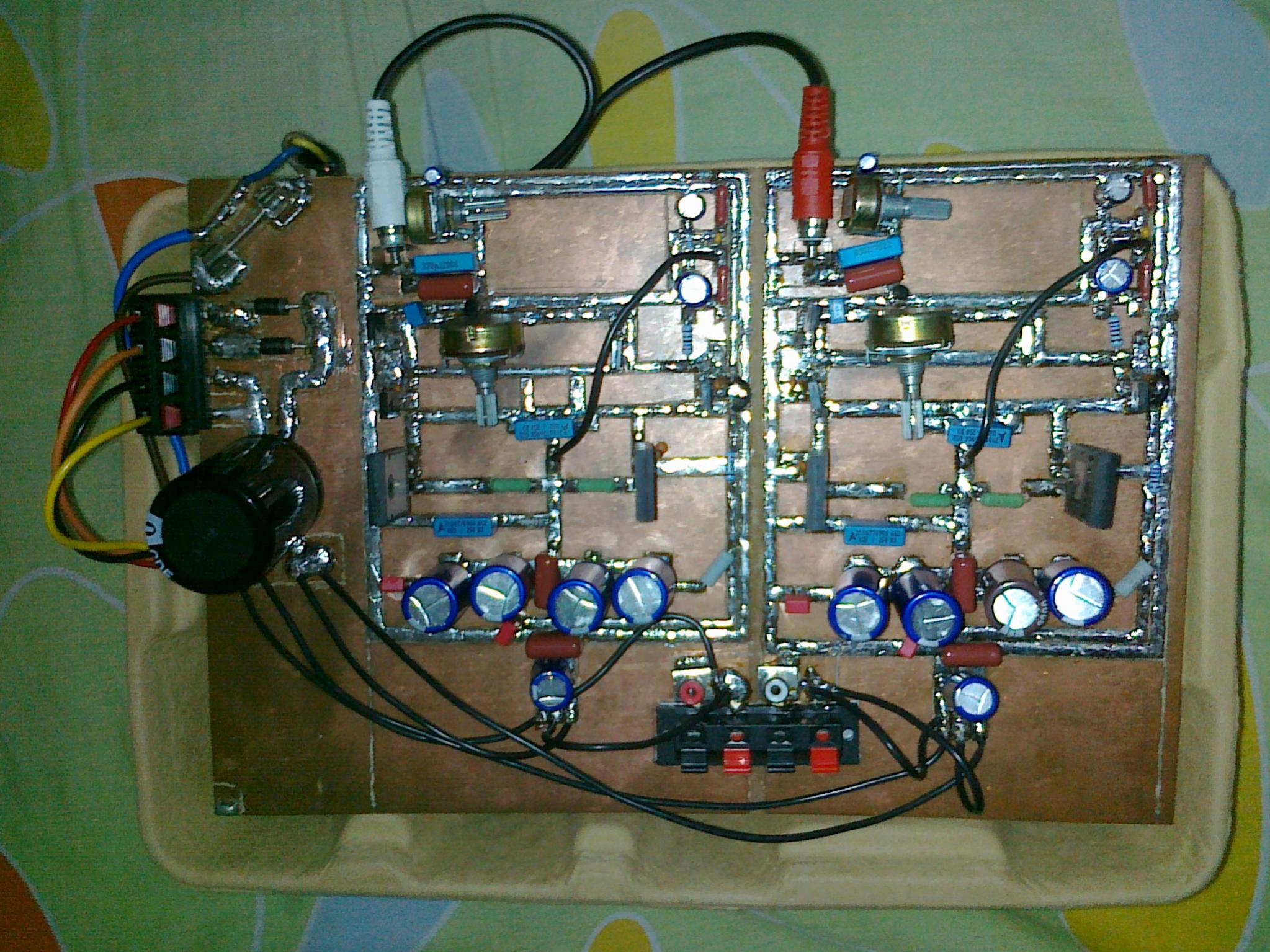

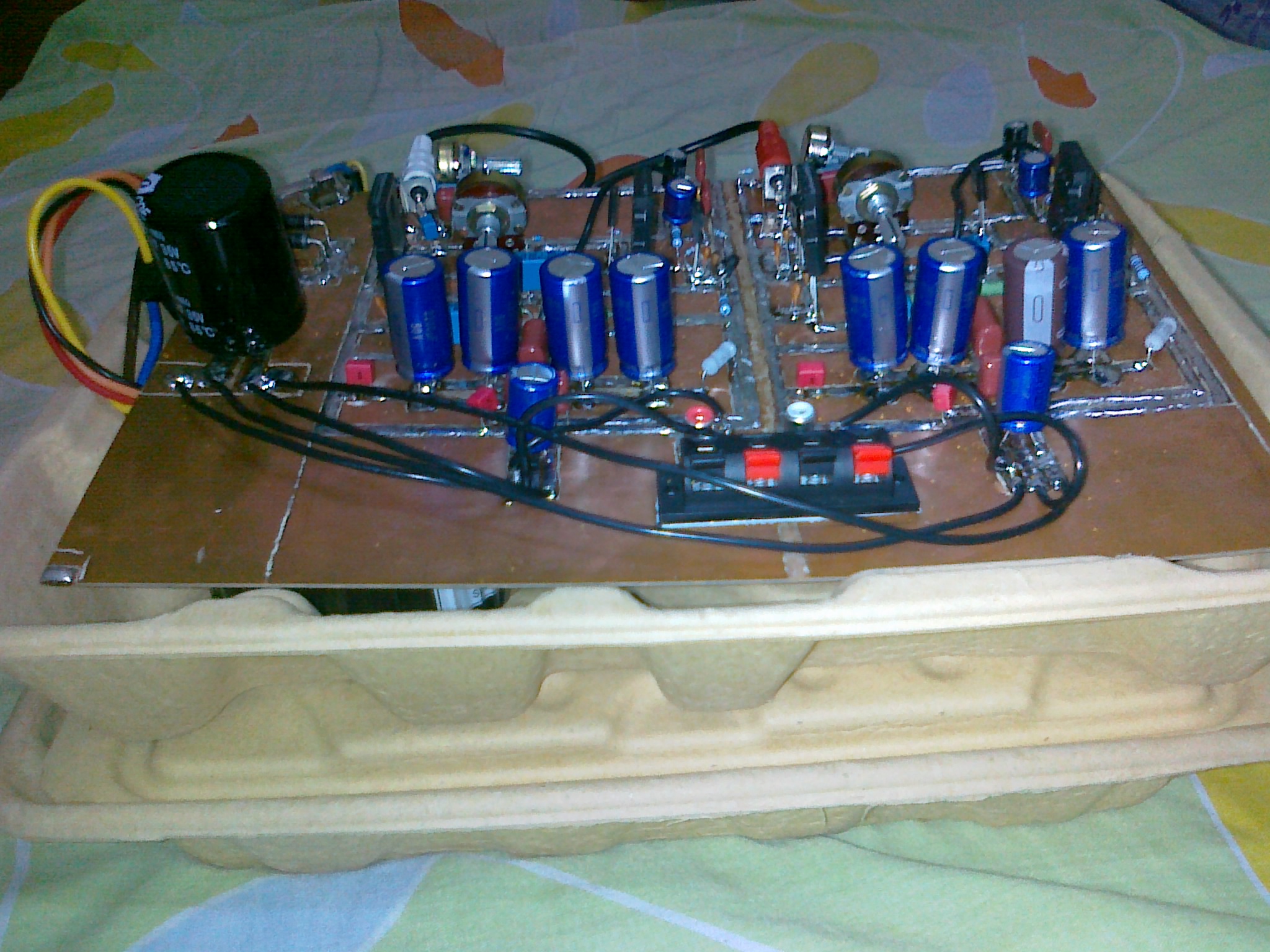

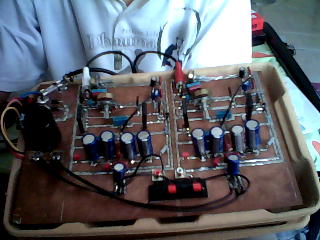

Here is more picture of my dx trust ! Worth to TRUST !
The tray below is container for my toroidal transformer ! the bottom tray is for cable keeping, just a brief keeping shelf.
Ehm ..ehm ..
what about those missing things that are supposed to be between the power Bjts ...aka heatsinks 😕
hm....... i brought those heatsink, but i don't have clip or bolt nut or locking device to hold them on X.x
hm... because the transistor doesn't heat up much (colder then warm water alot... almost the same as ambient temperature), so i thought it can be delayed for later installment...
ARGH........ additional problem now, i only realised now.... the heat sink i have, i don't have same of 4...... so i think this is not acceptable ? (as in differential cooling makes the amplifier act differently ?)
If you have an U-shaped aluminium bar that fits , you'll have to drill holes for screwing the transistors on it , after having put a 'washer' in between ( isolator ).
edit : also solid core !!!! but then it has got to be attached firmly (thermically talking ) to a finned one
