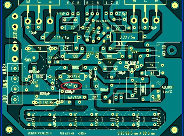

mind if i ask that, what will this values work for ? varying them will bring what difference ?You can use there:
103, 203, 223, 333, 473, 683, 823, 104, 154, 224, 274, 334, 474, and 1uf....even bigger will work there.

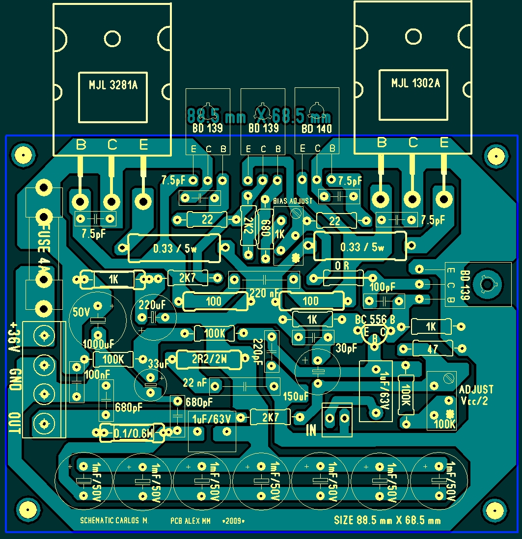

well... hi alex ! first time we talk.... well.... more like writing X.xHi guitar69 ,
Have you built ever an diy audio amplifier ? If you are at the first amplifier just take a breake , becouse you have solder iron damaged and think , this amplifier will work , with or without 680 pF capacitor !!! so just se PCB in attachment 😀
Regards Alex.

220n is the better value, despite 22n will work too.
This capacitor only works when amplifier oscillates..... this amplifier is stable and never oscilates..so..even the removal of this capacitor will not be a problem.

They are bypass capacitors...that other one you have asked
They are there to provide a low impedance patch to oscillations travel to ground.... but really, you will not have oscilations..so...no problems having or not having these capacitors..they are there "just in case"

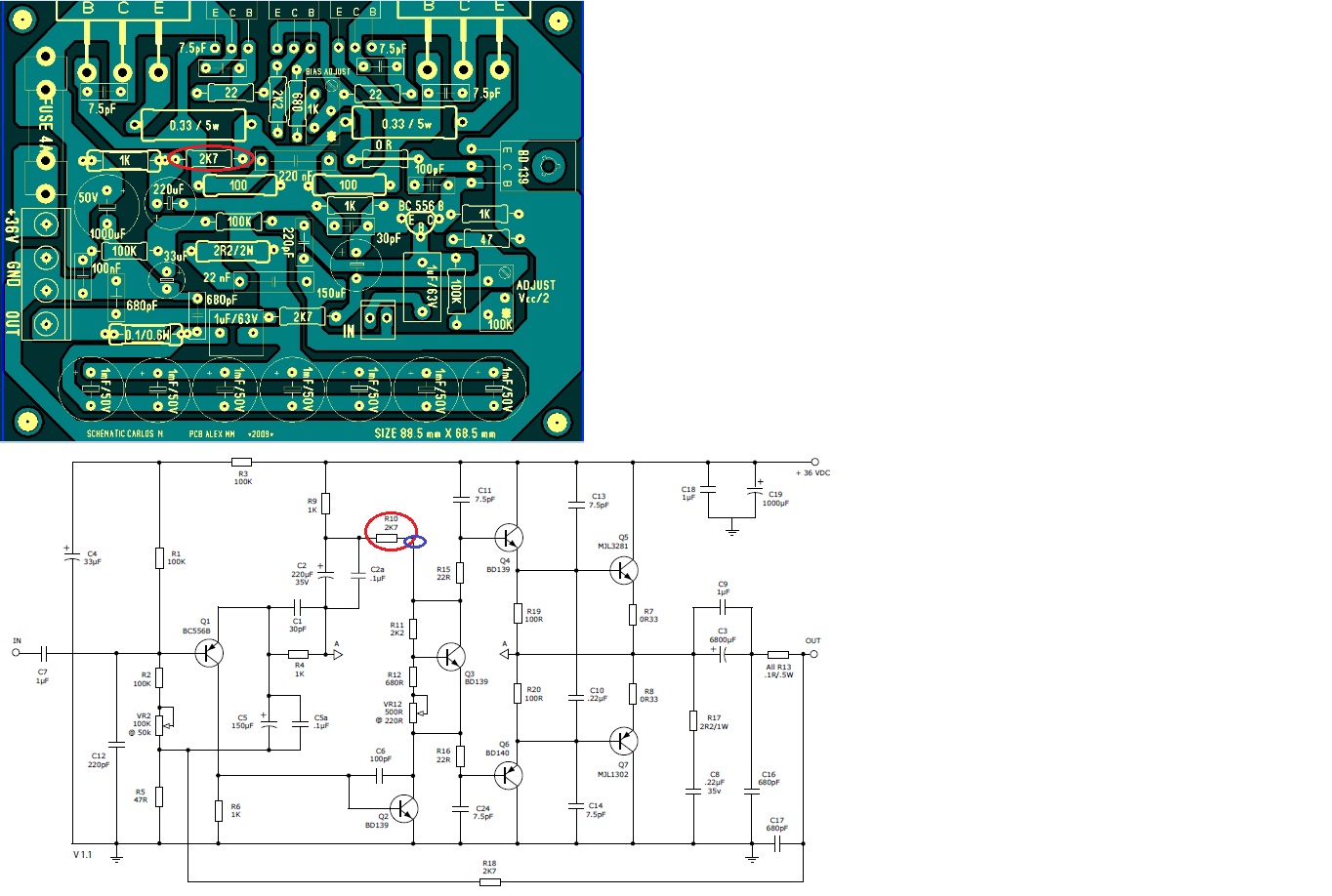

ah.... sorry to bother you, uncle... but i think this is quite a big different connection between sketch and schematic...
As attached picture, i have point out a resistor (R10) which have 2k7 ohm, is connected wrongly and the blue end terminal was connected to positive side of output condenser(C3).
Another doubt, is what i ask previously, is should the "A" and "A" connected ?

Thanks alot, Alex... sorry for the trouble, anyway i couldn't find any other dissimilar ^^

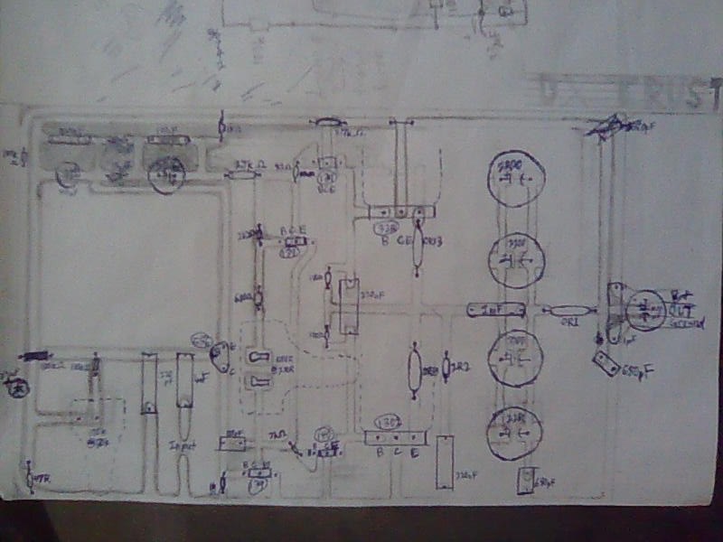

uncle, i'm scratching the copper board ! only manage to finish my power supply unit section.
**By the way, i'm using a nail polisher and a Phillip screwdriver(old one) to scrap the board, instead of steel ruler ( i don't have any at my house) ******
Going to make power supply section + 2-channel dx-trust into a single 20cm X 30cm board !
I'm designing my board (alex's sketch component size are alot different with mine) on the half way...
But i think it would take a few days to complete, a long job ! want me to give you a photo of my power section ?

hehe, uncle, i'm using those time between do make my sketch by using pencil , based on my components and dimension.
Although its not small, going to make it more compact (current size: 19cm x 12cm), because some space reservation are too big. The sketch only missing a input connection (left bottom, disconnected portion), a wire (connection of points "A"), and 4 x 7.5pf capacitor.
Will begin the etching (well...... i use scrapper, not chemical) on my board today, continue by tmrw, hope i can finish it by tmrw !
If you notice in the picture, there is a big spaces in the far left (middle), wanted to put some labeling in there. (eg.: left/right channel, dx trust, etc)
Dotted line are indicating the variable resistor and heat sink.
I just noticed left side about 5mm is not in the picture......
Is this the progress you wish to see ? (or you think i'm a slowpoke or a sloth)😛

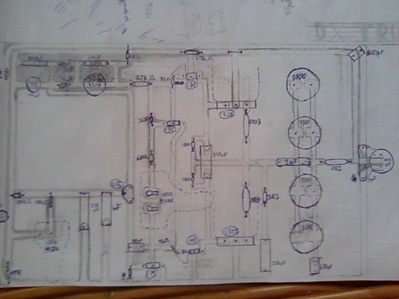

Edited new Sketch
I have attached another sketch, which is almost same as previous, but it is revised.
Some mistake in the circuit have cancelled and re-do, added information such as base, collector, emitter and polarity.
I'm thinking to put in a RCA receptor for the input only, to each channel.
Then at the power section, the lower part quite empty, so i'm thinking to put a 2 RCA receptor and a circuit into a TRS 3.5mm (computer plug), this makes the input flexible of RCA and TRS connection.
I will also port (by wires) the output to the lower part also, make a clipping stands and RCA output for 2 separate channel. This also make flexible of RCA and bare wires connection(clipping it).
