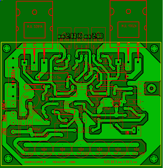

i thinking of customising of the alex board arrangement a bit, for my suit and ease to solder (well.. i change some thing like : 4x22,000uF instead of 8,600uF, 3.3+4pF instead of 7.5pF, etc)
And can you help me check it ? (afraid i miss out something)

damn..... i found alot of wrong schematic (older version) ....... which is the final version ? having problem locating it !

According to the schematic v1.1, which you after announce no more modification, there is no rectification for the pcb sketch.
I saw some problem in it, like there is only 1 680pF in the PCB, but 2 in the schematic. ETC
Would like you to point out the mistakes X.x

i read...... and i found only schematic have 2x680pF from the beginning, but i didn't saw it in the PCB sketch.....hope i was wrong
haha, kinda, until now, i only saw PCB sketch that have 2 680pF capacitor was on page 3, but it was quite old one ! need to revised

about the 680pF, it was previously C10 & C11 (the PCB line is correct), but when the item list changed, those 2 became C16 & C17, C16 disappeared from the PCB line sketching

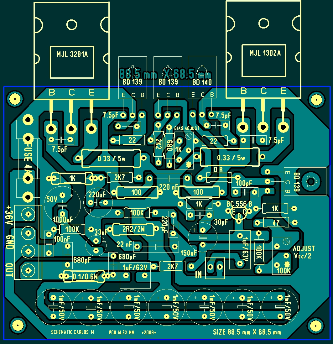

about the missing 680pF, it really omitted in those PCB sketch line, just add in simply from the negative terminal (cathode) of the output condenser to ground(or negative terminal).
Is it correct ?
I think i will further check the sketch first...... will tell you if anything have different
Is it correct ?

Hi guitar69 ,
Have you built ever an diy audio amplifier ? If you are at the first amplifier just take a breake , becouse you have solder iron damaged and think , this amplifier will work , with or without 680 pF capacitor !!! so just se PCB in attachment 😀
Regards Alex.
Regards Alex.
