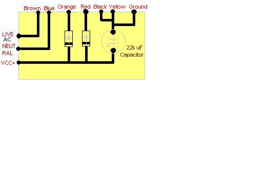

I attached the image show the connections joint, is it correct ?
about the 42V, its higher than my voltage rating of my capacitors (mostly 35V).
Should i replace all the capacitor's voltage rating to higher and slightly increase the wattage of resistor ?

Yes, but in reality these two outputs will star out from the positive capacitor leg, same for the grounds, and run separate smaller gauge wires for signal grounds to the main ground on the capacitor.
NEVER mix signal ground and power ground!!!

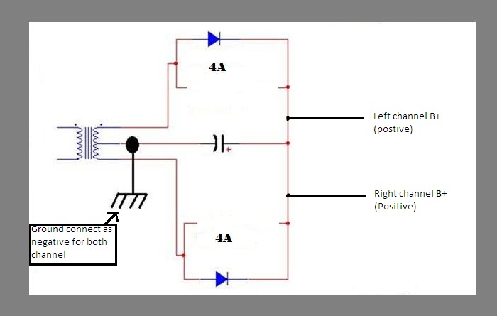

I also found out that the 1n4007 diode's forward ampere is 1.0A.
My transformer's maximum output was something roughly 2.677A, so i assume the maximum is 3A.
And i doesn't love to crank up the volume too much, so i just put 3 '1N4007' parallel at each side, means 6 of them, is it correct ?
and the capacitor for power supply, i will put 22,000uF, since its more general number(also for ohm). What should be the rating of the capacitor ? at least 50V ?
dear tekko,
If you said so, can you modify my image abit, so it won't be problematic ?
How should i connect to separate those 2 ground ?(in the case of dx trust)

be careful about using 3 diodes in parallel - it's likely one will hog the current, blow up and then the next one and so on. To ensure the diodes share current more or less equally you need to put a small power resistor in series with each diode and then put the resulting diode+resistor combinations in parallel. A resistor of 0.2Ohm to 0.5Ohm would be suitable.

hm... it sounds dangerous... by putting resistor in here, the power supply output to amplifier is reduced significantly.... So i better put a 3/4A diode.

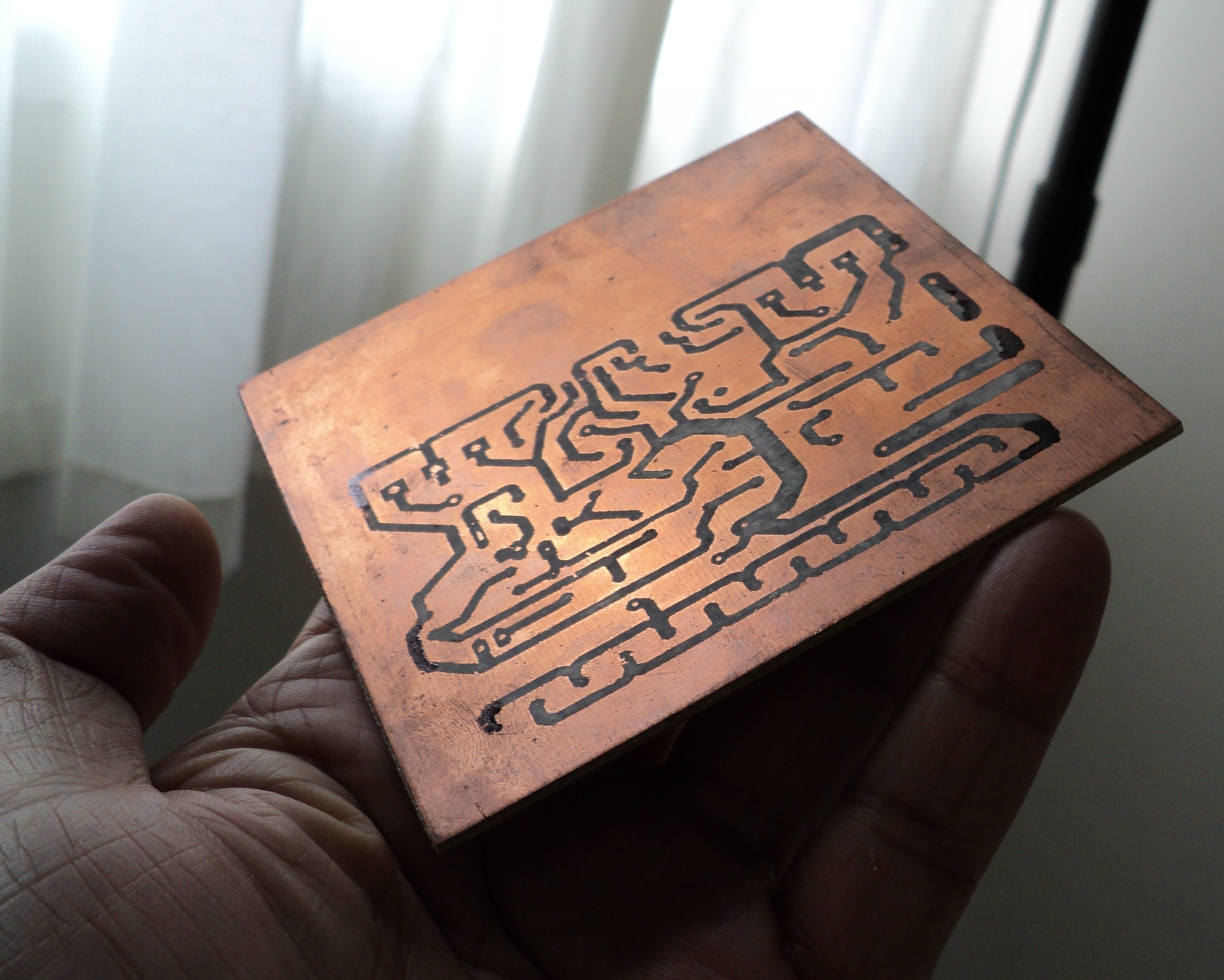

hurray, components have arrived, but forgot the solders and board.... going to purchase it tmrw ! I'm going to do solder-path soldering, so what board should i get ?
(well.. supposely not ordinary PCB which have holes X.x)
Copper coated ? copper plated ? or just find a piece of plywood for it ! (most probably not going to)
I have found a board Kalinishikova made to me ...
... maybe a hundred years ago.... so.... i will buy more acid and give a try on it...this amplifier is nice..sounds very good...i love this kind of sonics.... reminds me when i was very young (thousand years ago)

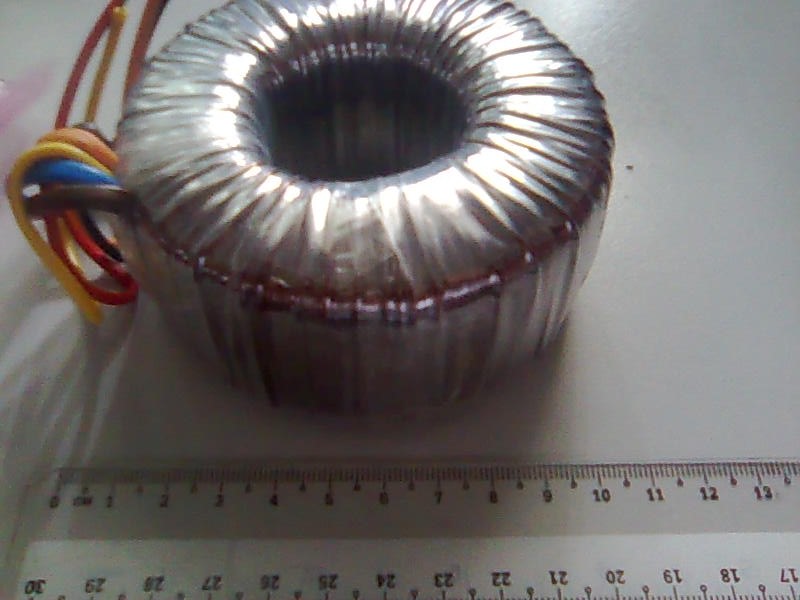

The first picture is my toroidal

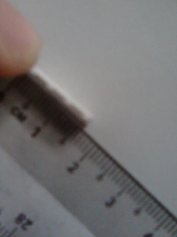

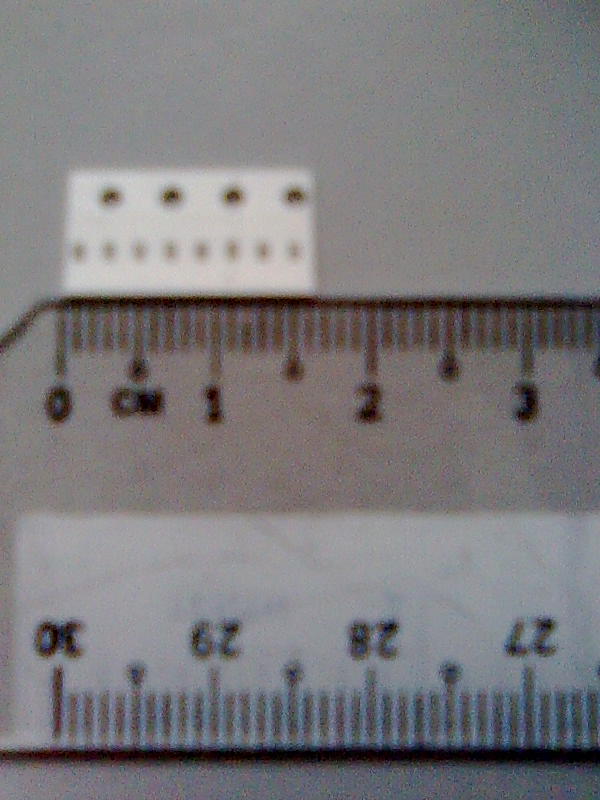

But i got problem with capacitor of an value ..... 7.5pF
well..... my order from net only available this type of .... flat.....SMD type, but it looks ridiculously small and thin... i have no way to solder into my things !(or you guys teach me X.x)
Its a 2 sided ..... in the picture it was 8 capacitors !!! ..... the metal below the round hole is the lead.......
Anyway, i go out and brought normal ceramic type... but i can't get 7.5pF, so i get a combination of 4pF & 3.3pF, going to instal parallel to each other , instead of 7.5pF. Is it ok ?(workable ?) its kinda the nearest number i can get.

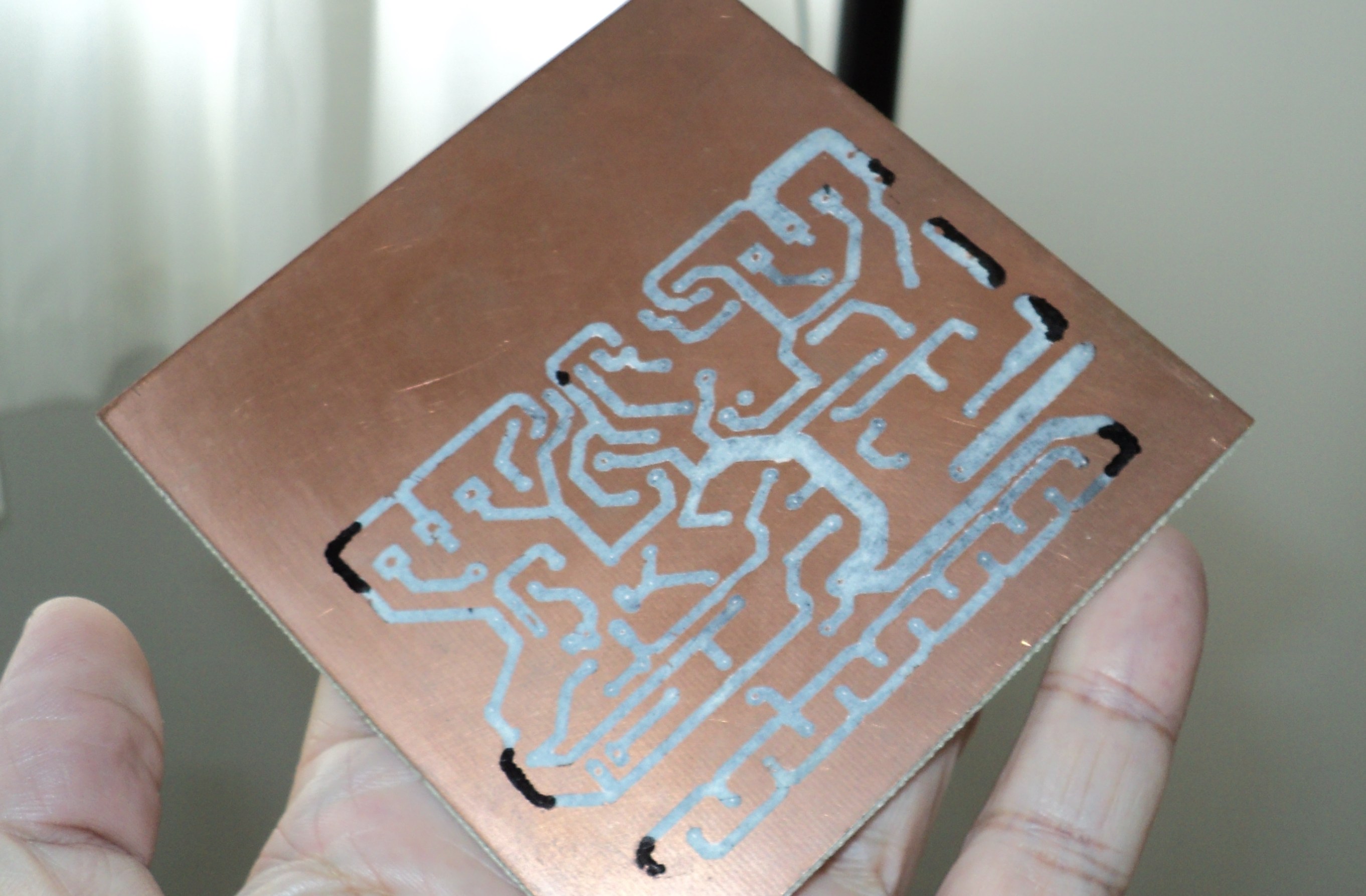

While i'm at my mom's shop now, i have some free time to do my sketch !
i have attached the power supply circuit (PCB diagram)
help me see if anything wrong with it ? X.x (never hope to have wrong)
