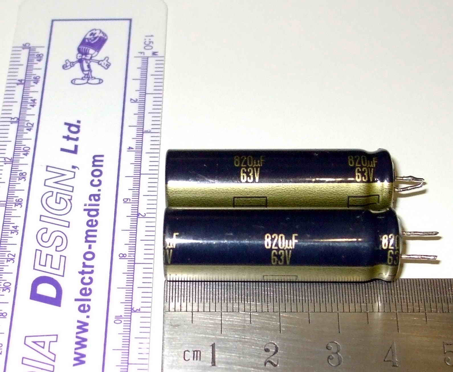

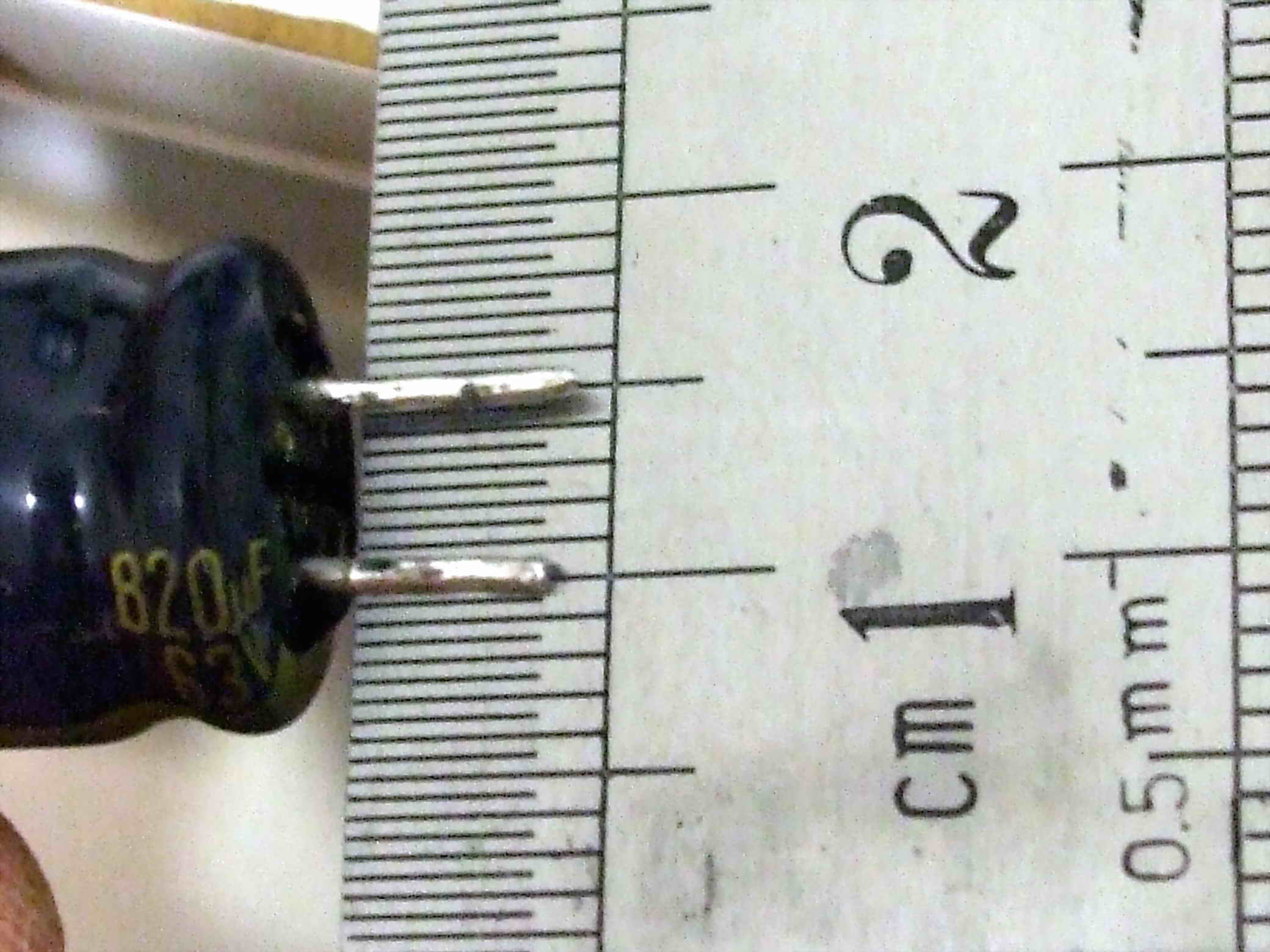

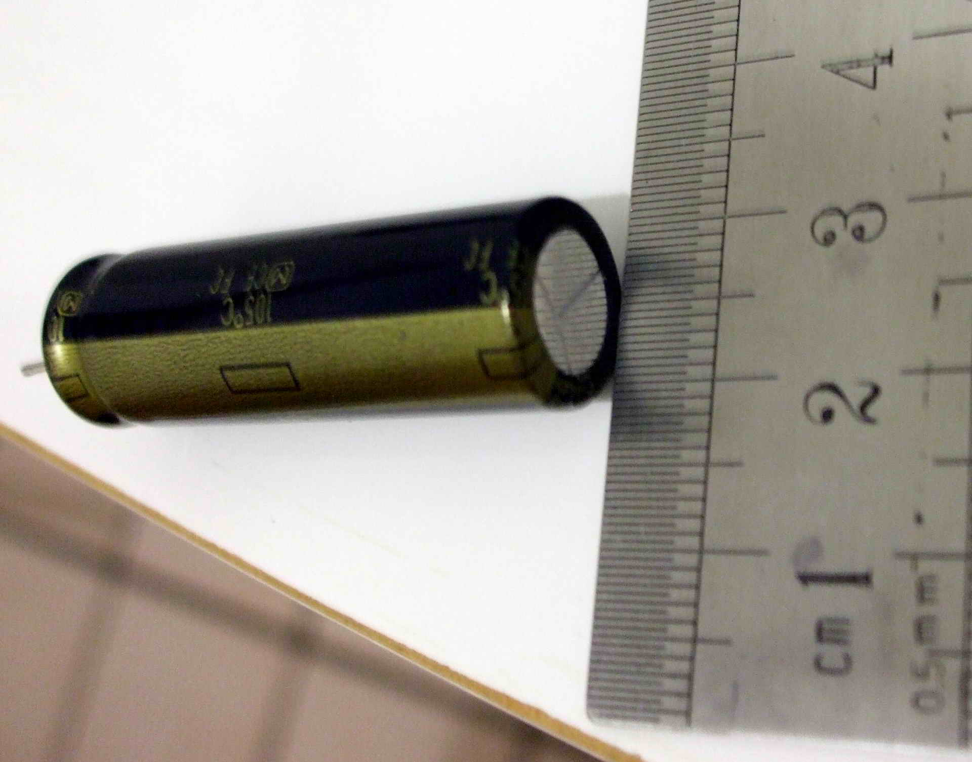

Condensers i will use connected in the Trust Amplifier output
They are output coupling condensers..there are several in parallel.
Attached,
regards,
Carlos
