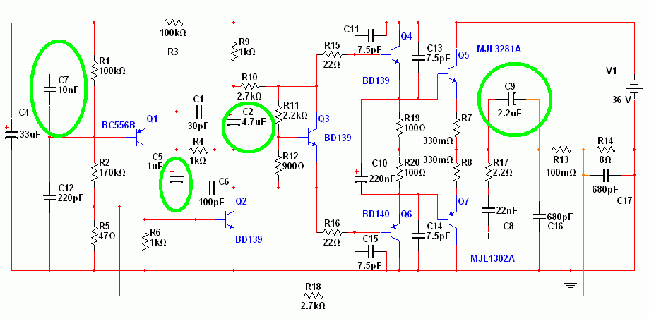

The center frequency adjustment is a little bit boring
The output line has almost half from the supply voltage... this is adjusted by a trimpot... and the trimpot is installed into a series of big resistances ( R1, R2, Vr2 and R5 )....big values and having a filter condenser between them ( C4 ).
The current is small and the resistance is very big...also the filter condenser is very big... reason why the time constant is big too... condenser delays a lot to be charged with full voltage.... this disturbs the half voltage to the output line...turns the adjustment boring...you tweak and must wait things stabilize.
You can substitute all big condenser by 1uf or 2.2uf, this will make your adjustment faster...then, after adjustment, return the correct condensers in place... also the one at the feedback line does that.... also the bootstrapp condenser does that too.
Now the gain resistance..the one at the feedback line, it must be 1K if you assemble the 70V version (more than 100 watts at 4 ohms).... i am using 2K2 on my 40V amplifier and you can use also 3K if you perceive as needed to reduce input sensitivity.
Back some posts i have discussed sensitivity, i think into the Dx Amplifier thread but i have posted a link in this thread about this text..the sensitivity text..also will be posted at Greg Home pages.
R1, R2, Vr2 and R5 are the series resistances and C4 is the big condenser...yes..it can be reduced to half this value...was an overkill i think.... C4 can be made 1uf during adjustments and then, after that, return with the 33uf value, or 22uf value and even 10uf can be tried there (I have not tested..but i know if too much low you gonna have enormous hum into the output).
C5 is the feedback one... this one has big capacitance too..and also help to bother when you adjust the voltage into the output line...and this one must be half or a little bit higher than half the supply voltage.
The bootstrapp condenser also helps to turn this adjustment not kind.
All them can be replaced, by something small as 1uf while adjusting, and them return to the big ones.
Do not increase C11, C13, C14 and C24...maximum is 10pf and this has influences into the amplifier measurements into simulators...all parts was tweaked (exception was C4) for better performance into simulator THD measurements and fourier measurements.
Yes... a zener would be better there..but i have made this way..all stuff published this way..schematics and many foruns have this schematic as standard...so, i will change anything..because it is not an error..just a boring thing because my non very good decision to avoid a zener there... zener can allow me to use smaller resistances and will load very fast as will avoid the use of big condensers....but also some folks says it is noisy...that zener is that and those..well..there are folks against zener...others may prefer a CCS and this history will never finish... reason why it is there the way was made and will not be changed.
Do modifications under your own risk... the guaranteed schematic is the one offered...no modifications, upgrades and updates allowed.

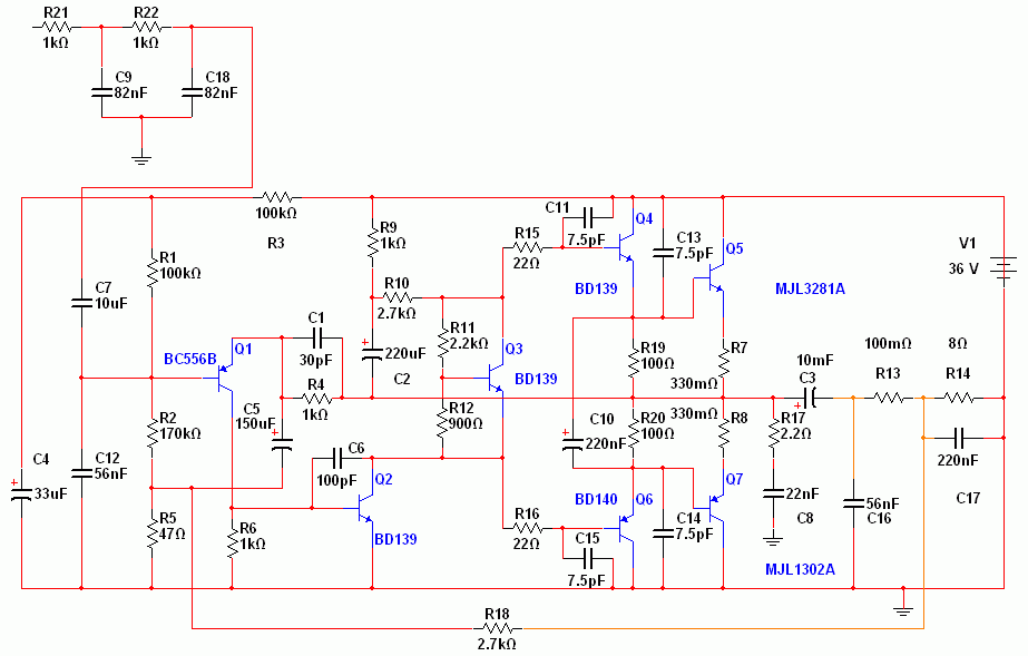

For those who multiamp their speakers, this project would make a very nice tweeter amp. Plenty of power. Just use the output cap as a pole in the crossover system, which will be required anyway. It will be small enough to use a film cap, for those who object to electrolytic coupling caps. Even the midrange crossover will often be small enough for a film cap.
Sheldon
Sheldon
Using this one as treble amplifier will be good
and will reduce costs.... just install a 10n condenser into the input and reduce the output condenser, the gain condenser and the bootstrapp condenser.
Only high frequencies of audio will cross de amplifier.... so you can plug it directly to the tweeter.
into 5 khz you have already a loss of 3 db into your amplification...of course bellow 5 kilohertz goes reducing till you will not have absolutelly none amplification.... from 8 kilohertz and up you will have full power to the treble.
Here the schematic with the modifications to produce a Trust Treble amplifier (TT, registered trademark..ahahahahah!)

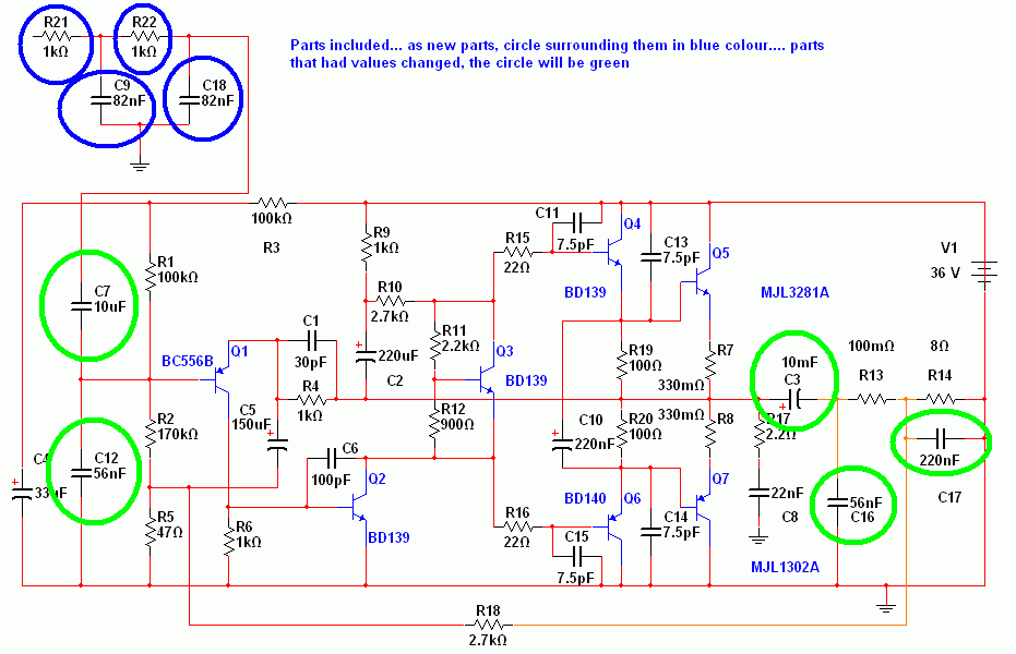

TB.... Trust Bass.... this one almost cut frequencies higher than 2 Kilohertz
Power into 2 Kilohertz is smaller than 1 watt.
High power only till 300 hertz... above this frequency you gonna have losses... into 400 hertz you have already 3 dB loss.
This is a subwoofer amplifier...output goes direct to the subwoofer driver.
Soon i will offer you suggestion to the midrange unit.
This way you will able to control deep basses separated to high bass and mids..and separated from the treble..so... three ranges to adjust in separate volume controls.
You know that limiting frequency the amplifier distorts less (Intermodulation)...also sending filtered signal to drivers they will work sligthly better....and you will be able to adjust three ranges.

Added parts in blue...new value to previously existent parts
have receive green circle surrounding them.
regards,
Carlos
TT = Trust Treble, was only simulated, not tested real life
TB = Trust Bass, was only simulated, not tested real life
TM = Trust Mids...not created yet.
regards,
Carlos
