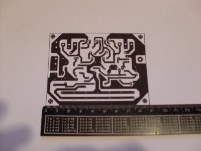

I would like to ask all Dx friends not to produce more boards
The one made by Alexmm was already aproved... and published not only here but also into other brazilian foruns and also Orkut.
Modifications now will generate mess and much more work to me because i will have to publish the new one in many other places than this one here.
Also i have sent all needed files to Greg, including the boards layout to be published into Greg Erskine home page.
This board is standard..final board...and the amplifier circuit is final too...this will produce more consistence and smaller threads....only one board, only one schematic option and into those 5 first pages all the informations needed to build were posted.
No more modifications please!...no more boards please!
Now it is time to build, to produce pictures, to post pictures and to write evaluations, listening impressions, group listening evaluations and testings and reviews.
Time to build!
Please Alex...no more boards!

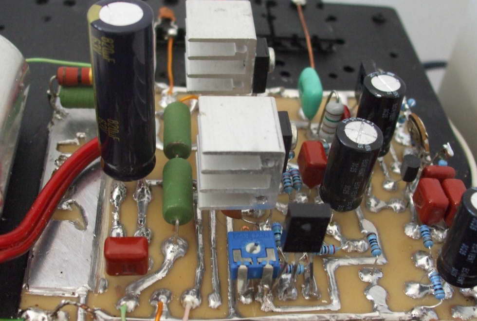

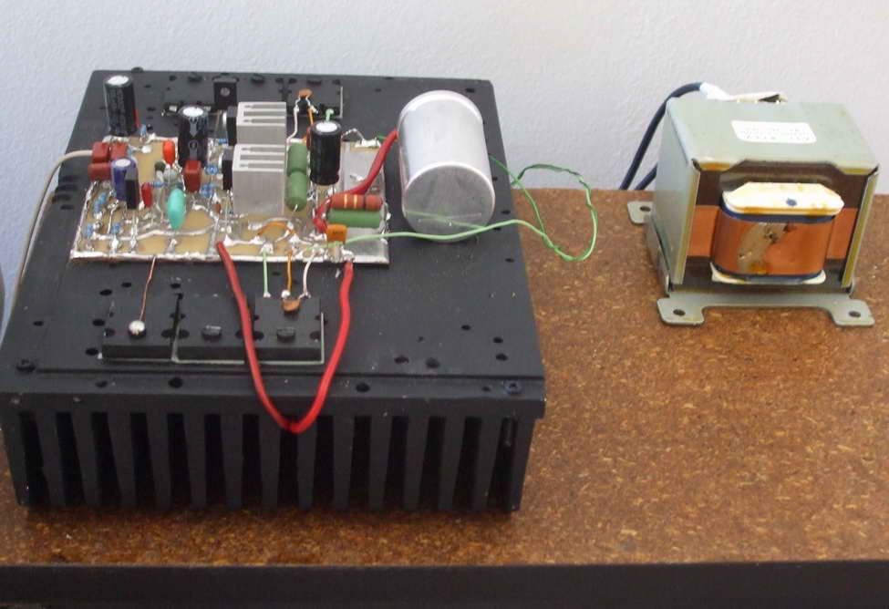

Trust 70V..... more than 50 watts RMS at 8 ohms and more than 100 Watts RMS at 4 ohms

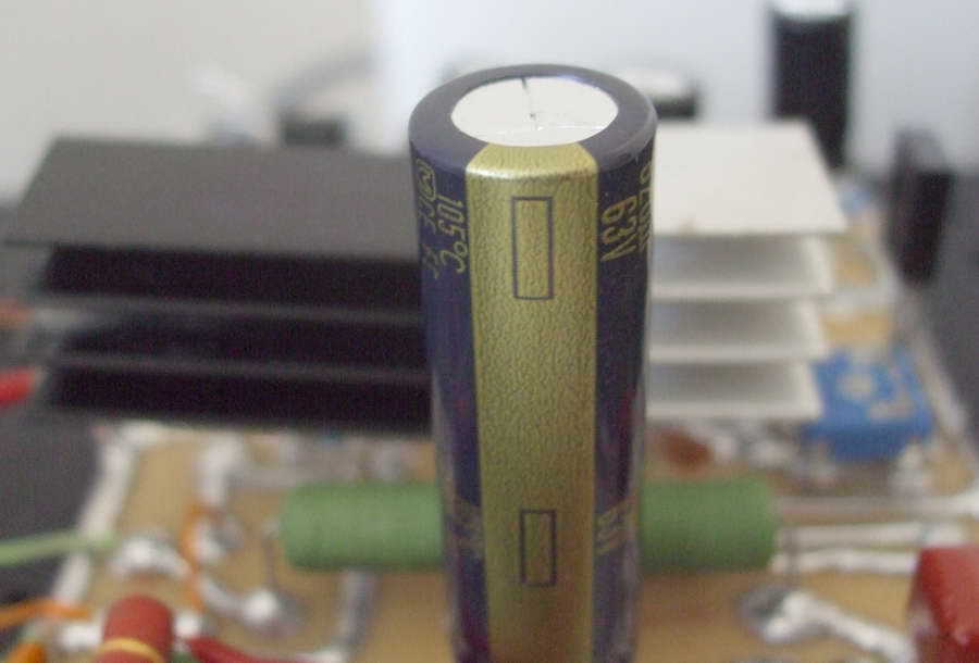

The low distortion was keept.... the board remains the same Alex mm board but condensers insulating voltage have increased..this may turn a problem to fix them into the board...maybe higher than the board (aerial, when only the leads enter the board and the part goes half inch above the other components into the board)
Insulating voltage to all condensers now are higher than 70 volts.
Transistors remains the same....now you understand why i have used those ones..already thinking to the higher power version.
You may need small heatsink to the drivers.
Bias potentiometer can be 2K adjusted to 1020 ohms or you can use 680 ohms fixed plus 500 ohms variable to better and easier adjustment.
Adjustment remains the same.... from 10 to 15 miliamperes over the power emitter resistances.
Output voltage...measured at the output condenser positive side and ground must be around half the VCC voltage..in this case it will be 35 volts...or sligtly more.
This amplifier can be modified to even more power and voltage.
Forum management does not accept higher voltages as they may be dangerous.... i do not know the limits but may be bellow 100 volts DC
Enjoy the Dx Trust 70V
regards,
Carlos

This higher power version was not built
So... we can have some surprises.... well..this happens...into the simulator it is fine...well..into the simulators everything is fine.
Do under your own risk..this version is not guaranteed by the Corporation..it is just an option to powerholics.

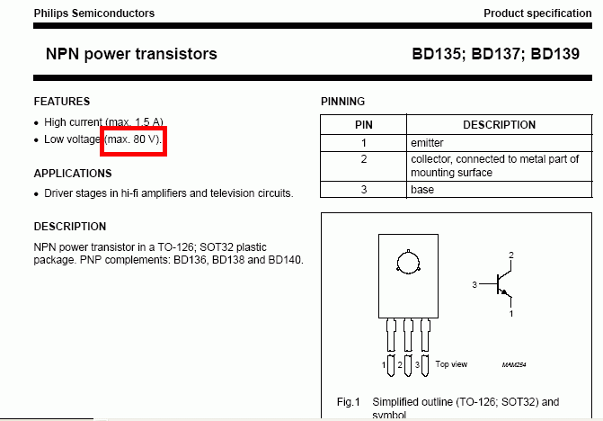

I wouldn't be the least bit scared of using an 80V driver transistor at 70 volts. They take a lot more liberties than that with store-bought amps. 100V? Not without pre-testing and grading them
. But then you're getting up where you woudn't 'trust' it not to blow up if you made a mistake.
destroyer X said:Do under your own risk..this version is not guaranteed by the Corporation..it is just an option to powerholics.
Carlos

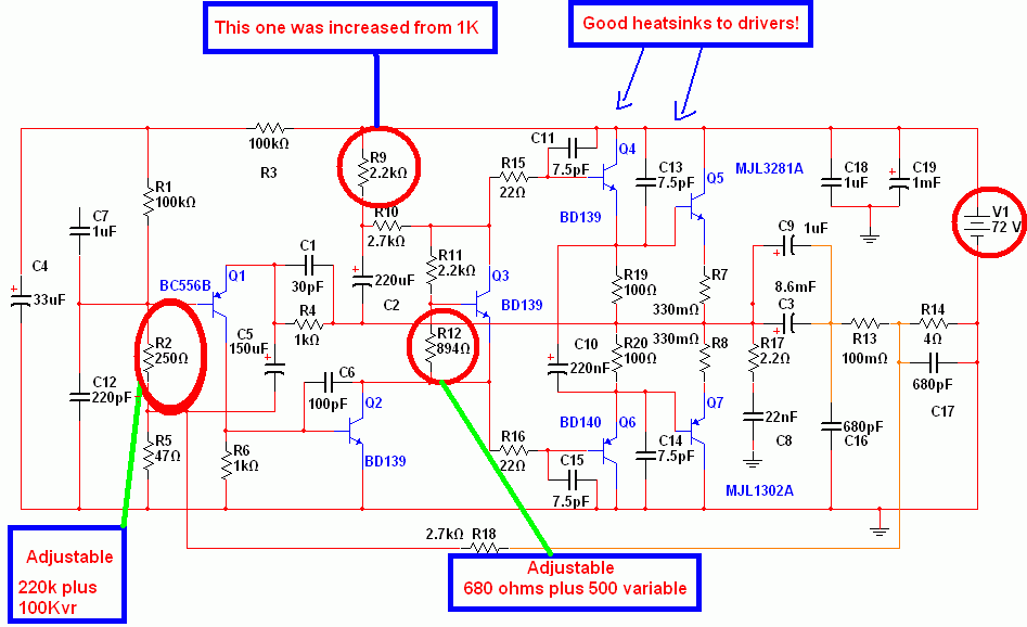

Use good heatsinks for the drivers.
Observe first bootstrapp resistance (1K) was increased to 2k2.
Observe the new final resistance value from input base to ground.
Observe the bias trimpot pré adjustment for start up purposes.... 894 ohms is the value to be pré adjusted.
Observe condensers have increased voltage insulation.
It is now guaranteed....tested and proved as good and reliable.
If you face problems...check your construction because for sure there are constructive errors...i have checked the whole thing.
Other transistors and other voltages may produce a different adjustment point.... different resistances.
regards,
Carlos

Attention...to R2 it is better to use a 100K fixed plus
a 100K variable... and start your adjustment with 150K total..... in other words, set your variable one to half course...half resistance.
I have returned to lower voltage...now operating with 45 volts...i like the most this amplifier into the 35 to 45 volts version.
regards,
Carlos
