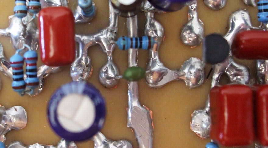

Carlos ! Why using so much solder on boards? May be is your secret weapon for quality sound.

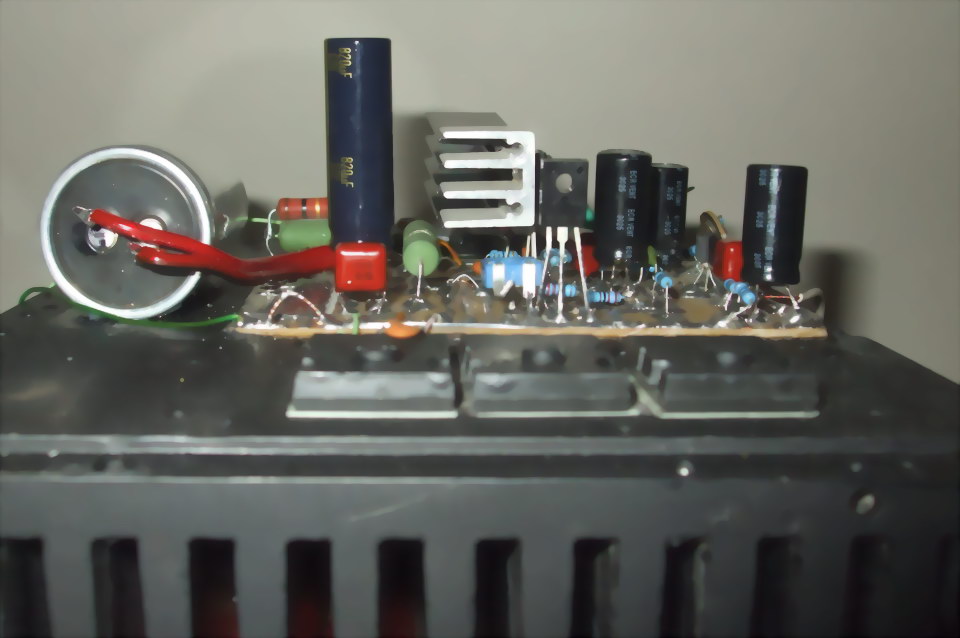

I have built and tested.
result fine.
regards,
Carlos

Carlos revealed his secret to me privately. It's not the solder, it's the method of applying it that makes it sound good!
This particular instrument has .0000003% THD apparently, and sounds great. Be careful though, there are a lot of Chinese fake ones on eBay.
The excess of solder cover the etching process failures
also board becomes huge..... the third advantage is you will never have copper lines off the fiber board, because when you solder you gonna melt the surface while the deep solder (the one touching the copper lines and board) remains cold, or at least not too hot....there are dissipation along the solder lines.
Another advantage is that if you have shorts, you will never have copper lines burned.... the solder lines can resist more than 40 amperes..so.... will never burn because supplies usually do not produce so big ammount of power, even during short circuit moments.
The main advantage is that you can glue, attach your board into metal chassis or even heatsinks, because under the board there's no electrical connections...so you can glue, remove once again..and glue once again...and so on.
Other interesting advantage is that your components will have a ground plane under the board..because component leads are very near some metalic surface (metal chassis or grounded heatsink)... this is very good to stability.... the distance is the board thickness only.
But the better advantage is that you can use it and use it again and again ...board last for long ..you will be able to build several prototypes into the same board, because it is almost undestructable.
Another advantage is that you can see your connections observing board upwards.... alike a schematic upper view, there you have all circuits, this helps to check your board...not needing to use lamps and observe boards using transparency methods.
The less important issue into this sittuation is how much solder you gonna spend, so big are the advantages you have using this method...it is very natural and intuitive too..alike windows...intuitive.
Thank you because you have asked.... i am in a big struggle to show forum folks the advantage to this system to ugly prototypes...a long time i use to do this...but seems nobody perceive the advantages...back my postings only silence... a rarity when someone perceive how valuable is the method.
regards,
Carlos

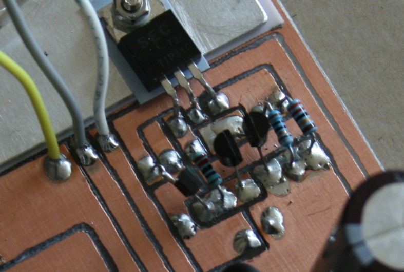

I made this board using a small screwdriver to carve away the copper. 🙂 It isn't closely audio related though, it's a circuit for measuring the inductance and saturation current of SMPS inductors and transformers.
