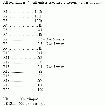

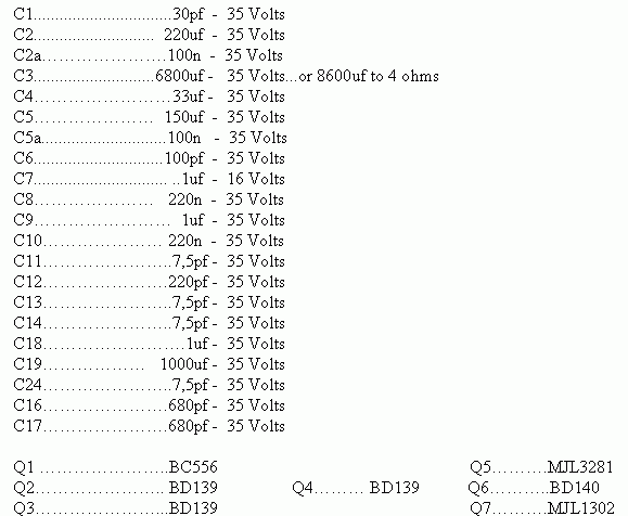

Bill of Material.... BOM... or parts list
I am asking Greg Erskine, our Gerskine to include the Trust amplifier into his home pages.... this will be very helpfull for us.
The Dx Amplifier, lower distortion version was not assembled...and when ready to go will be also included.
Here is the parts list:
All resistances ¼ watt unless specified different..values in ohms
R1…………………100k
R2…………………100k
R3…………………100k
R4…………………… 1k
R5………………….. 47
R6…………………… 1k
R7....................0,3 – 3 or 5 watts
R8....................0,3 – 3 or 5 watts
R9…………………… 1k
R10…………………2k7
R11…………………2k2
R12.................680
R13...................0,1 – 3 or 5 watts
R15....................22
R16....................22
R18..................2k7
R19..................100
R20..................100
VR2....... 100k trimpot
VR12.......500 ohms trimpot
C1................... ..30pf 35 Volts
C2.................. 220uf 35 Volts
C2a…………… ….100n 35 Volts
C3................. 6800uf 35 Volts...or 8600uf to 4 ohms
C4…………………… 33uf 35 Volts
C5………………… 150uf 35 Volts
C5a.................. 100n 35 Volts
C6................... 100pf 35 Volts
C7....................... 1uf 16 Volts
C8………… …… 220n 35 Volts
C9…………………… 1uf 35 Volts
C10………………… 220n 35 Volts
C11…………………..7,5pf 35 Volts
C12………………….220pf 35 Volts
C13…………………..7,5pf 35 Volts
C14…………………..7,5pf 35 Volts
C18…………………. 1uf 35 Volts
C19……………… 1000uf 35 Volts
C24………………….7,5pf 35 Volts
C16…………………680pf 35 Volts
C17…………………680pf 35 Volts
Q1 …… BC556
Q5...... MJL3281
Q2……… BD139 Q4…… BD139
Q3……… BD139 Q6...... BD140 Q7……….MJL1302

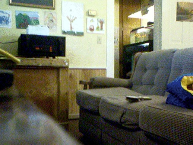

A honor to visit.. cool 😎 music.your visit will be a honor to me.
But , I do hear MY amp playing your music. (lot's of bass -LF)
The fish heard it too, jumping in the tank..😀

Ahahahah.... yessssss... Bass is nice.
The camera does not capture trebles..so....bass goes dominating the whole thing...there are two ways we have bass increased...when the recording media has losses when register trebles and when we increase them....i have both options!

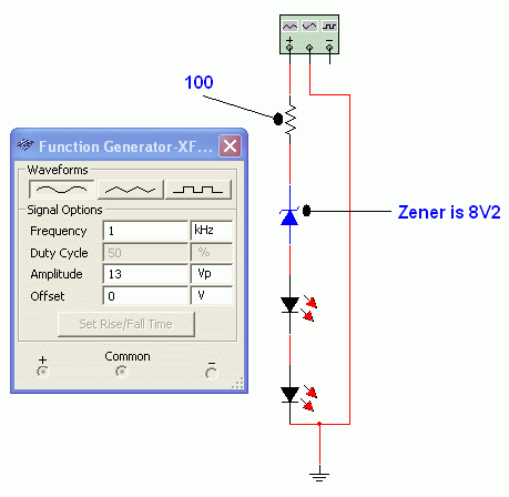

I have made a fast clipping lamp...something to flash when the amplifier reaches the maximum swing undistorted.
No quality to the video.... audio quality was not my worry.... as microphone was in bad position to capture quality..also volume too much loud is saturating the digital camera microphone.
But you can see ligths flashing.
Latter i will post the circuit... a resistance a zener and a Led....simple series thing.

This may be nice to install into speakers
because is driven by the audio..has no supply.... half cicle of audio crosses the zener and ligths the Led.... the speaker out is the connection to this circuit (heheheheh....obvious!)
This one was not calculate correctly.... i have to re-adjust.
But it is nice to see the ligth flashing...in special at nigth.
regards,
Carlos
