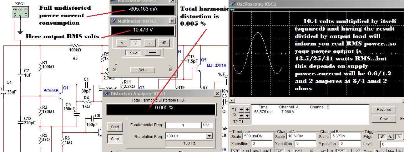

About to burn amplifiers...well..i understand this very well
I have expertise in this subject...i have built more or less 6300 amplifiers since i had 9 years old..... today i have 60 years old.... i use to say that but also i do not use to say how many exploded in my face....and exploded one third or them...more than 2 thousand failed because i had not knowledge and schematics i found in magazines where wrong.... i could not detect obvious errors when i was young..... but i have learned a lot...now i sniff the audio quality watching the schematic and values...yeah...i already can do that.
My name is destroyer x because i am an EXTRA DESTROYER of transistors.

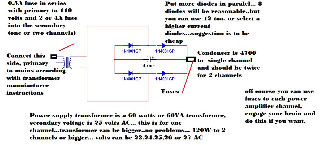

Not a good idea to use 12 volts...first because have to redesign the amplifier and uncle charlie will not do that... reason why is that no one that asked customized designs have assembled...there's a historical connection in between the ones wants customized and not to assemble ... the terrible "custom curse"
Output power will be very low if you try 12 volts..for sure i will not help you in that task..... because this kind of amplifiers, that uses a single supply, or a non simetrical supply, put out a little bit more than 1/4 of their supply voltage transformed in audio... and 1/4 of 12 volts is 3 volts.... a little bit more than 1 watt in 8 ohms is awfull...better to build a 2003 chip amplifier.
I see you are not skilled but you should burn your fingers and try...i am not having time anymore to be teaching ... so... sadly you will be half alone doing it...also i do think you will not build...because you're asking customized amplifier..already trying to change it to 12 volts..this is the sign that you will just talk and will not do it.

hm.. since you said in the image(power supply) that it can be ranging from 23V-27V (or any X.x) can i use transformer of multiple output ?(2)
i only found few on the web i can buy :
one more addition problem, the MJL1302 on the website need long time for delivery, how can i get alternative similar to it ?(which can replace it, so that i can get it faster)
Is it possible to use MJL3281 into same place ? (not trying to alter the circuit, but...... desperate)
and malaysia's technology progress is abit **** that i can't find everything i want
i do online purchasses, thats why i'm pain in *** about the power supply !
Is it fine as my power supply ? I will start ordering tonight or tmrw morning, then start the project whenver the delivery is there, for sure, with some fascinating pictures for you !

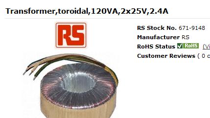

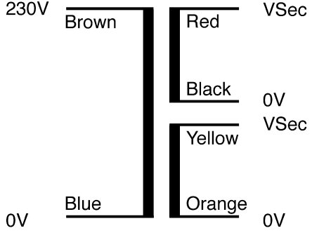

60VA is way too small if your looking fo more than 10-20 watts output per channel, for two channels, you need atleast 100VA since a class AB amplifier is at most 50% efficient.
So either one of hese transformers per channel or a 100+ VA one for both channels.
owww... that a headache, finding new transformer
Well... normal winding is slightly cheaper than toroidal, but torodial is more stable for audio application, isn't it ?RS | Transformers | Transformers | Chassis Mounting Transformers | Laminated Frame 230Vac Primary 75VA to 200VA (Multi Tapped) |10-5885
(100VA - 230Vac,50/60Hz - 2x0-20V)
RS | Transformers | Transformers | Chassis Mounting Transformers | Laminated Frame 230Vac Primary 75VA to 200VA (Multi Tapped) |10-5894
(150VA - 230Vac,50/60Hz - 2x0-24V)
RS | Transformers | Transformers | Chassis Mounting Transformers | Laminated Frame 230Vac Primary 75VA to 200VA (Multi Tapped) |10-5901
(200VA - 230Vac,50/60Hz - 2x0-20V)
RS | Transformers | Transformers | Chassis Mounting Transformers | Laminated Frame 230Vac Primary 75VA to 200VA (Multi Tapped) |10-5903
(200VA - 230Vac,50/60Hz - 2x0-30V)
http://malaysia.rs-online.com/web/search/searchBrowseAction.html?method=getProduct&R=0503938
(200VA - 230Vac,50/60Hz - 2x0-24V)
Toroidal:
RS | Transformers | Transformers | Toroid Transformers | Toroidal 230Vac Primary 15VA to 1000VA
(120VA,2x25V,2.4A)
(160VA,2x25V,3.2A)
(160VA,2x30V,2.667A)
RS | Transformers | Transformers | Toroid Transformers | Toroidal 115-230Vac Primary 15VA to 1000VA
These transformers will be good...i do like the toroidal one

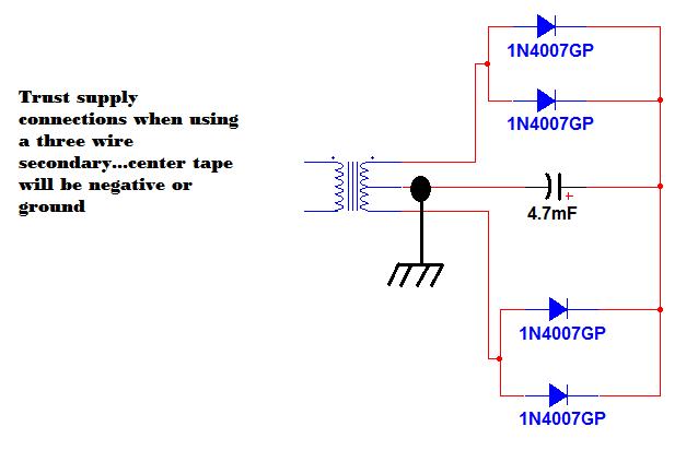

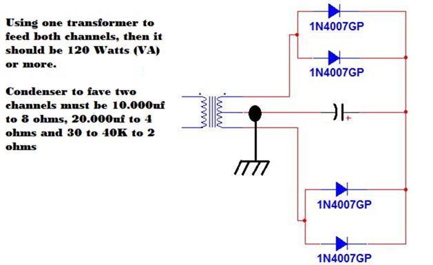

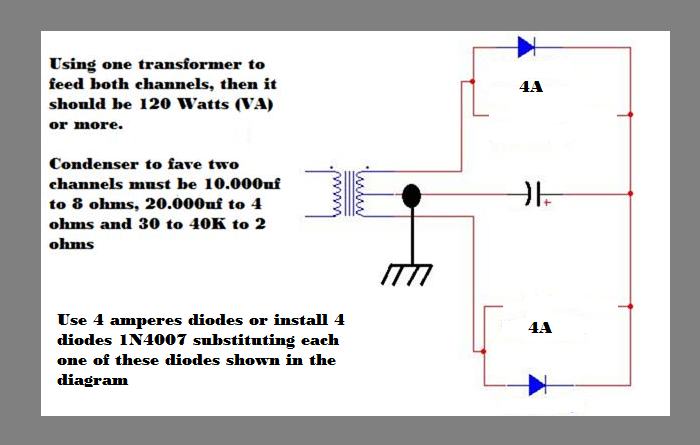

You will need one transformer to each channel or will be limited to 8 ohms operation....if you want to use a single transformer and obtain good power, then order a 120W unit.
attached diagram to three wire secondary.
regards,
Carlos

hm... just some question.... according to power supply in your diagram.(3 wire secondary)
if i'm not wrong(well... i don't have a naked transformer), it will have 4 leads(for 2x30V).
How should i connect 4 leads into 3 wire secondary as per your diagram?
negative/ground is connected to chassis or power source ground?
if i'm not wrong, connect in that way means in series, mean add up 2 value (eg. 2x30v=60v), then i should get lower rating such as 2x18 ?
and the amplifier should connect to which point(Vcc/B+) on the diagram of yours ? (kinda hate myself for being so....... UN-knowledgeable)
really need these information in order for me to work out the power supply.... 🙁
Connect black and yellow together.
then you will have a center tap constituted by this union of black and yellow wires.... will result a three wire secondary.
the result is that black and yellow joined together will be connected to chassis, the ground, and will also be the negative to the power amplifier.
Other two wires will go to diodes, two four amperes diodes (or more) will be interesting... then connect your condenser.... voltage rectified and filtered will be 30 alternated volts multiplied by 1.41, and this may result aproximatelly 42 volts and this fine to Trust amplifier.
Well man... seems you have a very little know how... be carefull or you will repeat my destiny..will blow your amplifier and in a matter of 49 years you will be creating amplifiers in some year 2060 forum... the future.
regards,
Carlos
regards,
Carlos
