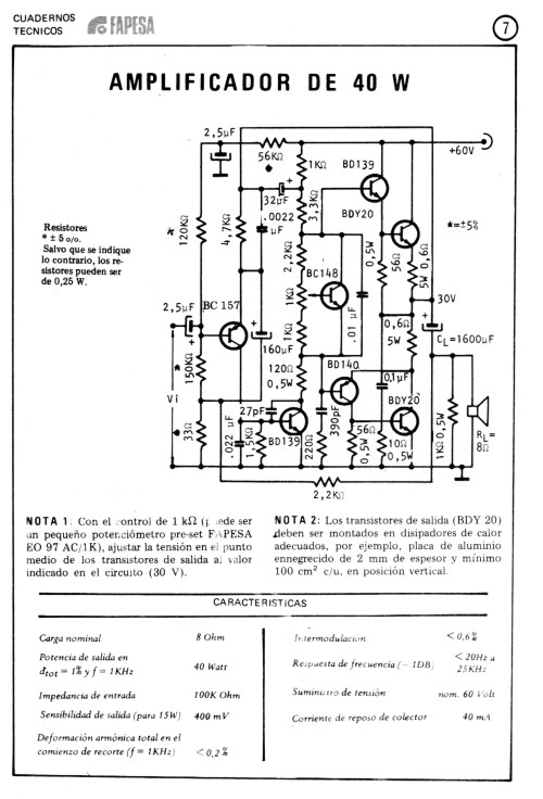

Hello AndrewT
How it is possible if i have 60v dc and 1.2A (single)power supply for amplifier i will get only 5.76W into 8 ohm load ,I have Philips 40 watt amp it can produce 40 watt at 8 ohm load with same power supply.
i have attached schematic . If i am missing something please clarify .
40W into 8r0 test load requires an output of 25.3Vpk and 3.16Apk.
To drive an 8ohms speaker you would need at least 5Apk as the maximum output current and occasionally nearer 10Apk.
You can't get that from a 1.2A PSU.

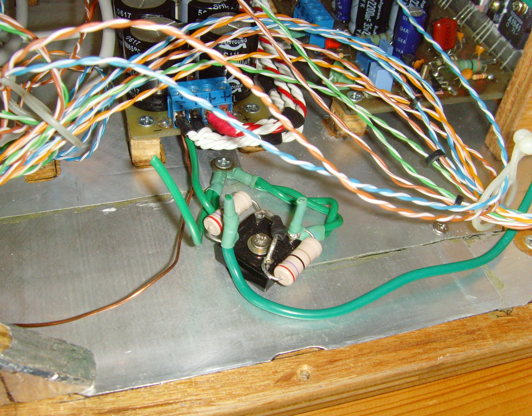

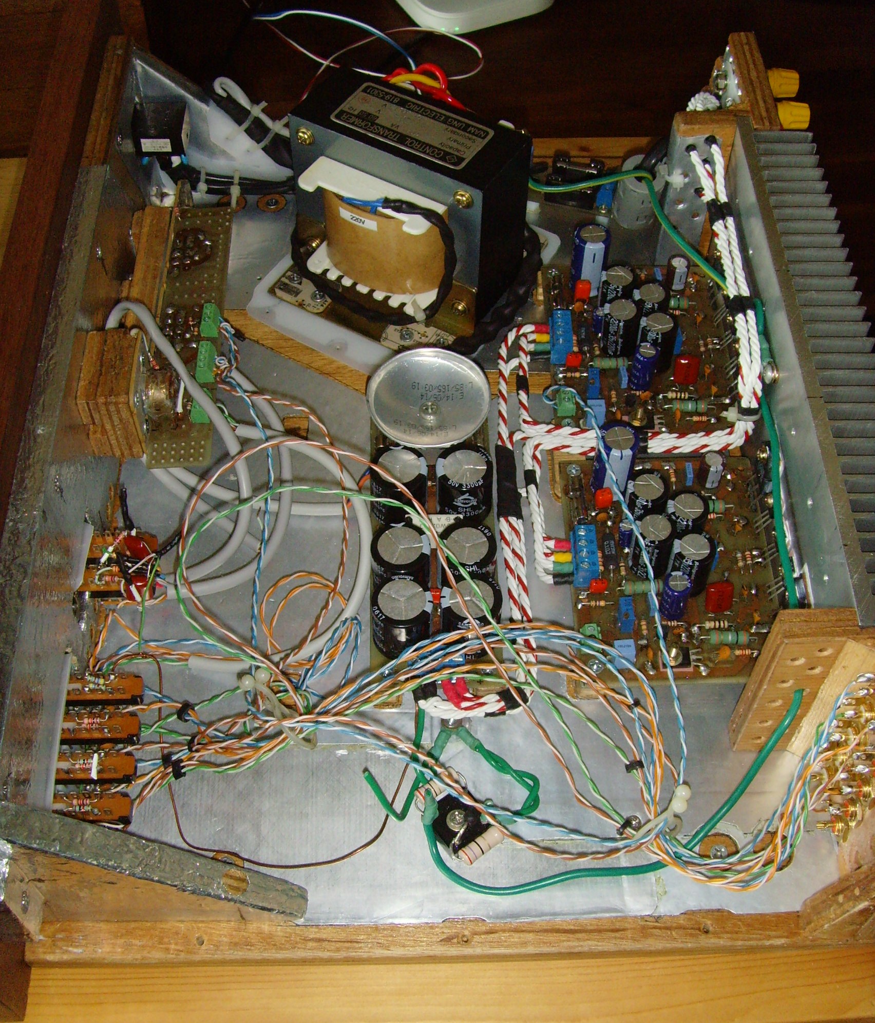

Safety ground connected.
Hello again. My DX-Trust is still playing happy music, even if it is still not finished. The weakest link now seems to be the old cheap speakers. Maybe I need have a look at a speaker project one day soon.....
The safety ground is now connected, one wire to the transformer core, another to the heat sink. From the heat sink the ground wire continues to a ground lift circuit consisting of a bridge rectifier and two 27 ohm/3W resistors. The other end of the bridge/resistor combination is connected to the aluminium case lining and to the negative terminal of the power supply, which also serves as the ground star.
I believe that the amp is electrically as safe as can be with this setup, please see the attached photos.

Is the PE (third wire in the Mains cable) permanently bolted to the Chassis (or biggest metal component/s)?
Yes it is, the green/yellow ground wire connects to the heat sink and the transformer. The heat sink is the only exposed metal part. The wooden case is lined with aluminium, but it is has no exposed edges and is earthed through the ground-lift circuit anyway.
