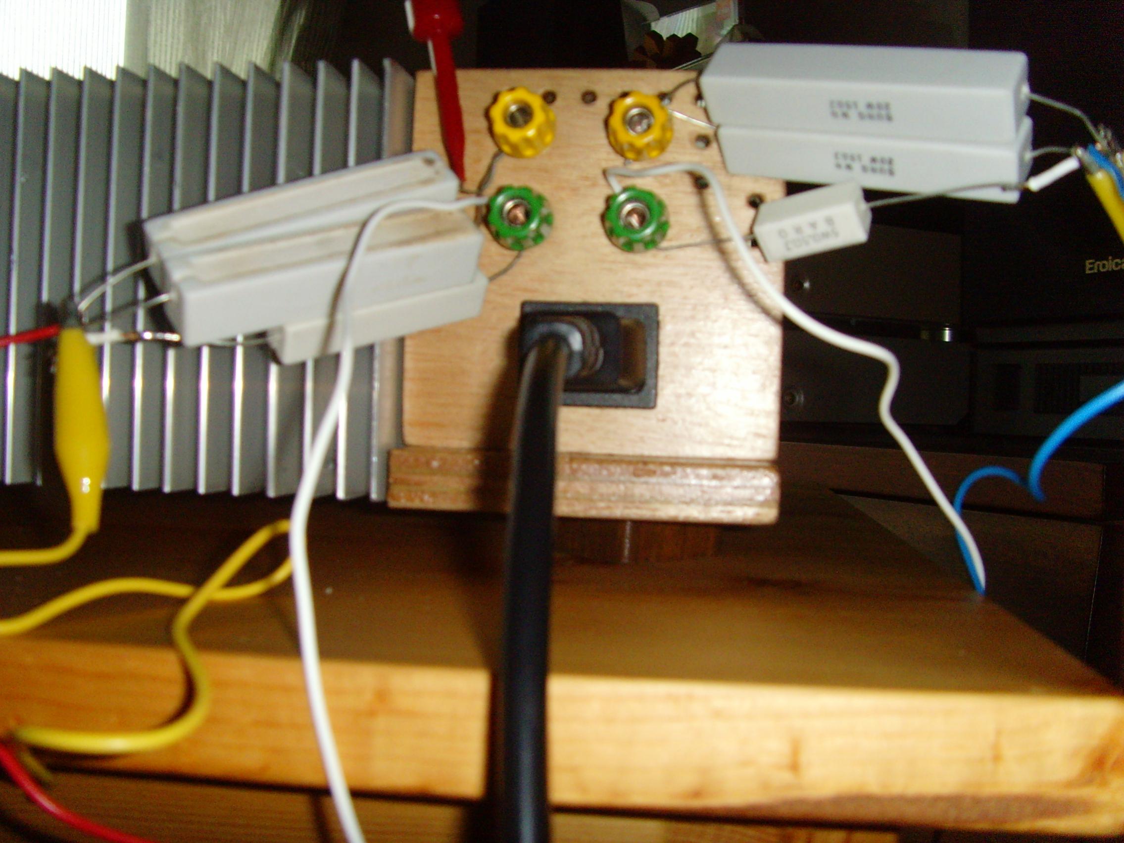

After one hour I could touch it continuously but after around two hours was able to touch it for maybe 10 sec or more. The AC voltage dropped from 31.5V unloaded to around 29V under 80W of load.
DC voltage was 41.5V unloaded and 34V loaded. Please note that there is a .5 ohm series resistor between the capacitor banks of the power supply, which causes the DC to drop additionally under load.
I think I need to make a sine wave test at some point, just to see how hot the whole thing gets.
You are right when you say that normal listening doesn't break an amp, even the worst party loading seldom does! And if it does, it mostly the output transistors that smoke and rarely the transformer....

Testing still ongoing
Thank you Carlos, your design seems to work well so far.
During the last week I did some load testing using a resistive divider consisting of two 15 ohm resistors in parallell and then in series with a 0.5 ohm resistor to ground. The speakers were connected across the 0.5 ohm resistors giving a reduction of the output voltage of 8 times or 24dB. Then I could drive the amp into clipping at a comfortable listening level. By using an old analog multimeter I found that clipping started around 8 volts, while the power supply dropped from 39 to 36 volts during this exercise. The 15ohm/20w load resistors got quite hot, but the heatsink stayed relatively cool.
More to come, stay tuned....

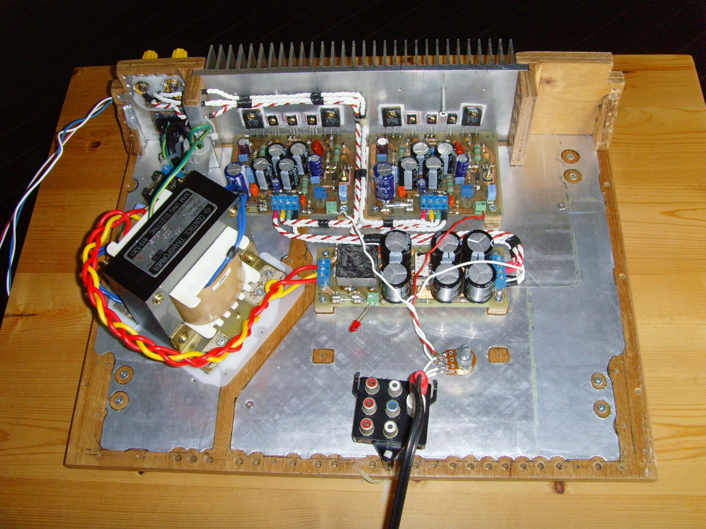

So far so good....
My DX-Trust has been playing happily in prototype mode for more than a month now. Finally I got the front panel with the controls in it attached and I am now testing the inputs, volume and balance controls. Only the CD (direct) input is working now, it seems like the the loss in the volume-balance pots is larger than expected, and the CD-player has some difficulties driving the amp to full volume.
But that will not a problem since a preamp (DOZ) is already planned. It will be useful for low input sources like tape recorders and tuners. A phono stage is also on the drawing board as well as a single knob tone tilt control. Also a loudness knob is included, but I am not satisfied with the performance and need to change the component values.
When listening carefully there is a faint hum audible in the woofers. When shorting the input connectors on the amp modules the hum goes away, so it must be injected through the input wires somehow. And when I switch the power off the hum disappears straight away even if the amp is still under power for ½-1 minute due to the large power supply capacitors. So I guess that the hum comes from the transformer or power supply itself.
I use twisted pairs (from ethernet cable) as signal wires, with the ground connected only at the one end, but maybe I should try to switch to properly shielded signal cables? Or it may be one of those dreaded ground loops again....? Anyway, it is not a big problem, and I believe it will be sorted out somehow.

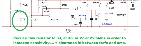

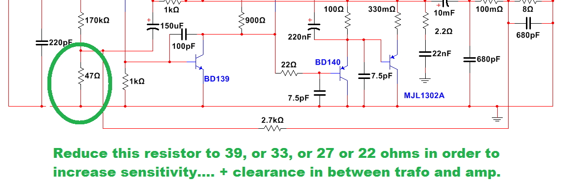

Your transformer is too much close, to much nearby the power amplifier input
Then you may have 60 hertz (your mains frequency) induced to the power amplifier input...clearance there is minimum of 5 inches.
As you have not room do that ...then install a stand by blade of metal (must be iron) in between the transformer and the power amplifier input...as a shield, alike a wall to separate power amplifier input and transformer.
Or transformer can be inside a case, covered by a metalic case alike a PC supply case...the metal must be grounded.
Increasing the sensitivity to allow your signal to drive the amplifier, will produce, as a result lots of induced hum...it is not a good idea to increase without fix, in advance, the issue of the nearby transformer.
Thank you by your picture...please inform your country to my registrations.... i know some Greeks, Croatians and Italians have assembled....i am interested to know more about builders of this vintage style amplifier

Nnx,
lot's of evidence of twisted pairs, well done.
These are good enough to cancel the fields from mains cables and/or transformers.
Your hum problem is almost certainly due to a ground loop, when you connect the other equipment.

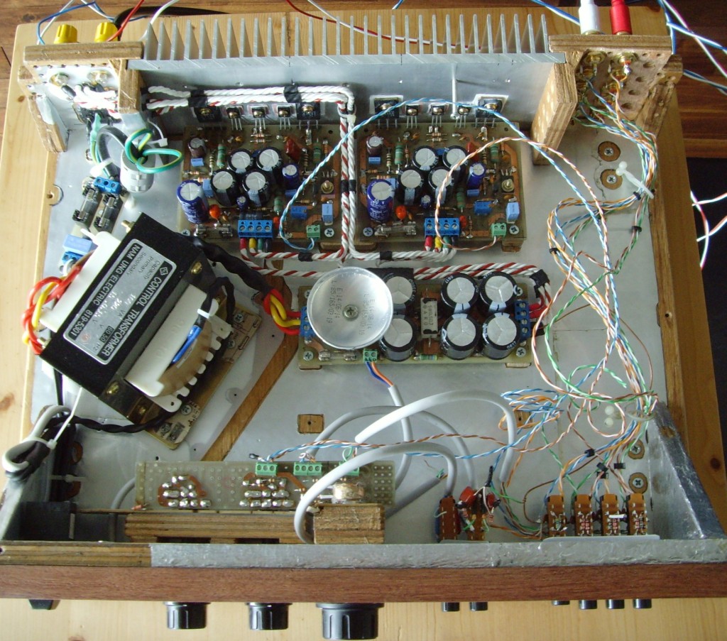

Gentlemen, thank you for your input, let me share some discoveries with you.
By moving the signal wires around it seems that the source for the hum is the magnetic field from the transformer. I then tried a thin coaxial cable on the left channel, but there was no improvement, except that the hum doesn't change when the coaxial cable is touched. Then I tried a RG-58 antenna wire, but again there seems to be no change, when moving the cable close to the transformer the hum increaser. Then I made a loop around the transformer and the hum got much louder.
It seems that the best route for the signal wire, regardless of type, is a large loop around the power supply module as shown on the photo. The difference between a twisted pair and a coaxial wire seems to be that the coaxial wire is not sensitive to capacitive interference, but both seem to pick magnetic interference equally well.
As Carlos suggested I tried to insert a piece of metal (tin can) in between the transformer and the amp-modules, but that didn't change anything. Maybe it was because the metal was only 0.2 mm and too thin to make any difference? A 1-2 mm thick plate would probably work better.
Other things to try are:
- Install a "belly strap" around the transformer.
- A thicker metal plate for shielding the transformer.
- Move signal wires around and experiment with ground connections.
- Replace twisted pairs with coaxial if/where needed.
This hum is not a big problem anyway and only audible when the house is quiet up to maximum 1 meter from the speakers. However, I will not dare to increase the gain before it is solved.
Otherwise the amplifier works really well, nice and clean compared to the old Sony it is replacing and with more power than needed for my use. It is a great pleasure to be able to listen good music through a DIY device.... 🙂 And by the way, it resides in Korea at the moment, where parts are cheap and amps seem to have their volume knob stuck at max, sorry that I forgot to add country.
