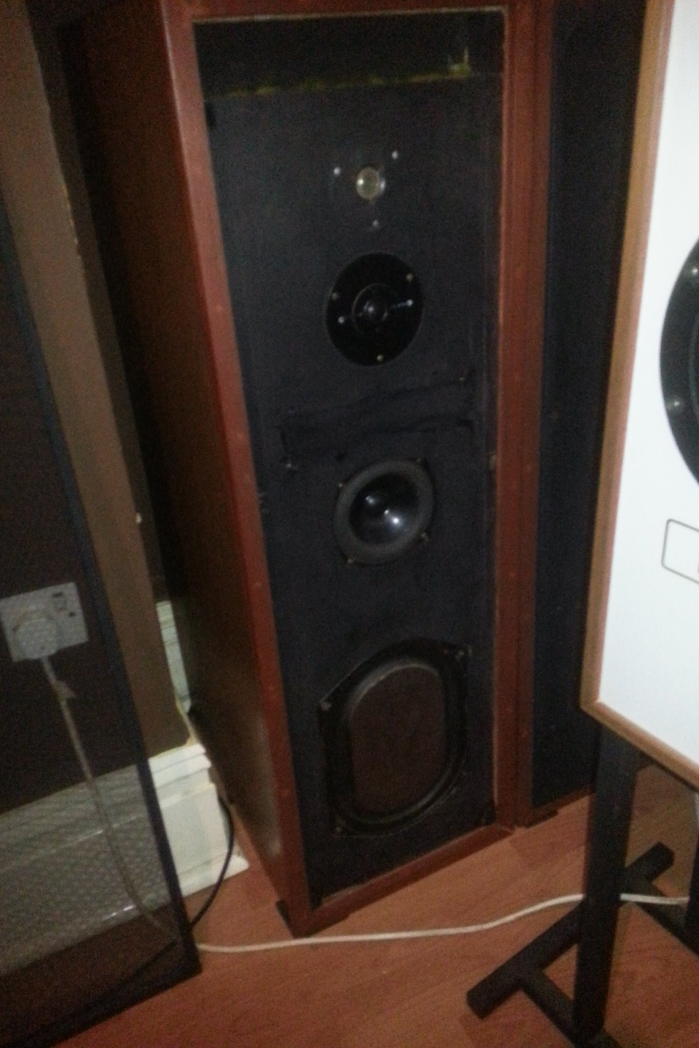

Is the TL exit in the middle or at the top?
I seem to recall mine had the exit in the middle, but very very similar to your photo there!
Should I ignore the wires that have been connected together up in the ST/T/M area, I believe there is 16ohm ST/4ohm T and 8ohm mid?
I can't make head nor tail of the bird's nest of wiring up there.
I'd remove from the drivers all wires that don't correspond to the original colour coding on the crossover board.
Then extend each coloured wire on the crossover board to where we think it should go. Test the speaker, but preferably with a spare amplifier.
You will have to ignore the different impedances of the drivers, at least for now.
The TL exit is at the top and the mid exit in its own chamber is the one that is near it, not full width of the speakerIs the TL exit in the middle or at the top?
I'd connect them with crocodile clips until the polarity is confirmed. Spade connectors could be attached to the wires if you feel you may revisit the crossover in the future.

1 observation no, 2 points to mention is on #46 last pic next to the cap is a hole that has underneath a solder blob and nothing is connected to it. I feel something has been changed ther..also as an add on in pic #44 the pink wire is soldered to the bord but has s wire bridge from one to the other side. .on the board above green and brown is the number 16??

It's all you can do under the circumstances. It will be interesting to see if you get all the drivers working or just some.
We don't know what the previous owner was up to in terms of wiring up and possible replacement of certain drivers.
I would work on only one of the speaker pairs at this stage till we see what happens.
P.S. I had spotted the wire link you mention. I trust AllenB also noticed it.

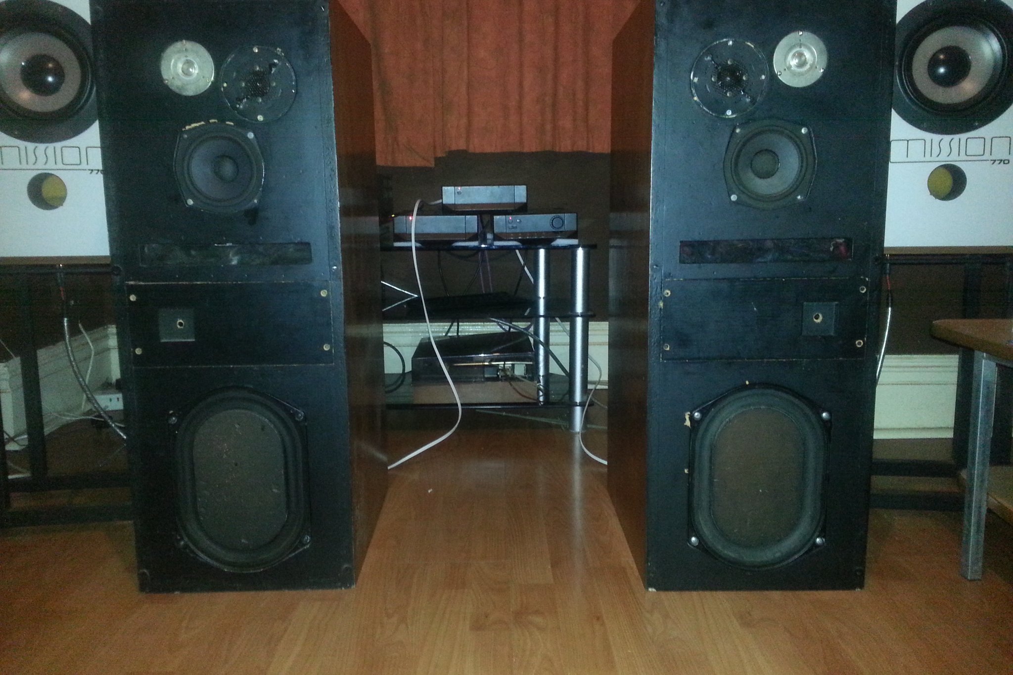

I connected speaker 1.....and all drivers work. Looking at speaker 2 I noticed that the tweeter had 3 holes and not 4 needed for the seas H086! The change was a tweeter maybe T27 to H086.
Well, that is a result!
How does the overall sound of the speaker grab you?

Thsy sound great even being so close together and me not no more than 2 meters away. Sound stage is wide and quite roomy/deep. I haven't pit my cones under them yet so I was expecting bass to be boomy but no it was in control. The mids well "whaw" vocals and guitars sing and have that presence of emotion. I listened to lenny kravitz "sister" and led zep "since I've been loving you"
