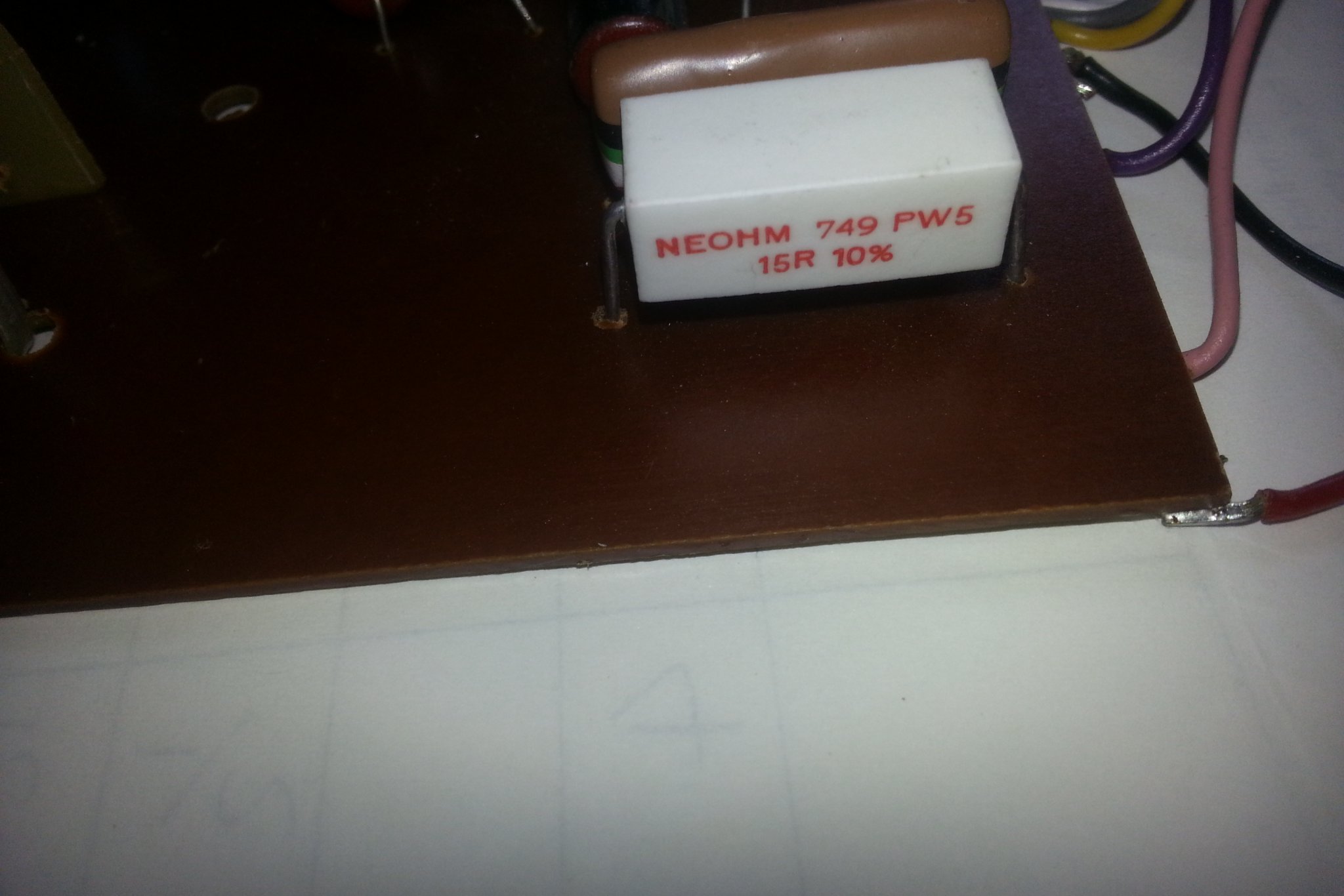

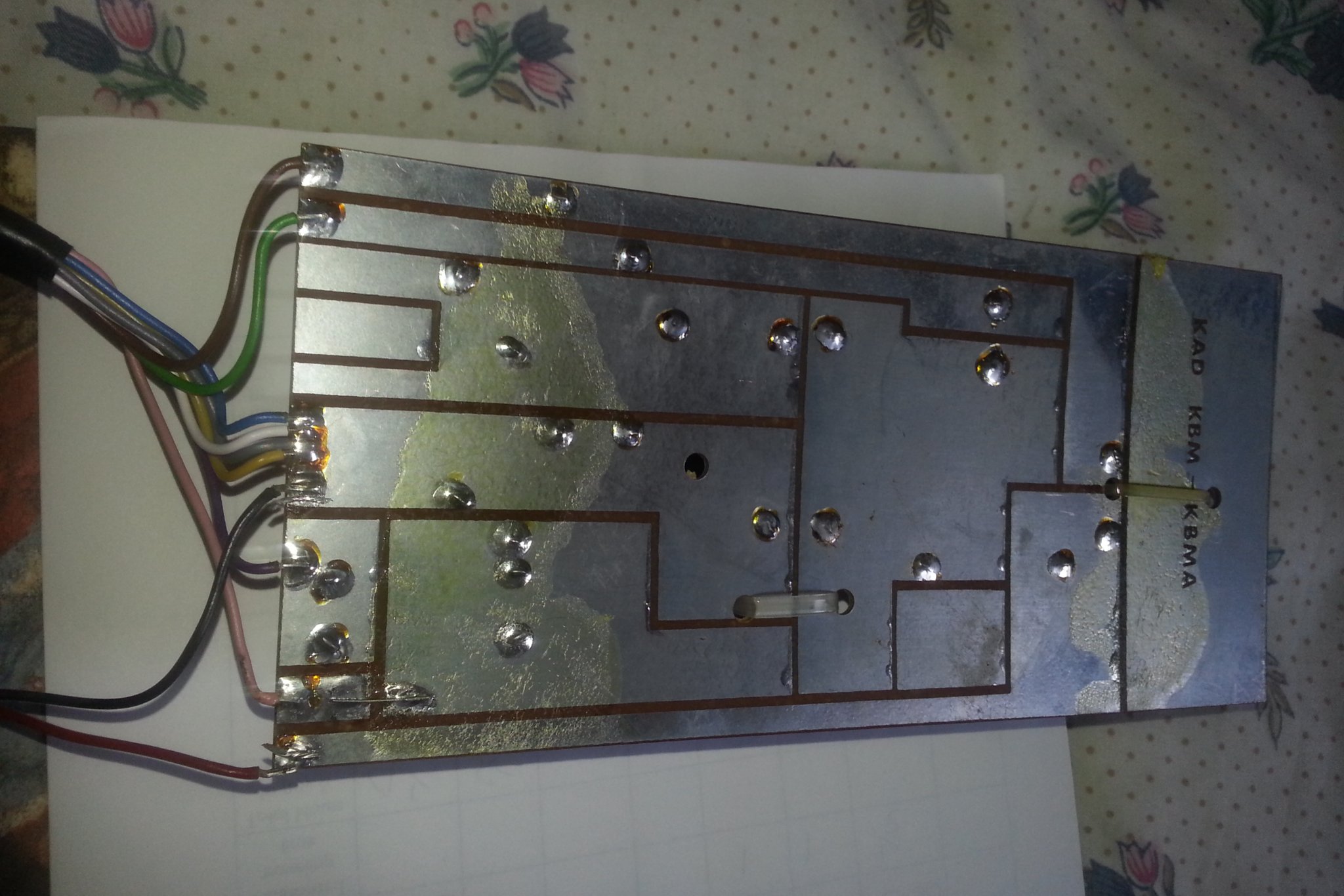

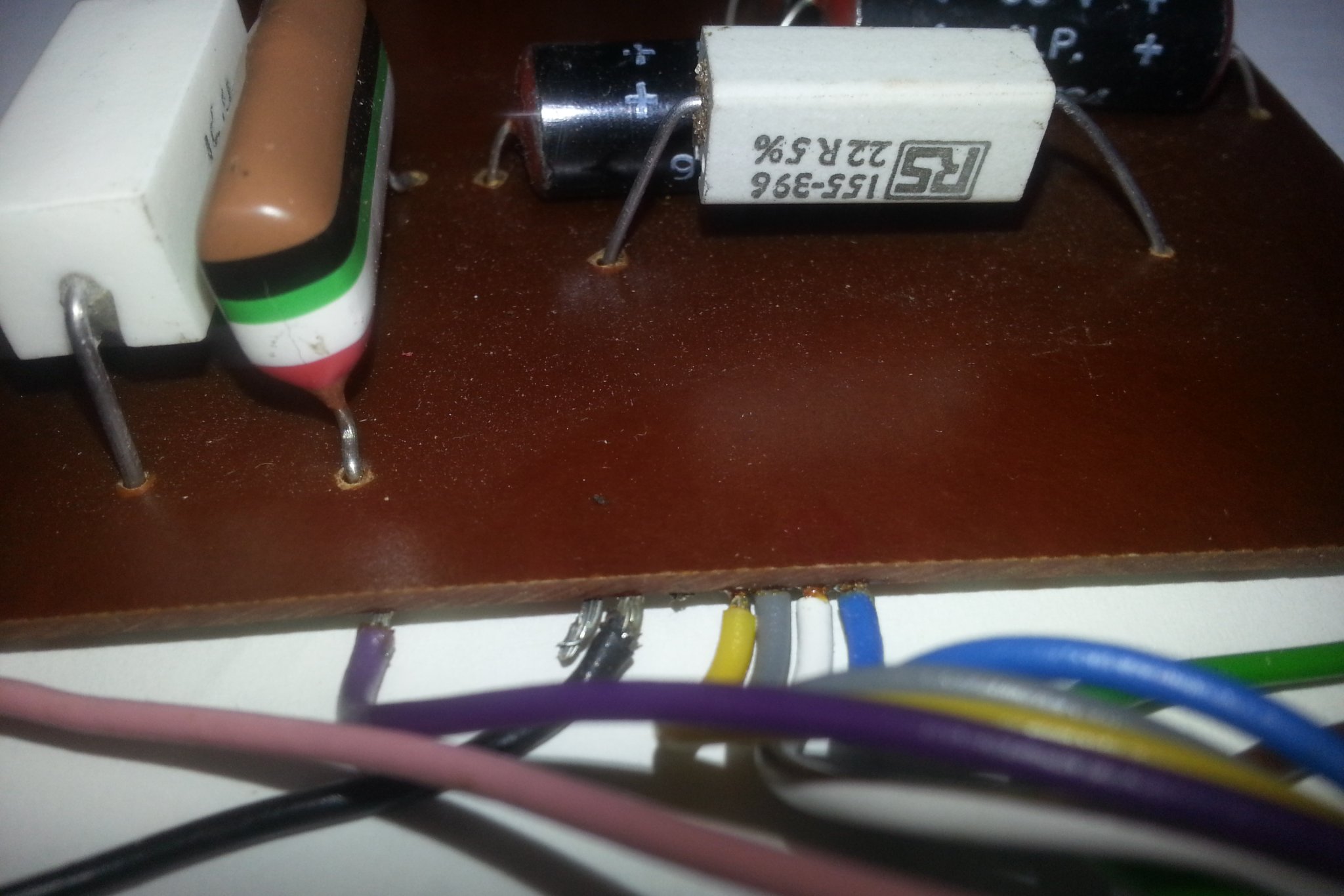

The question is, to where should each of the crossover board's coloured wires be connected, i.e., which wire goes to which driver and to which of its terminals?
We may be close to figuring out that physical aspect of the wiring.
Red/Black is amp in.
Purple ST+
Pink T+
Green M+
Brown W+
Blue/White/Grey/Yellow -
In addition to this, polarities should be considered. As a starting point, perhaps consider reversing the mid.. but spend some time listening before deciding.
Purple ST+
Pink T+
Green M+
Brown W+

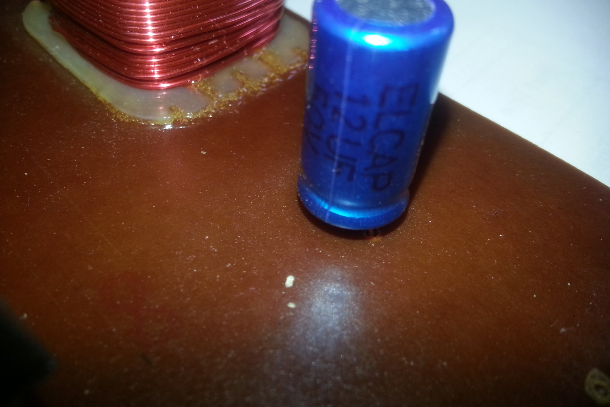

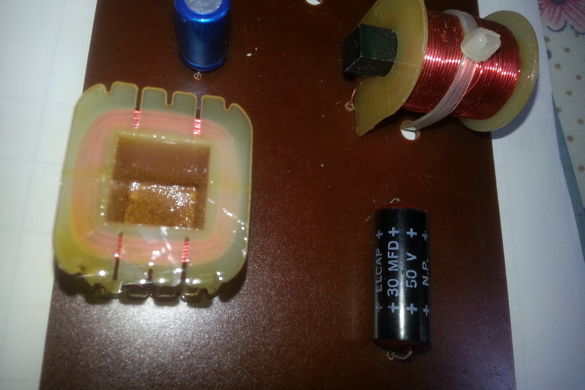

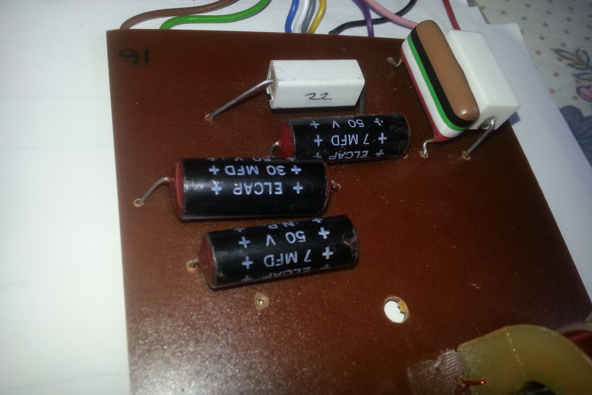

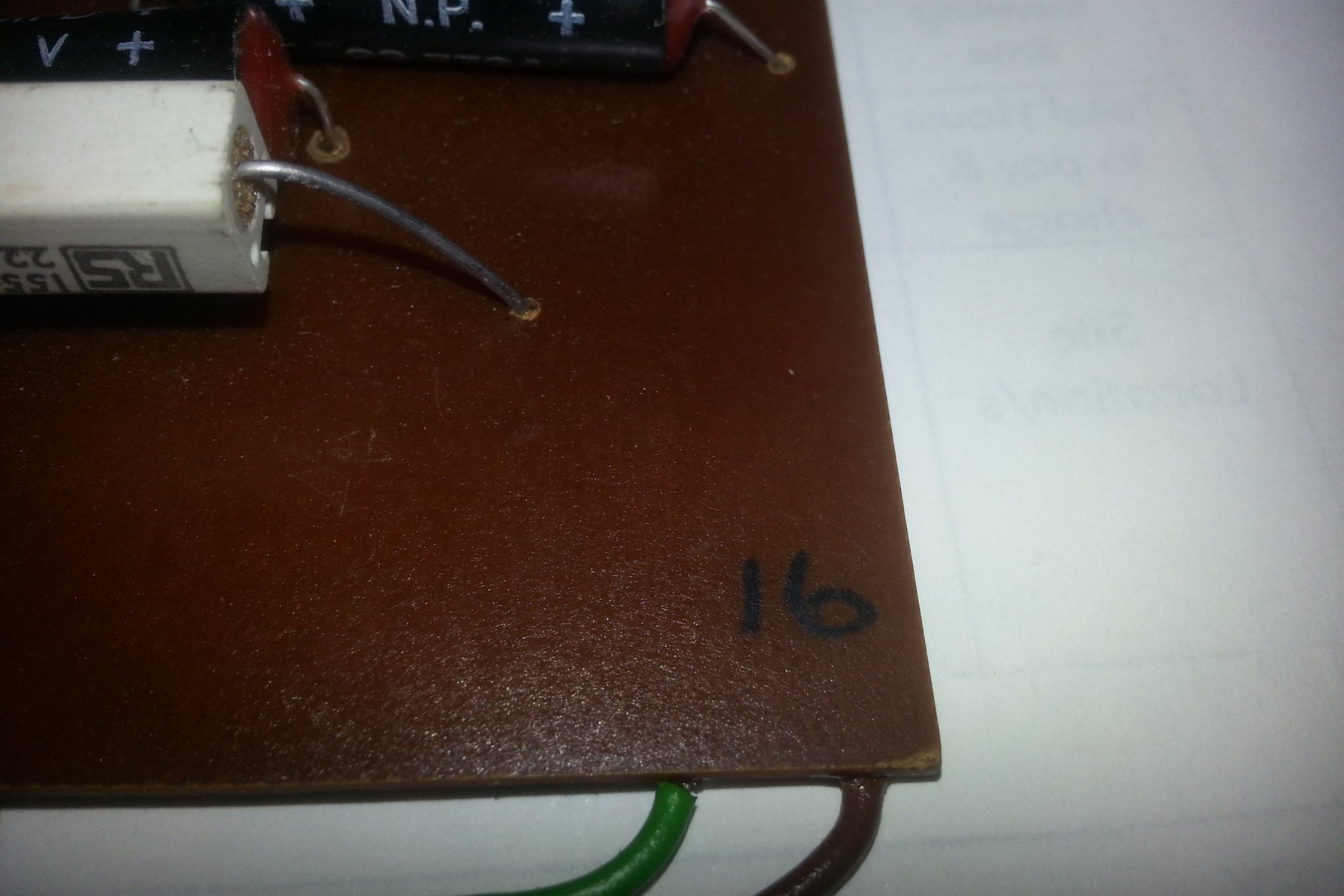

Very good. I'm taking the film capacitor to be 1u5F. I guessed the 12u was 50u. The inductors are not known.

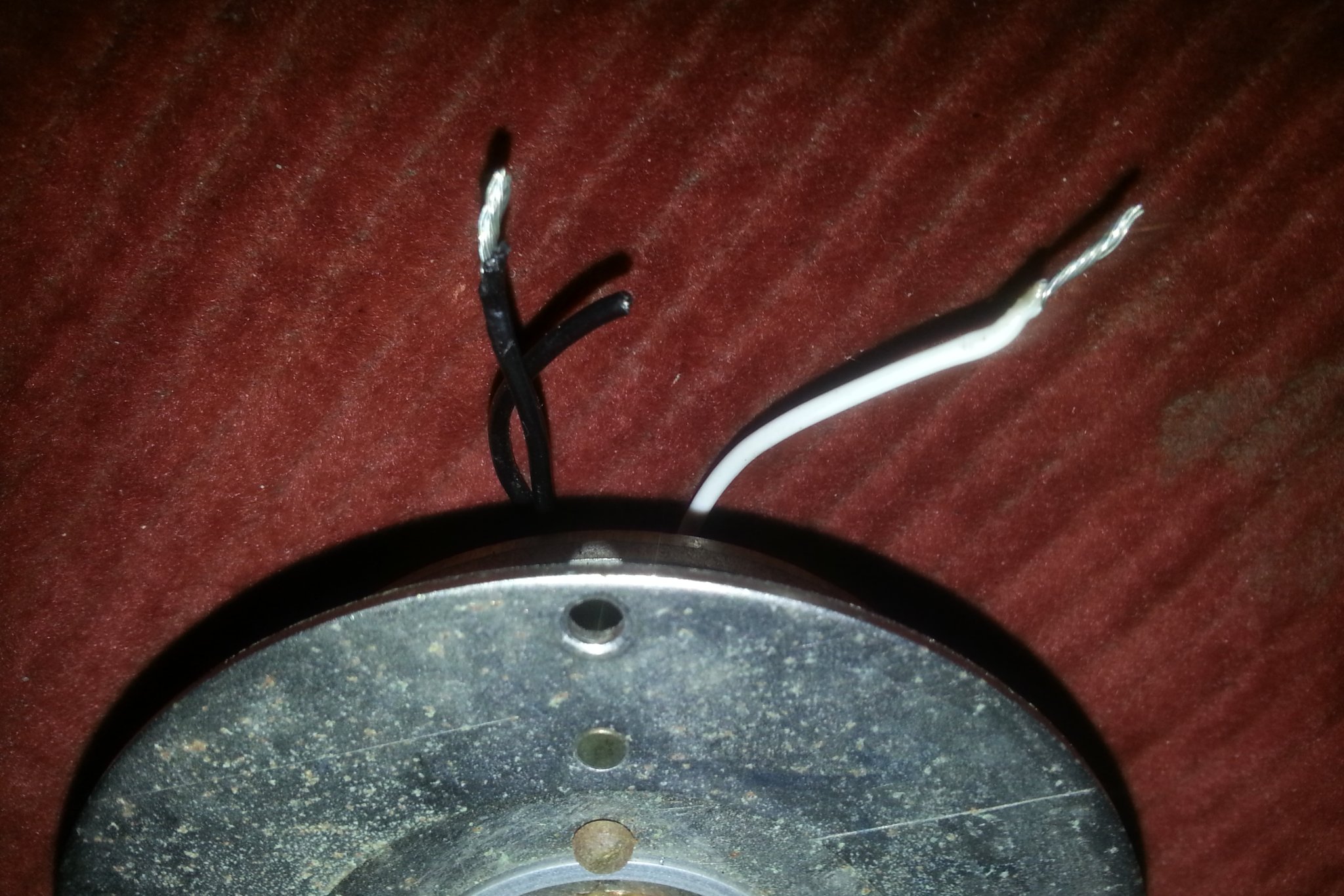

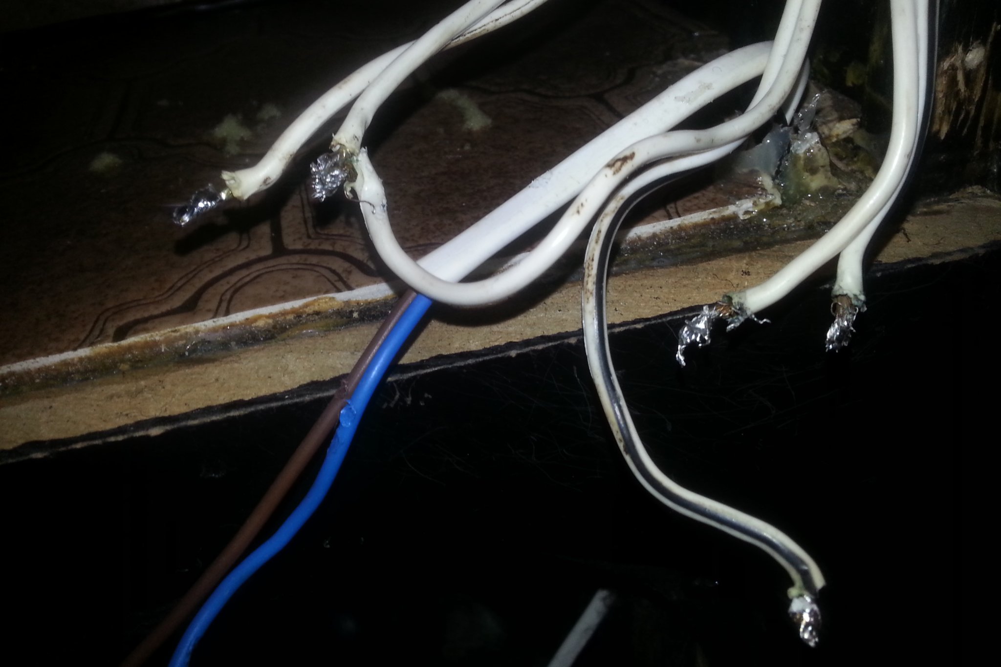

Thanks everyone for your help. What do I do with the wires that have been connected together eg the 2 from the coles and the 2 white ones in the box

I would be inclined to remove all the wires apart from the bundle of coloured wires soldered to the circuit board. Then I would extend each of those coloured wires to its appropriate location as indicated in post #42. You will require to identify the positive terminal (usually marked red or with a + sign) on each driver. Further modifications may be necessary upon actually listening to the rewired speakers.
P.S. To avoid confusion, I suggest you refer to the drivers by their initial letters as follows:
ST (super tweeter)
T (tweeter)
M (midrange)
W (woofer)

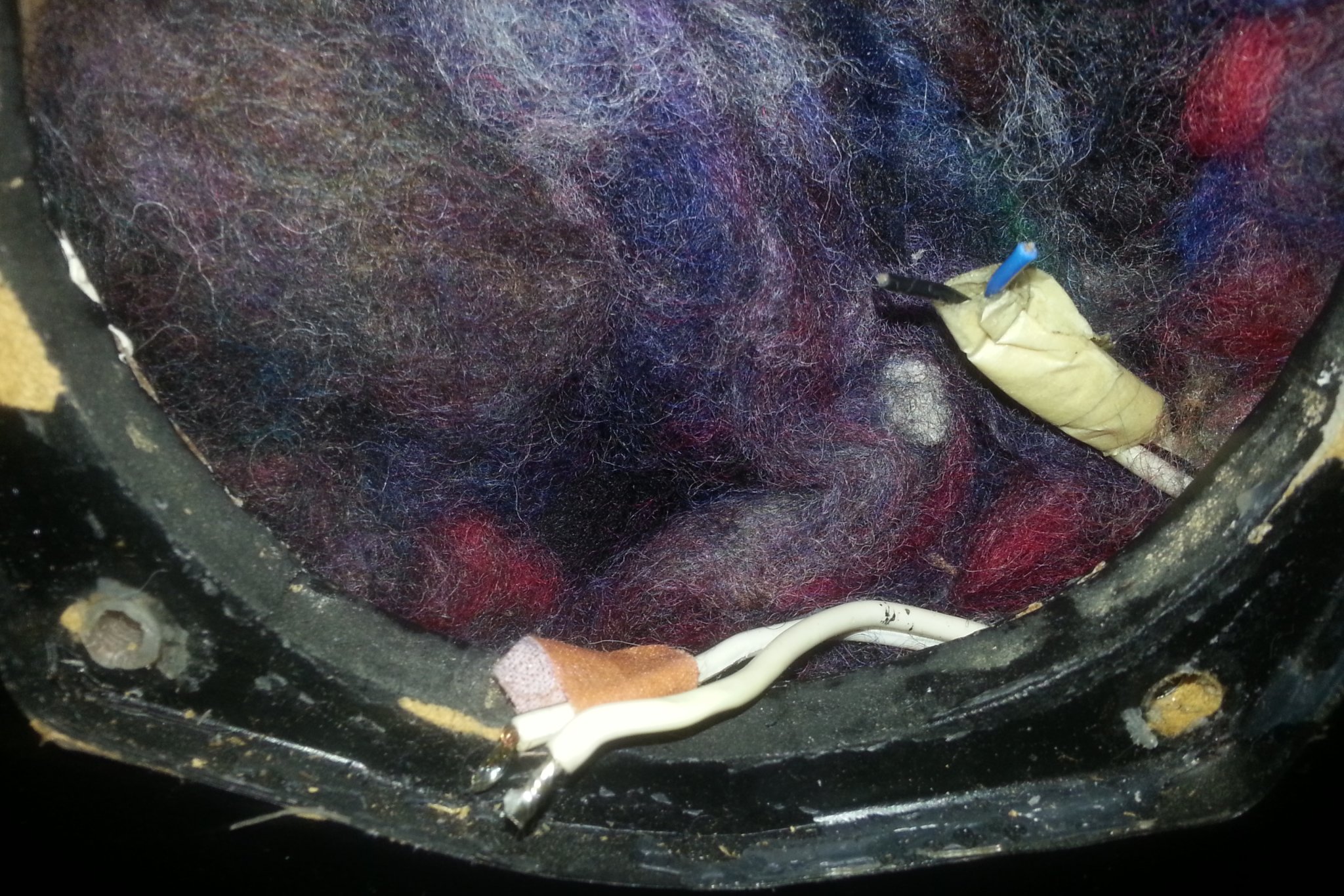

Should I ignore the wires that have been connected together up in the ST/T/M area, I believe there is 16ohm ST/4ohm T and 8ohm mid?View attachment 1309709
ST (super tweeter)
T (tweeter)
M (midrange)
W (woofer)

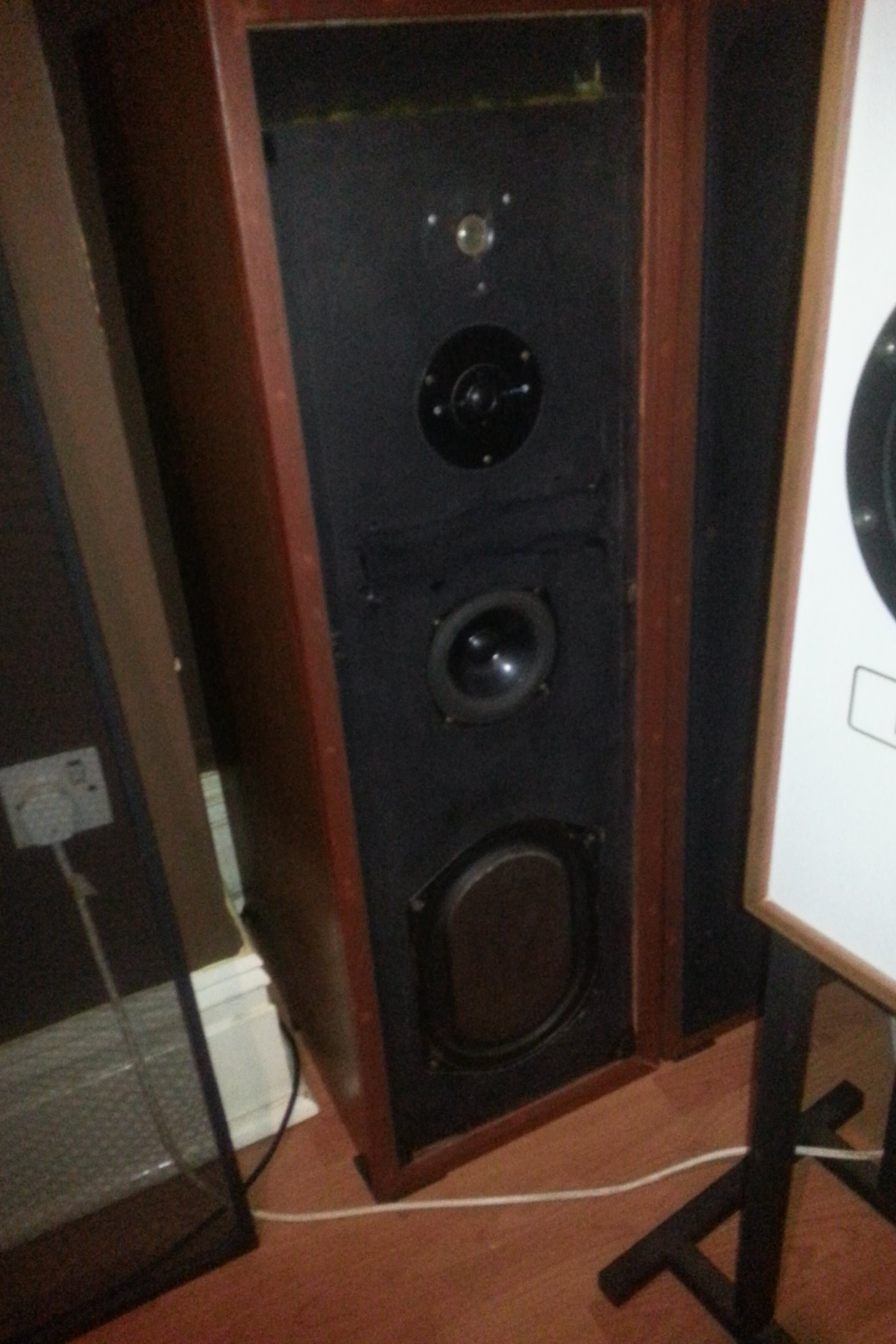

- Transmission line speakers I have never seen before. Need help to figure every thing out
