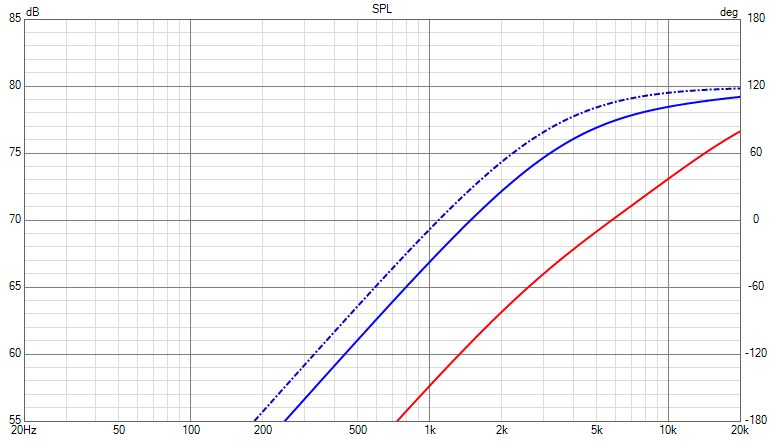

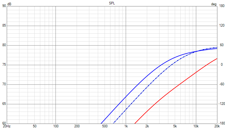

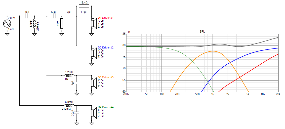

I don't think I understand either but let me show you some examples. Firstly understand that I'm using generic drivers for the simulation, so if the ST is louder than the T or has a different response, all this sim will show are the changes between circuits.. however that's all I'm really trying to show.
So, firstly we have T=blue and ST=red. If you disconnect the ST, the T gets louder on it's own (dotted trace)..
Now reconnect it. If you then connect ST+ to T+, they will each have the same drive signal and will both jump to the dotted trace.. ie T will get more quiet and ST will get more loud..
If you disconnect ST and connect the + together, nothing will happen.

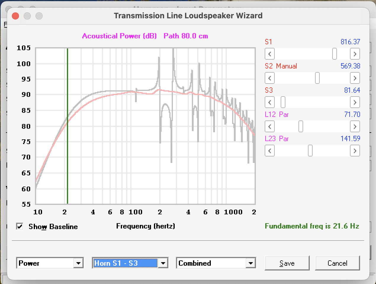

You are not restoring the damping to the designed amount but removing whatever you can reach? Assuming the speaker was correctly designed and built initially this will alter the low frequency response away from design and increase the level of the lowest few line resonances. This will introduce an audible change but it is unlikely to be for the better unless the line was incorrectly stuffed. A degree of this is what happens when lightly stuffed wool settles.
Details of the line geometry are unlikely to be useful but measuring the response would be if you want to experiment with the degree of stuffing. A simple simulation program like this might help understand what is being traded for what as the degree of stuffing is altered and hence what to look for in the measurements.
The damping could well have sagged… in whichcase you need to remove and replace it. More damping will do more to suppress the unwanted harmonics of the pipe, less will allow for more fundemental and more ripple from the harmonics since the only extra LP filter is the pre-chamber and the ones at each bend (if there are no deflectors). The taper of the line pushes the harmonics up in frequency, making them easier to damp — and leading to the myth that teh damping slows the speed of sound.
And most of th eoffending ripple will be be below the Schroeder Frequency which complicates just listening.
Without removing a side there are parts of the line you wll not be able to get at some of the line … maybe a robotic snake-tool?

should be quite capable--using the default settings pretty much, some polyfill to dampen the ripples, taking advantage of tapering the line a bit more than in the original plans. I never measured my old ones, but I recall they performed pretty well for the time. The new b139s might perform better but I haven't seen the specs.
