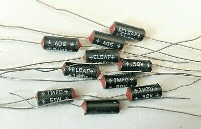

I would consider replacing the ELCAP capacitors as their capacitance values may have changed significantly since 1979.
I mean the ones that look like this:
If you have a multimeter (and no speaker renovator should be without one!) which includes a capacitance scale, you could always check whether any have drifted in value or not.
I recommend Mundorf ECaps as replacements: https://wilmslowaudio.co.uk/mundorf-electrolytic-ecap-capacitors
Unfortunately, I'm neither in the position to upgrade the crossover design nor to comment on replacement drivers.
