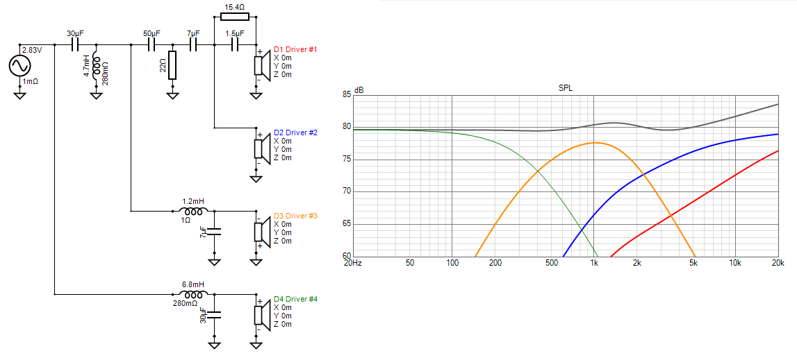

Dave, the area that is inside has a labyrinth so it is a tl I just haven't drawn it, plus the weight and dimensions. The dimensions are exactly the same apart from height as my Pro9's mk1

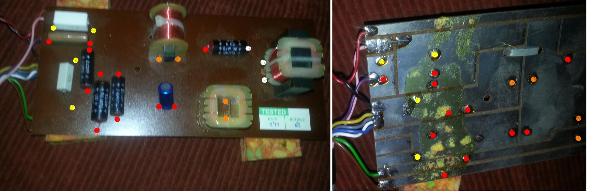

I will take pictures of the crossover and trace pictures to the wiers and drivers showing which have been connected together by series/parallel ? What ever its been.
How do I get the 4ohm seas tweeter and the 16ohm coles connected
Having your circuit board image translated into a schematic would help in identifying where each of the attached coloured wires should go.
That's not easy to do from a distance. You are in the best position to try tracing out the schematic as you actually have the board in your hands. The members here will be good at rectifying any mistakes you make.
The dimensions and construction details of the enclosure are simply a distraction so forget about that aspect of your loudspeakers for now.

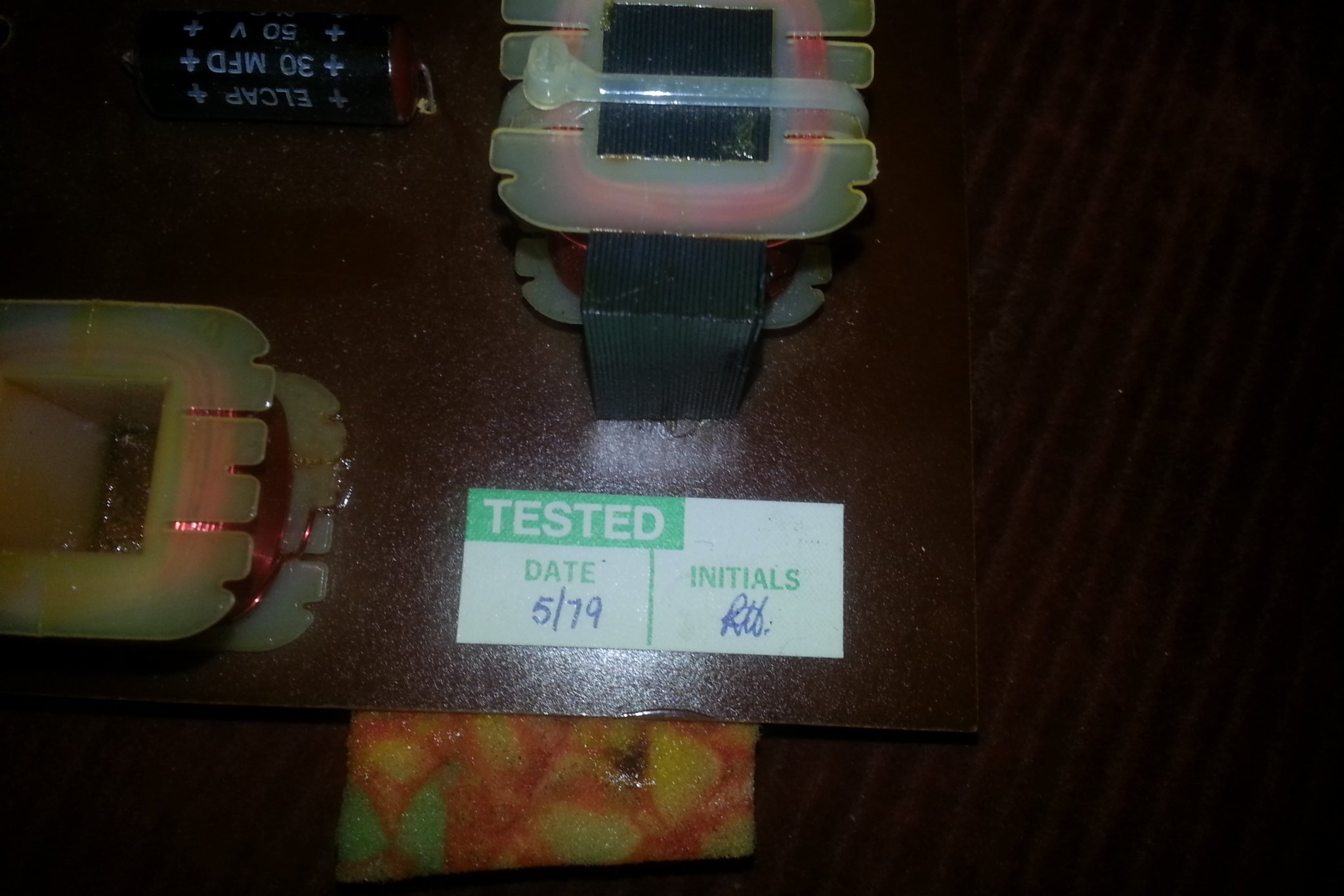

You can supply us with more information by listing the values marked on the capacitors (in order from left to right).
Take a Sharpie and draw in where the components on the other side are. That will make it easier to suss out.

In the UK Falcon Acoustics was the producer of many x/o board in the seventies until the mid eighties, when it went belly up, so my pre-paid order of "improved" IMF TLS 80 boards ended up in the Receivers pockets. But I got a nice letter from that Receiver...So this may well be a Falcon board.
That is the time Wilmslow more or less took hold of the diy scene.
