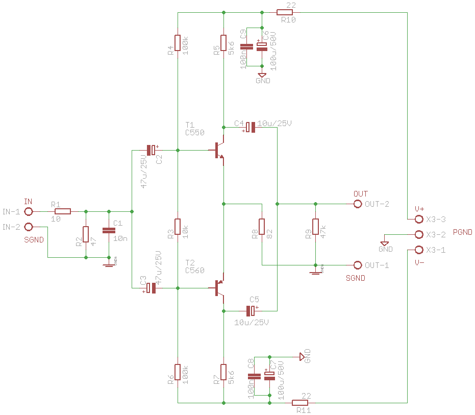

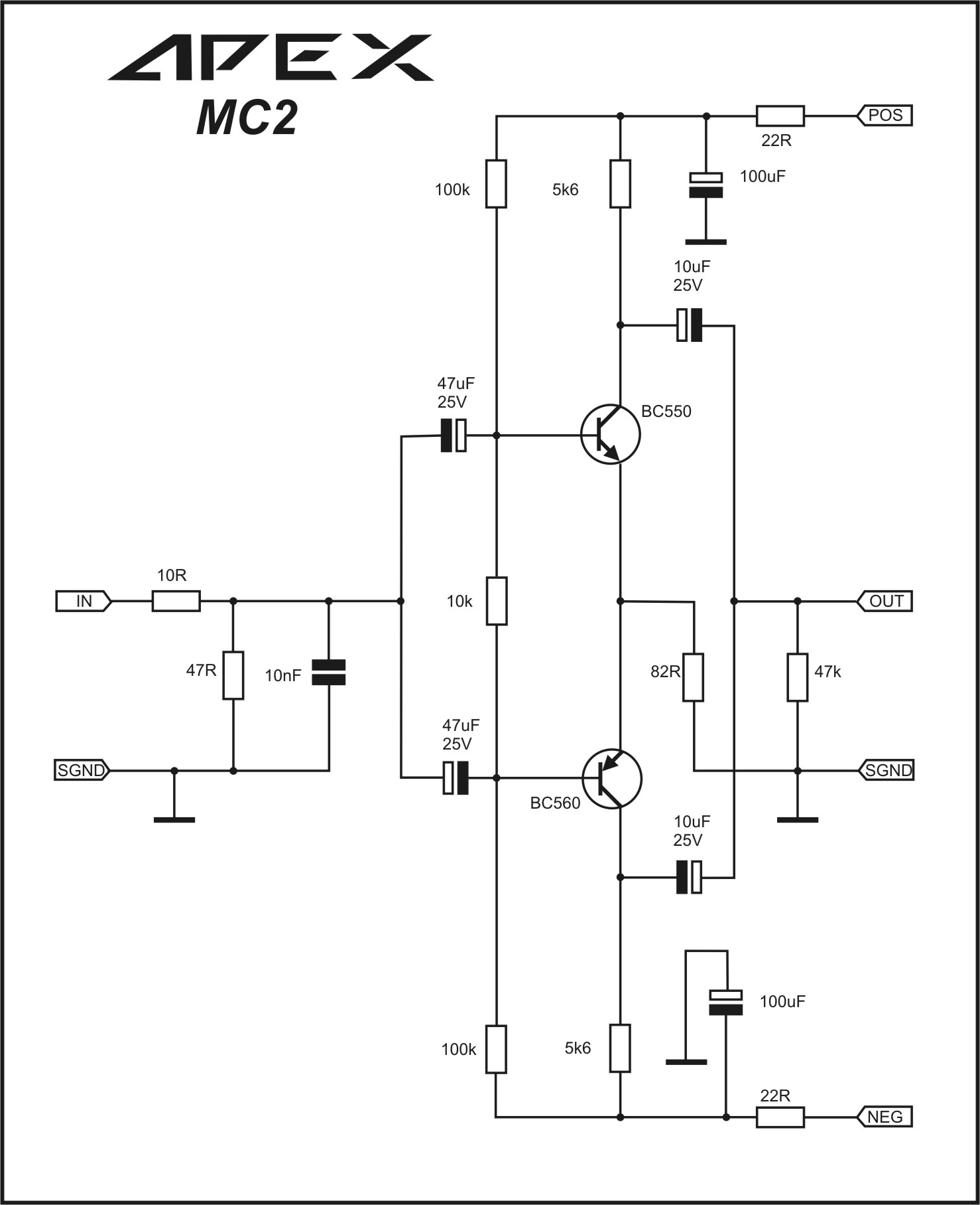

The poor performance shown by the LTSpice simulation pretty much ends the discussion. If you know a bit about analogue circuit design, you don't even need an LTSpice simulation to see the problem - it's pretty plain to see from a look at the circuit diagram.
You raised some points worthy of discussion, so let's discuss them a bit:
*) It's a pre-amp; why should it have low output impedance?
The answer is in three parts. First, the performance of the preamp should be dependable, with a reasonable load connected. If the output impedance is extremely high, this requirement cannot be met; open-loop gain, and therefore distortion and bandwidth, vary drastically with the load connected.
Second, a preamp may be called upon to drive a shielded cable. Shielded cables have significant capacitance (typically 30 pF per foot). The cable capacitance creates a low-pass filter with the preamps output impedance. Therefore, in order to ensure that the preamp performs and has adequate bandwidth properly even when connected to a cable of reasonable length, it has to have low output impedance.
Third, shielded cables have imperfect shielding. Some electrical noise and interference will make it through the shield, and arrive at the central conductor, where it will corrupt the audio signal. If the preamp has a low output impedance, it shunts (shorts out) most of this noise; a low preamp output impedance therefore reduces the amount of noise and interference that shows up at the far end of the cable.
These three reasons are so important that every preamp made for professional audio use has a very low output impedance. A hundred ohms or less isn't unusual.
By contrast, the Apex preamp we're discussing actually has an open-loop output impedance of tens of thousands of ohms, or even hundreds of thousands of ohms, depending on output admittance (hoe) of the output devices; when the 3.3k feedback resistor is added, it actually shunts the output, and therefore drops the output impedance to about 3.3k.
Because the raw output impedance is so absurdly high, the loading from the 3.3k feedback resistor is enough to drop the open loop gain considerably. This preamp has such a high output impedance that it actually loses much of its potential performance simply from trying to drive its own negative feedback network!
You can prove this for yourself: grab the LTSpice simulation file I attached to my previous post, load it up in LTSpice, change the 3.3k feedback resistor to 220k, and watch the open loop gain leap from a rather meagre 1200 to a much more reasonable 11,000.
Think about that for a second - this preamp can't even drive its own feedback resistor without suffering drastic performance loss! Does that really seem reasonable to anyone?

Gnobuddy, you still make the same mistake in the output impedance calculation.
Do you realize the difference between loading the output with 3.3K resistor, connected to ground and 3.3K resistor connected to the negative feedback junction point?
In the latter case, you have to additionally divide it by the value, the loop gain would have had if the load had been open circuited.
The resulting value of roughly 10 ohms (at 1KHz) is more than enough for driving the power amp's input even through some rather long cable.
It will increase with frequency though, being still ok within 20KHz bandwidth.
You can easily "measure" it in your simulation:
- see RMS at the output with no external load (V);
- see RMS with R load, connected to the output (VL);
- calculate your output impedance.
Zout = R * (V / VL -1)
One more thing - in your assessment, you omit the phase response considerations completely. Increasing the feedback network's impedance for almost 2 orders (220K instead of 3.3K), you will have some phase-related issues to be addressed. Guess why.

Exactly as you so, the very high fb factor in this elegant design reduces the output impedance to the target amp input node to very low levels.

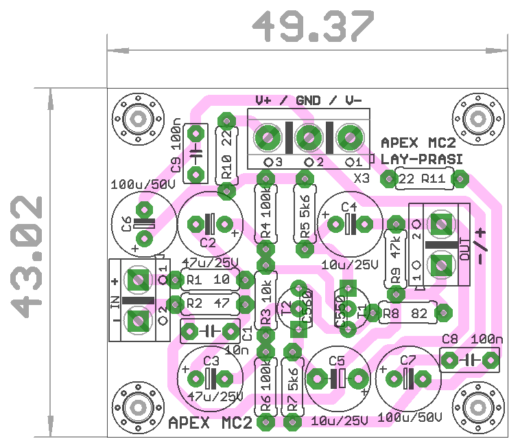

I actually do use and trust models and simulations in case someone is wondering why I don't take Gno's assessment that the Apex circuit that I built sucks. I generally model speakers (horns, TL's, etc) in Akabak before building. But like all simulations, they depend on the quality/accuracy of the system being modeled and the assumptions used. A couple of amps in this forum, I have used models to guide me to show that collector driven latFET gates can be used to drive vertical MOSFET gates very well. Then I am lucky enough to have someone design the layout, then I fab PCB's and then build and test. A couple of these amps (FH9HV and CFH7) are some of the best I have heard and there is some agreement by others that they do indeed work and sound great. I would not have bothered to ask someone to design a layout and then make 10 PCB's without aid of the simulation to say it would work. So I am all for SPICE models - when interpreted/used correctly to see if a design could work.
I am always open to learning and appreciate the time and effort you and others like Valery put into this forum to teach folks like me who are just starting out. I did not start building a discrete amp until March of this year, now a dozen amps later, I am still always learning. I will build a sim of this preamp - and look at how Valery showed to test output impedance.
A bit of arithmetic:
Suppose the load is 20 feet of cable @ 30pF per foot, plus 100pF of capacitance at the power amp input.
Suppose the preamp's output impedance is 3.3K ohms.
Then the -3dB corner frequency of Zout*Cout is simply
f_corner = 1 / (2 * pi * Zout * Cout)
f_corner = 1 / (6.283 * 3300 * 7.0e-10)
f_corner = 69 kHz
If we reduce the preamp's output impedance by a factor of ten, giving Zout = 330 ohms, then f_corner rises by a factor of ten, becoming f_corner = 690 kHz.
Choose the f_corner you want, calculate the Zout it requires, and then design your preamp with that output impedance (or lower). It's just arithmetic.

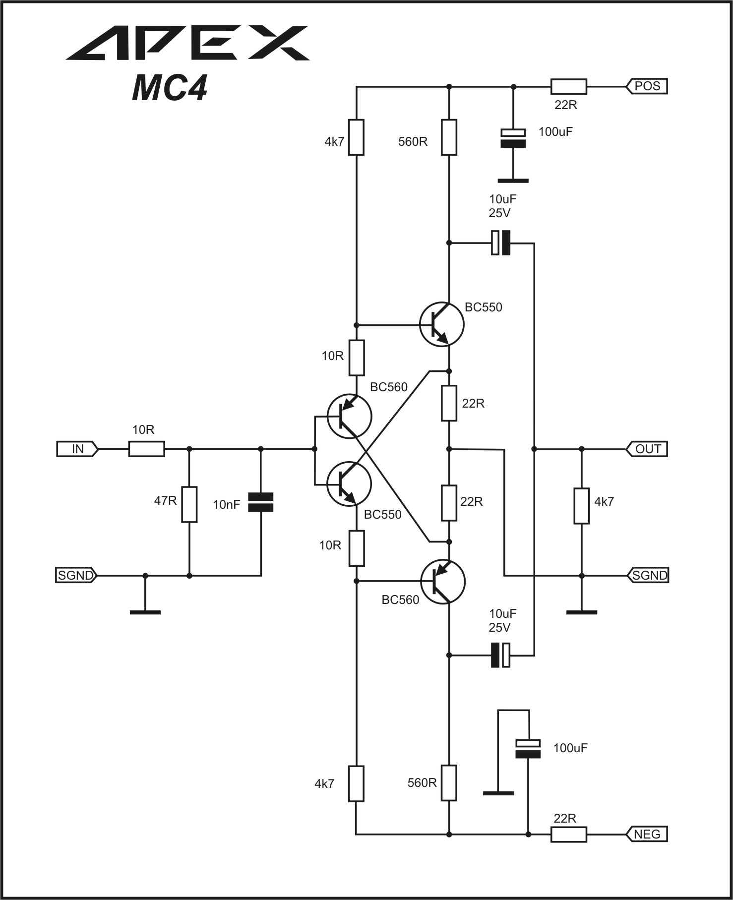

I like stupid preamps 🙂
