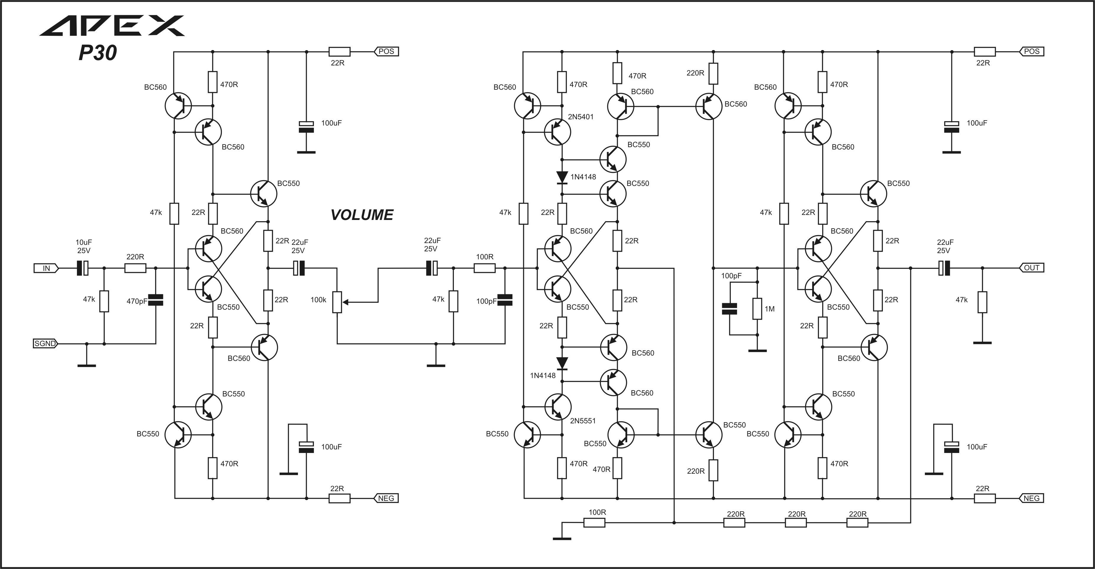

Both Damir's GainWire and my AmpliWire utilize current-driven VAS stage and no Miller caps in compensation scheme. I like this approach, showing excellent sonic performance.
So I assume your design below uses the same current-driven VAS stage and no Miller caps since it's like the AmpliWire with an extra set of outputs?
I'm currently waiting on boards for it.
Looking forward to building it and Bimo's circuit since both are relatively easy to build.

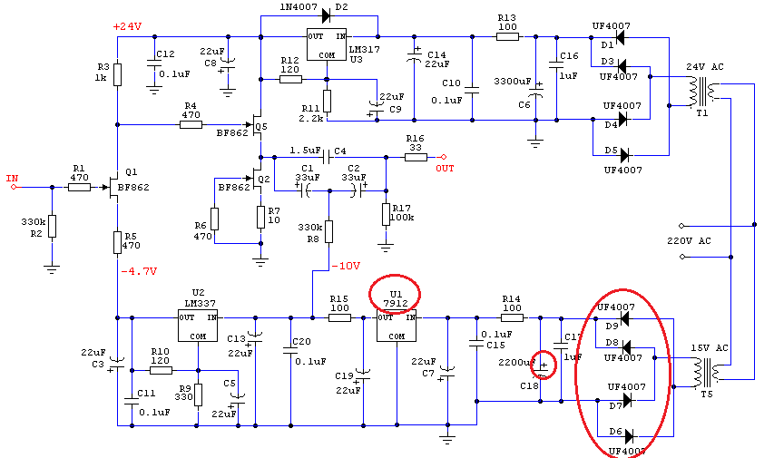

Max, the rectifier is correct; positive rail has two katods, and negative rail has two anodes. 7912, hmmm, is that a 7812?
HD
HD

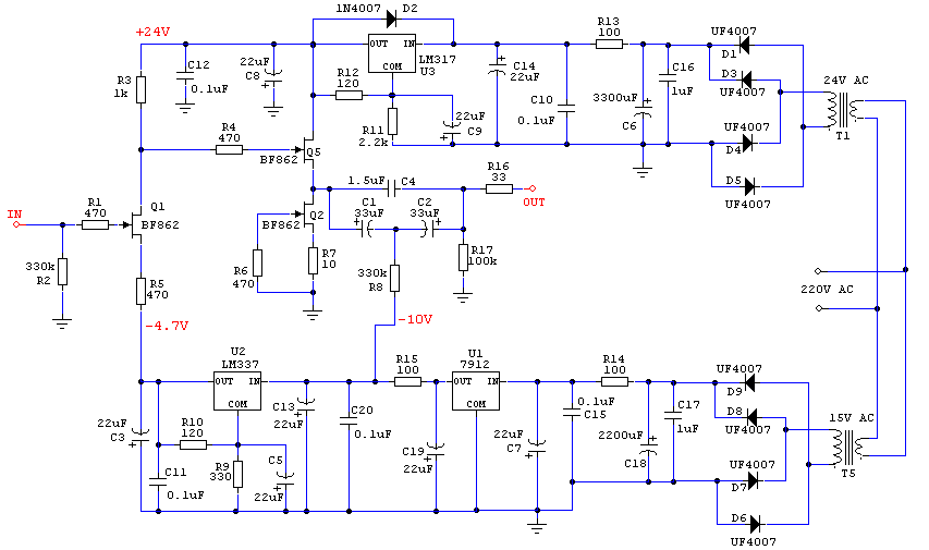

I was looking at the original thread. AndrewT had already pointed that mistake. A copy and paste without checking. That is a negative supply with 7912. Capacitor and diodes are really inverted. An updated schematic has been posted below in the thread.
