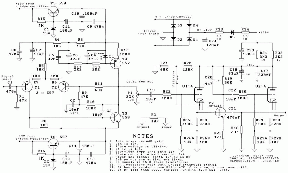

Thiago,
Here's one from 2002. I sold quite a few. This uses a SS gain block and tube cathode follower output, with Zout around 130R. Sounds very, very good.
In 2010 I redesigned the SS section to use a CFP with gain. It actually sounded much better.
Hugh

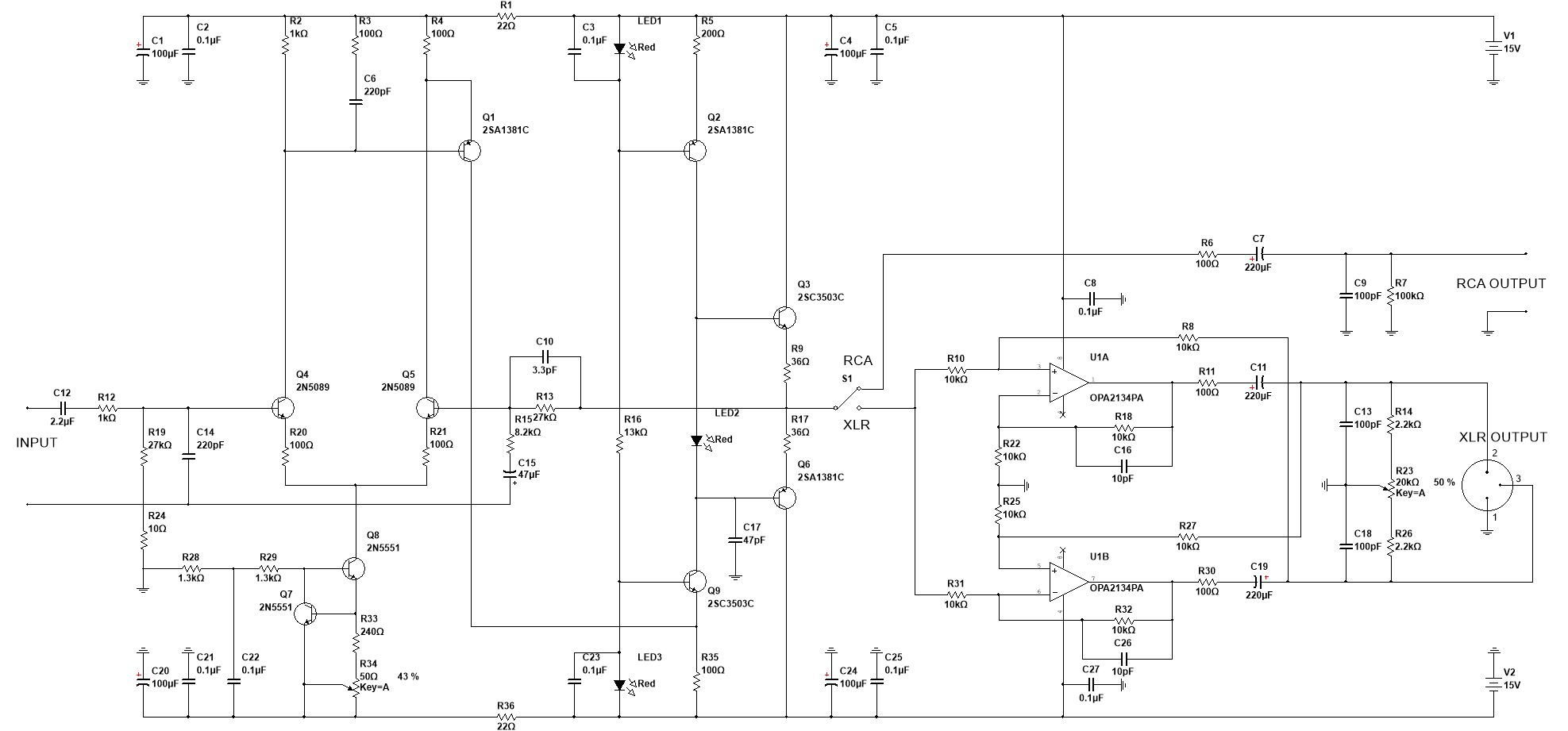

VHex-Pre
Hello all!
Here is my view on the overall preamp solution, including the line stage with 12db gain and optional unity gain balanced line driver.
Note - it's very, very quiet. Noise is below any practical level - with the input shorted, you hear nothing (better than -110db).
The circuit is powered from +/-15V DC rails.
We will most likely come up with the layout for the whole thing pretty soon.
Valery

Hi Hugh,
I like the tube section.
I assume, V2 is buffering inverted signal for the balanced output, right?

Hi Valery,
I might disappoint you!
No, this is unbalanced output. The inverter and CF is set up to compensate the high impedance B+ supply to ensure seggtrong bass output that was atypical for a tube. The tube was a variable frame grid 6ES8 which added extra H2 / H3 for a cathode follower.
HD

Hello all!
Valery
Hi Valery,
This looks like the revised Ampliwire with the op-amp balanced circuit added to it.
Is this correct?
Thanks.

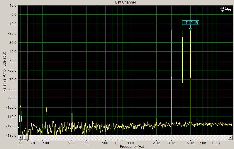

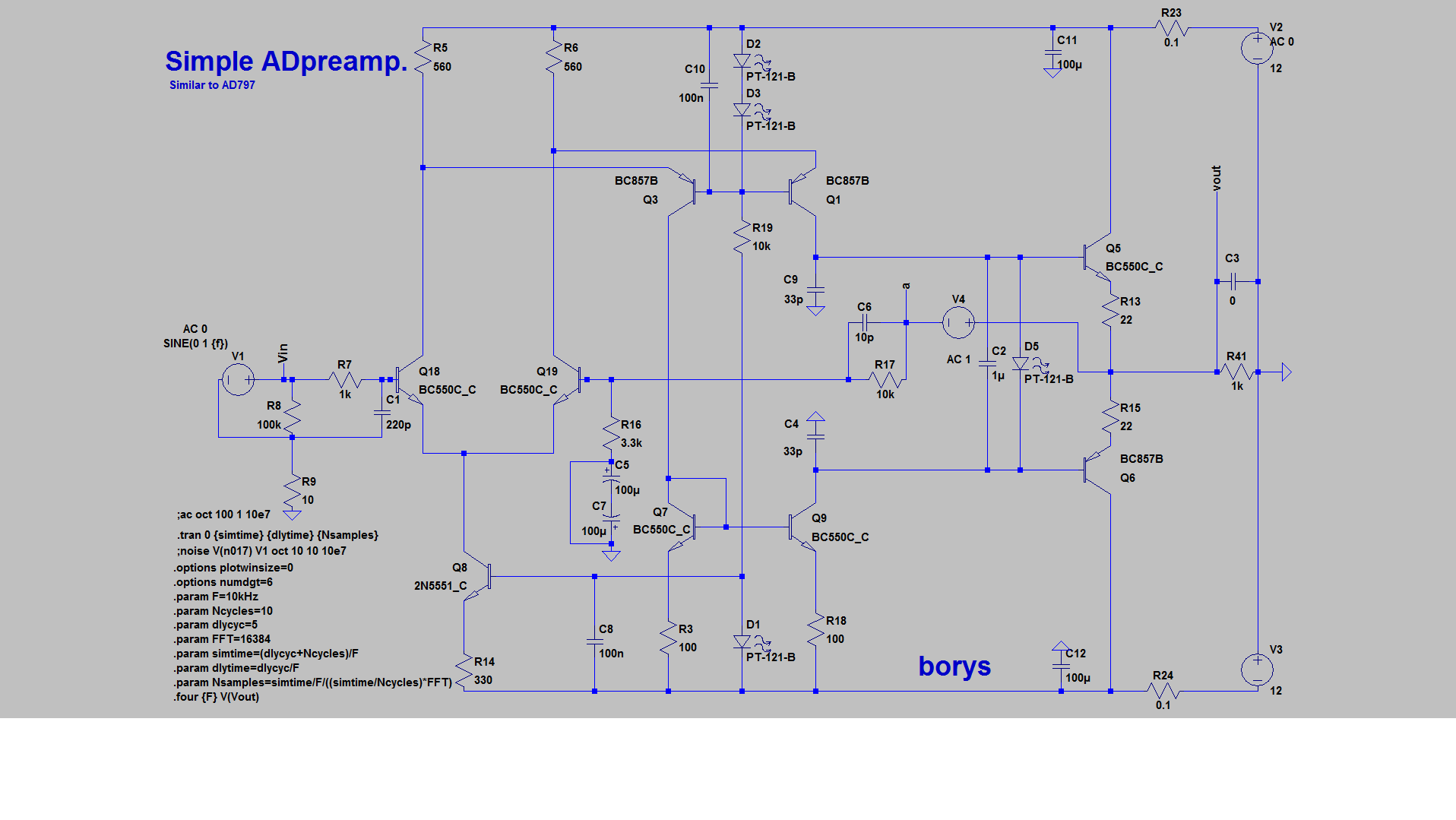

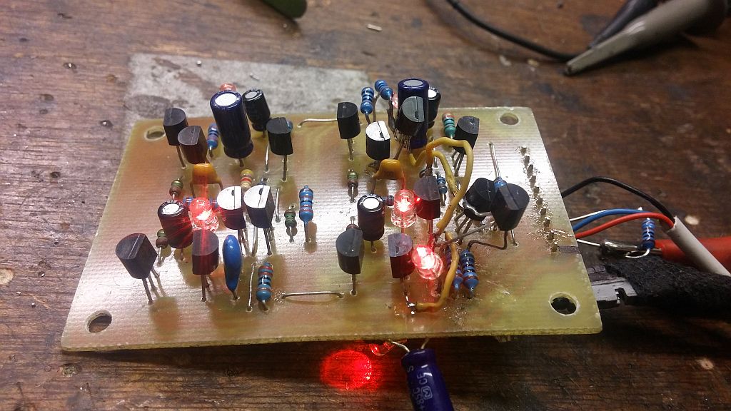

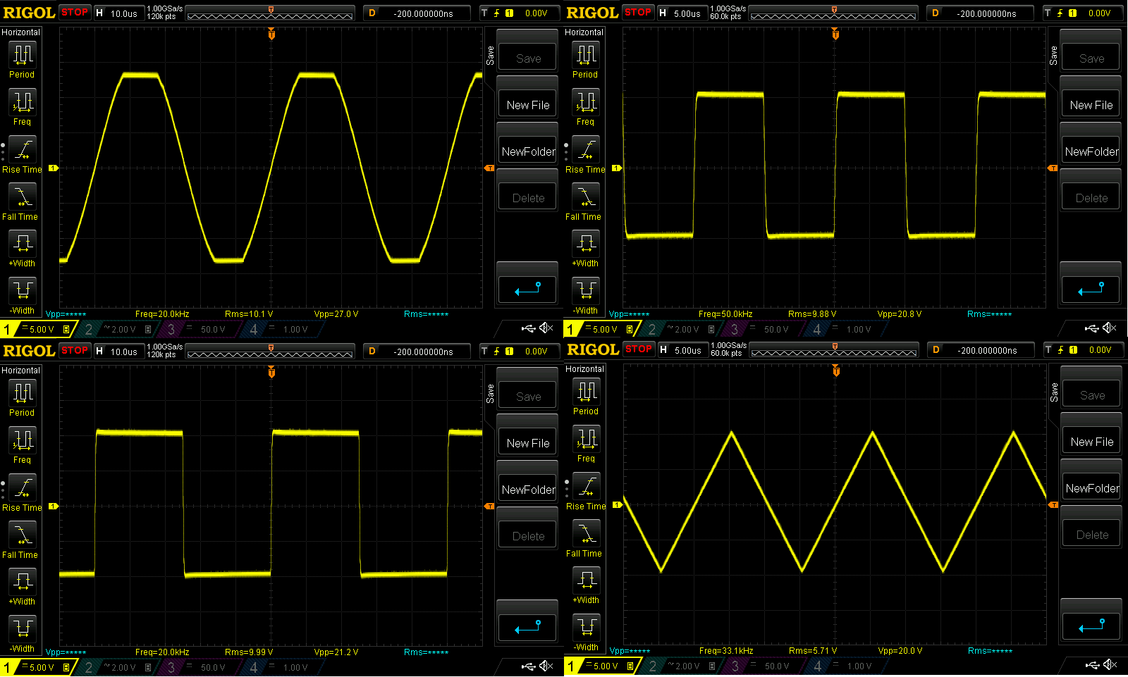

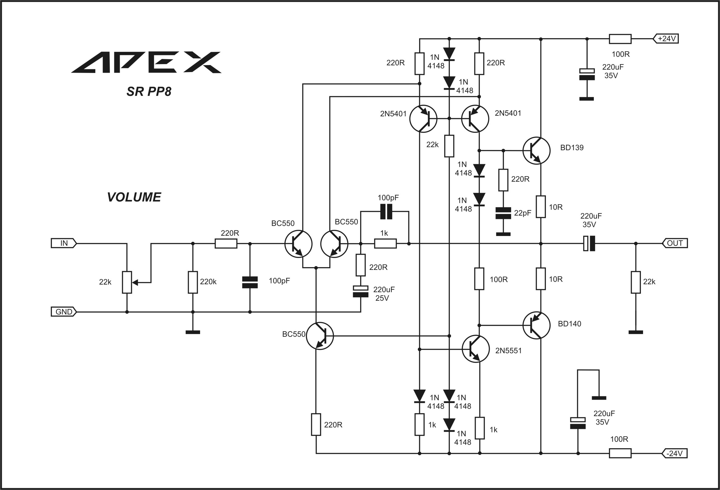

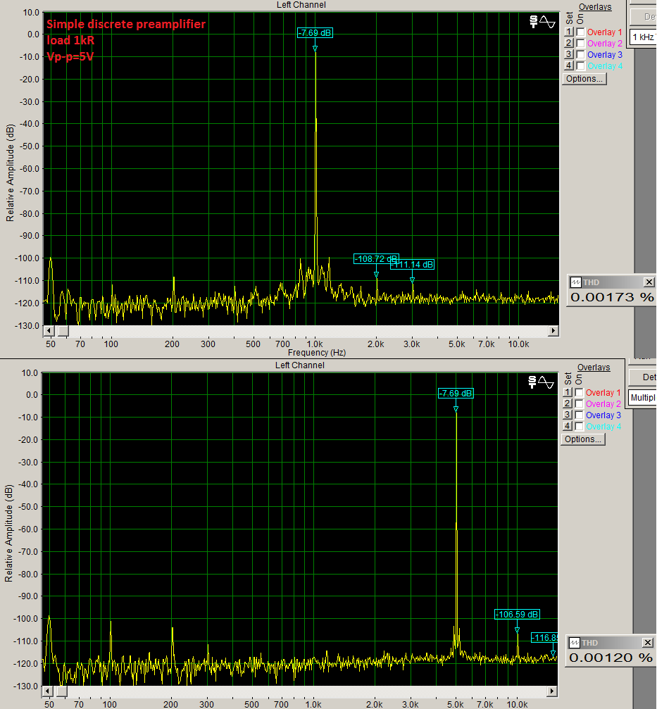

I have made yesterday a simple preamp. A bit similar to marantz PM7000 front end or the AD797 OPamp. The ADPreamp is very simple, performance is good to. It is dead quiet at idlle. I have measured it with 1k load and didn't blow up 😀. The modulated 3kHz 4kHz and 5kHz doesn't show any IMD products (only my crappy psu noise).
With two mosfets at the back or BD's could create a nice headamp.
I have shorted the NFB cap and the offset was about 5mV, so with a bit of the work it can be done a full DC coupled (I hope anyway).
Regards Pit

I like the SR PP8 Mile; it has bandwidth. This also puts the high pole so high that compensation is trivial. I believe it is a emitter drive version of the 1972 Hitachi AN for lateral fets. I have heard this in a power amp and it's very good, with very little phase shift.
Congratulations! Like many of your designs, it is both elegant and simple.
Hugh
