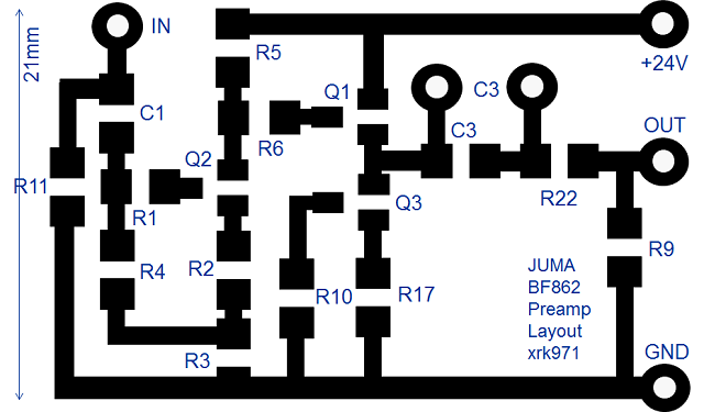

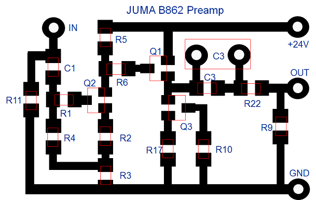

Juma BF862 Preamp Layout
Maybe something like this (about 35mm x 20mm):
This is purely eyeballed layout in PowerPoint graphics... 🙂
Q3 is placed the wrong way 😉
If you turn it 180 degrees and place R10 on the left from R17 - that'll be fine.
I read the spec sheet for BF862 and it says that S and D pins are interchangeable?
http://www.nxp.com/documents/data_sheet/BF862.pdf?
So does it matter, or maybe it sounds better with S & D pins in proper orientation?
Anyhow, I flipped Q3 to make it so:
You're right - this one is really symmetric. Never noticed - this is actually cool for busy layouts.
