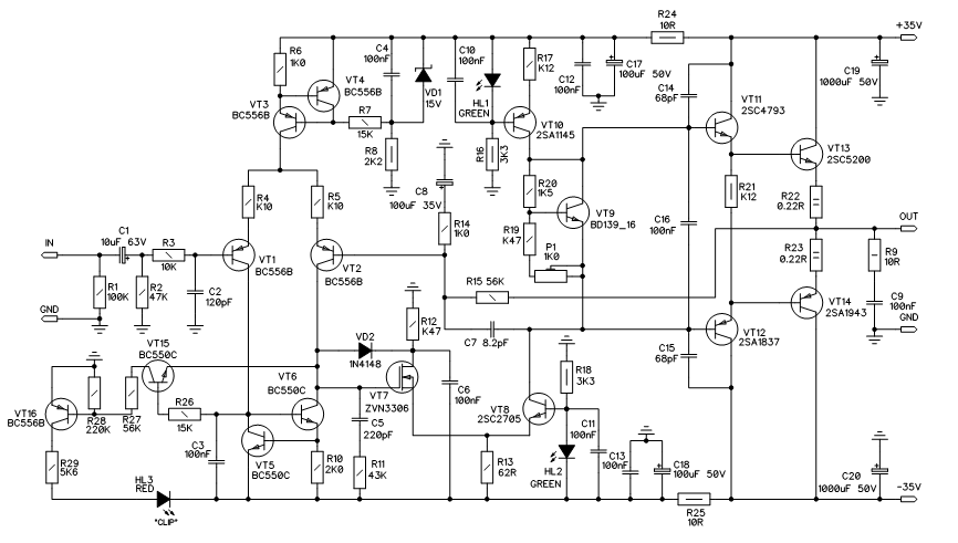

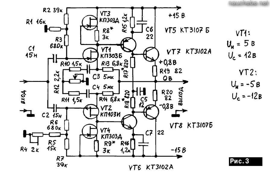

Preamp from Matyushkin, magazine "RadioAmator", #8-9, 1998.

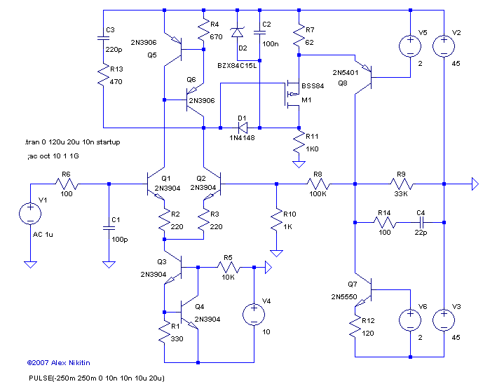

We can arrange the transistors is a little different.Here's a circuit I've played with using Bob Cordell's SPICE models. BC550 and 560 only. First stage input bias currents are NOT negligible so either AC couple it, or build a DC servo.
Bandwidth is 4.7 Megahertz at gain = 21X ((R13+R14)/R14) , therefore gain bandwidth product is 98 MHz (!).
Consider heatsinking the output stage.
http://i.fpicture.ru/img/2016-12/13/5850607a20fbc693455045fa.png
Then we get a dept of NFB of 120 dB in the audio range, and 105 dB at the edges.
This preamp, except for very small distortions, has the advantage that does not introduce distortion when it works with the volume controls a lot of resistance.

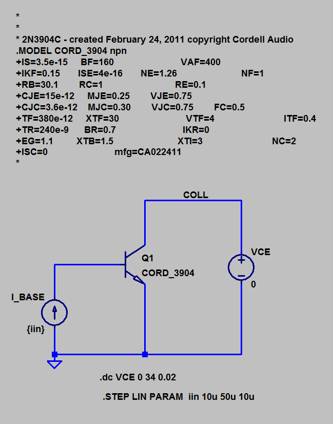

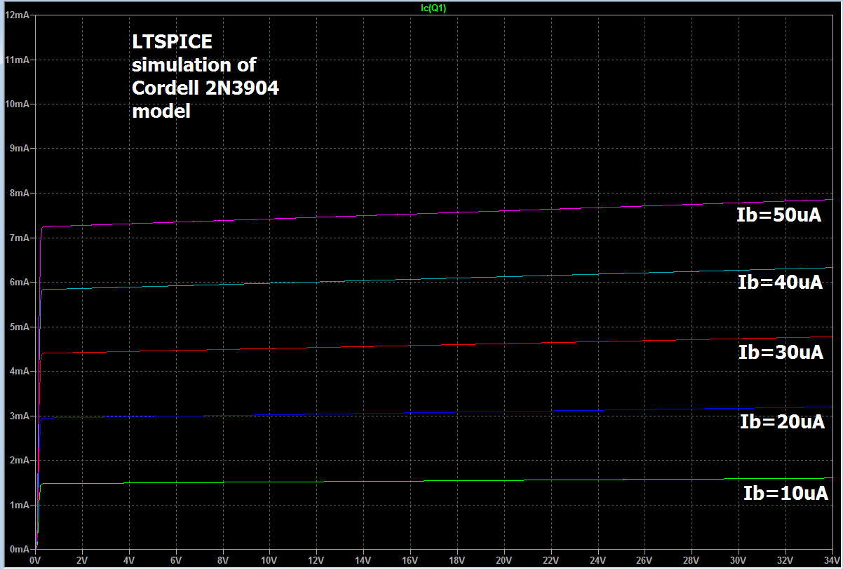

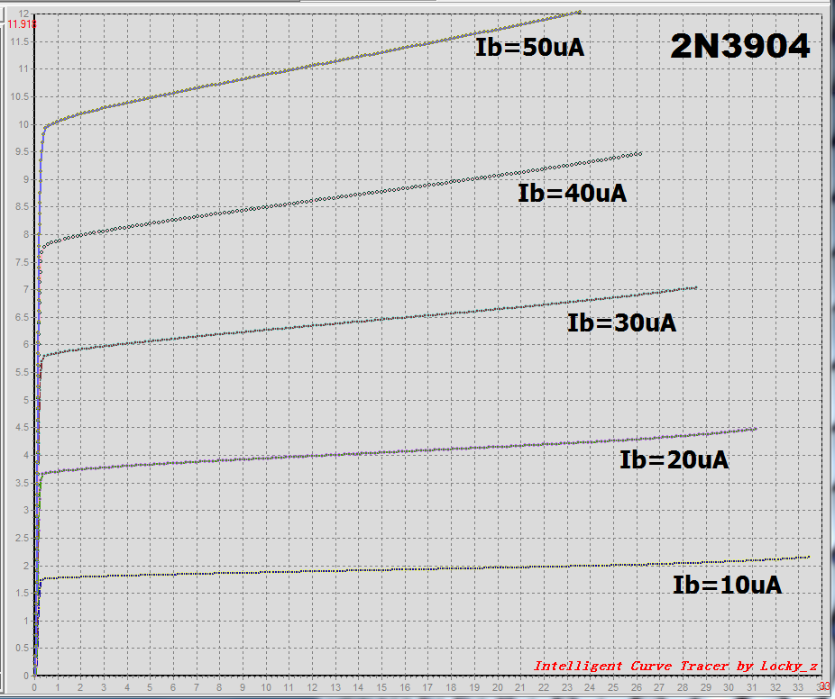

I think those Cordell models might be a little optimistic about output conductance (hybrid pi parameter "ro"), also called Early Voltage.
The 2N3904's model says "VAF=400" but when I measured a real 2N3904 on my curve tracer ten minutes ago, I see an Early Voltage of about 125. Not 400!
Here's an LTSPICE simulation using the Cordell model, and the corresponding measurement on a real device in my lab. The real device has much worse output conductance than the simulation model.
So, be careful with circuits that operate 2N3904s as common emitter amplifiers with high impedance loads, especially current source loads! Such as, unfortunately, Q12 in the attachment to_ post #323.

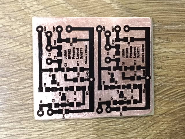

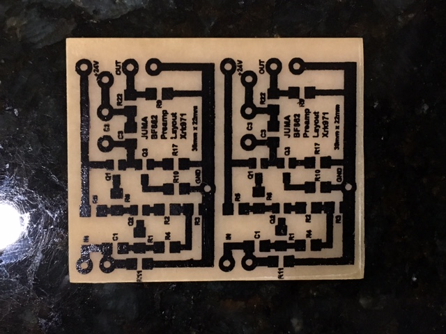

Here is what I am going to print with (35mm x 22mm):

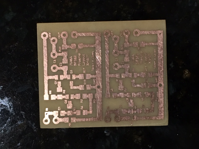

Iron transfer etching worked like a charm and took less than 30min start to finish.

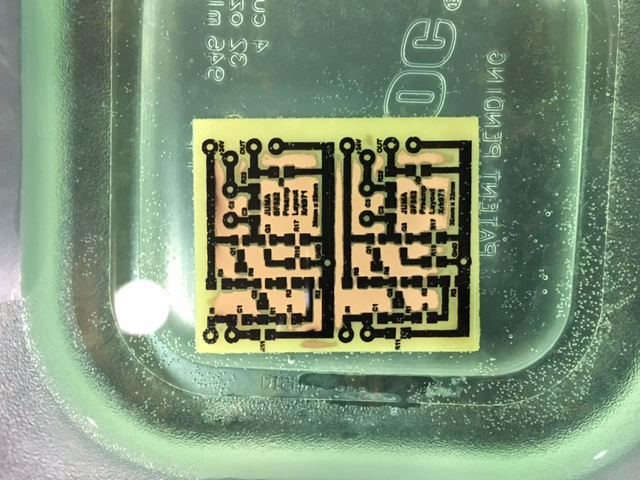

Step 1 - iron on transfer to copper:
Step 2 - etch in 1 part HCl (muriatic acid) & 2 parts H2O2 (5% hydrogen peroxide) bath for 20 minutes:
Step 3 - Remove from etchant and rinse (laserprinter transfer toner still on copper):
Step 4 - Clean off toner with paper towel and "Goop" chewing gum remover:
Done. Nice clean features and ready for drilling and soldering.

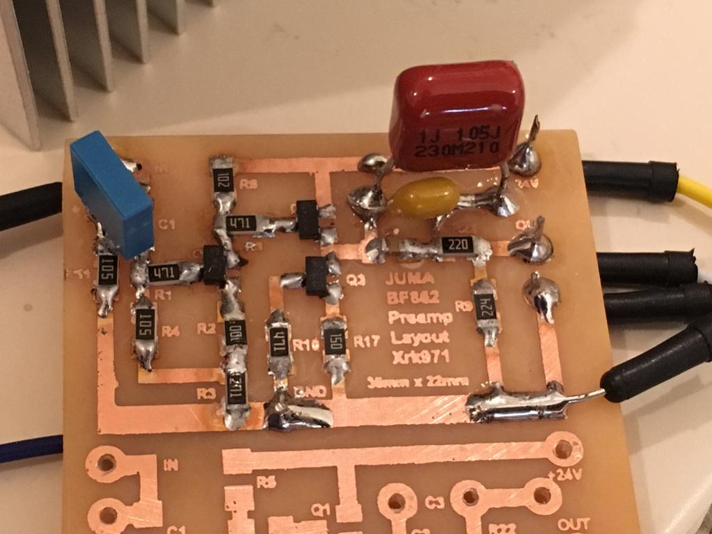

Juma BF862 preamp build
I built up the preamp as shown in the schematic with a few changes: inout cap is 100nF X7R SMT plus a bypass 22nF film cap; output cap is 100nF X7R SMT plus 10uF 50v MLCC and 1uF 230v film cap bypass. I connected it to a 20v supply and first listening impression is that it needs a quiet PSU (regulated and with cap Mx), but I don't hear much gain, and it sounds distorted. I wonder if it's all the SMT 100nF X7R caps I have in the signal path? Or under voltage?
Yes, you are absolutely right. I found this line in the library. 3904: VAF = 400, but 3906: VAF = 40. Apparently, Bob was a little mistake when he was typing. I changed the text to 3904: VAF = 100 and repeated the analysis, but the frequency response is almost unchanged. Lost 2 dB from 120 dB in the audible range and 1 dB at the frequency 20 kHz.I think those Cordell models might be a little optimistic about output conductance (hybrid pi parameter "ro"), also called Early Voltage.

1. What voltage (ref. to GND) do you have on the drain of Q2 (input JFET) ?... I don't hear much gain, and it sounds distorted...
2. What's the value of R3 and what's the voltage across it ?
3. What's the voltage across R7 (15 R) ?
4. Whats the voltage (ref. to GND) at the source of Q1 (Drain of Q3) ?
5. Did you measure the Idss of your JFETs - the values in circuit are JFETs with Idss of 12-15mA and very clean 24V PSU ?
Hi Juma,
Thanks for helping me debug.
The photo shows the values of resistors but I will have to get in lab to measure voltages.
R3 is 270R, R7 (I mislabeled R17) is 15R, I did not measure Idss as I don't have a rig that can take SOT23's. I have one for throu hole parts. I could solder one up to a converter and measure it and hope it's representative of the whole roll of parts. I will give it a clean PSU on final setup. Won't have measurements until later tonight.

It's going to drive the JFET input of my DAO head amp which has high impedance. Can be whatever I set resistor to. Say 100k or 47k etc. So your suggestion of 1uF film is good. I have 1uF 230v MKT installed already. If I set 100k load to be driven. Although Juma set the values on schematic which had 220k load already. I can remove 100nF X7R and 10uF MLCC. On input I can remove 100nF X7R and 22nF film and replace with single 100nF 63v film.
Looks like Q2 is running about 17 mA, seems to be on the higher side Idss wise. That's pushing voltages a bit low with a 1k resistor up there. Try something more like 680-820R.

How many other mistakes do those models contain? We have seen they are imperfect; how many imperfections are present?Apparently, Bob was a little mistake when he was typing.
How will you simulate the variability of semiconductor characteristics? Low frequency beta is specified on datasheets as a range, but SPICE only simulates one numerical value of beta. Transition frequency fT is specified as a range, but SPICE only simulates one value of fT.
How can you know whether your simulations critically depend upon a certain specific number in a .MODEL, which may or may not match real life semiconductors?
Ok snuck in lab before leaving today. With inputs grounded and clean (relatively) 24.0v PSU I have following:
V across R7 is 185mV, R7 is indeed 15R
D of Q2 is 6.85v ref to gnd and S of Q2 is 4.75v ref to gnd
S of Q1 and D of Q2 is 7.19v
V across R3 is 4.58v, R3 is 270R
Your Q2 has Idss of about 20mA so you should increase R2 (start with 22 R instead of 10 R) until you get about 2.7 V across R3 i.e. about 13 V at the drain of Q2 (with 24V PSU).
