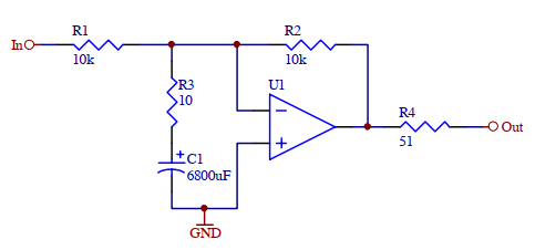

Maybe something similar to one of the circuits Samuel Groner used in his measurements, with a socket:
attachment.php
This has overall unity gain but a noise gain of 60 dB for AC, so with a given reference level you should be able to do the math on whether input voltage noise is in the right ballpark (should be about 0.56 mV, 20-20k, so roughly -66 dBFS for typical onboard audio or -71 dBFS for a 2 Vrms input). Plus, you could determine its small-signal bandwidth @ -3 dB when running a signal over it, which should be a tad over 20 kHz, reduced when adding a small capacitor (e.g. 22 or 47 pF) between pins 5 and 8. Since the circuit is so slow, decoupling should be quite non-critical. If needed, you can always make it even slower by swapping the 10ks for e.g. 22k.
There aren't an awful lot of good candidates for fakes - maybe LF356 at best, but in bulk the difference between those and TI NE5534Ps is pretty marginal already (maybe 6 cents each - 5534s are not expensive parts). Anyway, these are not using pin 8.
BTW, this circuit as shown should be good for an output noise level of around 2.6 µVrms, or a good 117 dB below 2 Vrms. I hope that's good enough for a TDA1541. 😉

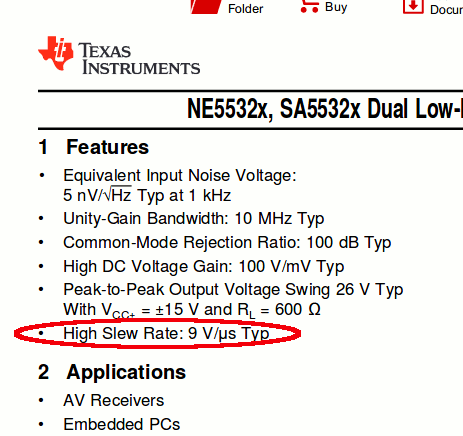

The slew rates are 5V/microsec and 20V/microsec respectively which are nowhere near the 1000V/us.
The Texas Instruments 5532 datasheet lists a slew rate of 9V/uS, not 5V/us (attached image.)
For audio, the worst-case slew rate demanded of an op-amp is for a 30 volts peak-to-peak sinewave at 20 kHz. This is the biggest amplitude possible with the usual +/- 15V power supplies, and 20 kHz is the highest frequency that a normal healthy human ear can just barely detect at deafening (literally, ear damaging) volume.
If you calculate the maximum slew rate required to handle such a sine wave with no distortion, the answer is 3.77 volts / uS.
So the 5532 actually has more than double the slew rate needed to handle the worst-case audio signal. Your other op-amp has more than five times the slew rate needed for such a signal.
That is the engineering reality. Those are the facts.

Two, I mis-calculated the maximum slew rate for a 30 Vpp sine wave at 20 kHz; it's actually half of what I calculated, i.e. approx 1.9 V/uS, becaused I used the peak-to-peak value where I should have used the peak value.
A max require slew rate of 2 V/uS for a rail-to-rail sine wave at 20 kHz means a 5532 is more that two and a half times as fast as it needs to be. When you add in the fact that nobody in their right mind will operate an audio stage right at clipping level, actual signals are likely to be ten times smaller (3V pp, around 1 V RMS), meaning the 5532 will be about 25 times as fast as necessary.
779982d1567877040-transistor-preamp-groner-xferlin-cct-png

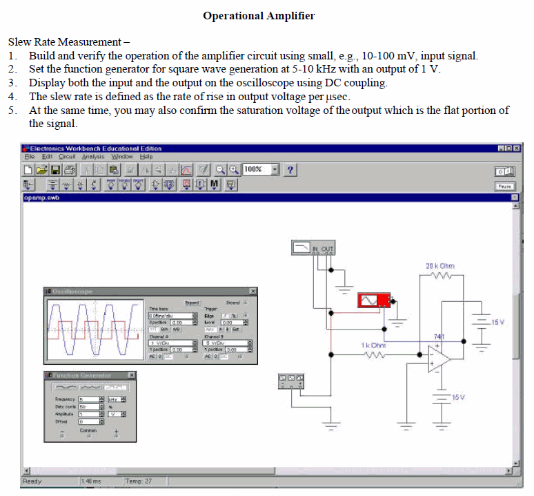

Slew rate testing: see attached lesson-plan. If your amp is faster than a '741 😱 you might use 100kHz square wave. Since some commercial function generators use modest-speed buffers at output, simpler may be better. CMOS Schmitt RC oscillator is simple and fast. Add a 500 Ohm pot to set output level (you want to drive the opamp hard, but not slam it "many volts past the rails"). EDIT-- Mark already told you all this, even specific chip. Was he unclear?
The LME49710 slews at 20V/microsec, quite a bit faster than 741. Mark did gave me all I need to know. I am too lazy to build the test rack and tried to see if there is an easier way.
