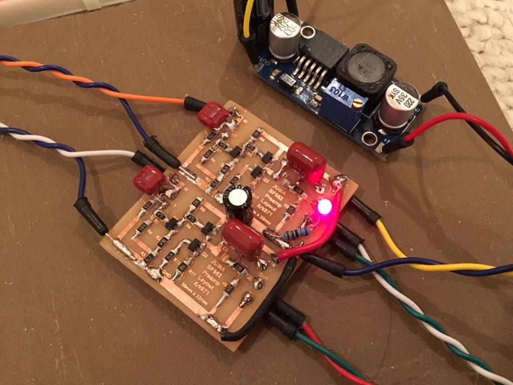

Juma BF862 preamp works!
I replaced R2 with a 47R (tried 22R, 33R but not enough). Voltage across R3 is now 2.87v, voltage across R7 is 194mV and voltage at D of Q2 is 13.6v. I tested it and it sounds real nice, with the perfect amount of gain using a 270R for R3. So I built up the second channel. I am using a single 100nF 100v MKT (CBB) film cap on the input and a 1uF 230v MKT (CBB) film cap on the output. Input impedance of my amp is 100k.
Here is a closeup of the preamp all built up:
Here it is with the temporary switching voltage booster to get 24v. I ordered a new 100VA trafo that will give me 28vdc and then I will use a Juma Easy Peasy Cap Mx to get down to smooth ripple free 24v rails for the amp and the preamp. Right now there is about 5mV ripple but I can't hear it as the amp PSRR is quite good.
The preamp now allows my new DT880-250 phones to really be driven at the perfect level because at 85% volume, I am starting to think it is too loud and measurements with DVM show about 1.6v AC (or 10mW into these 96dB/mW sensitive phones). So that is about 105dB apparent SPL in my ears.
Here is the preamp actually playing music with the DAO amp:
So wondering if I should try a 470R shunt resistor?
This preamp/amp combo is very neutral. Just the right amount of bass and all is very balanced. The articulation is very impressive and I am really enjoying the sound.
Thanks to Juma for another great amp (or preamp in this case). The layout I posted works if anyone else wants to have a try. This is a fantastic sounding single ended class A preamp. So actually the same flavor as the power amp so it preserves the sonic characteristics of the main power amp.
