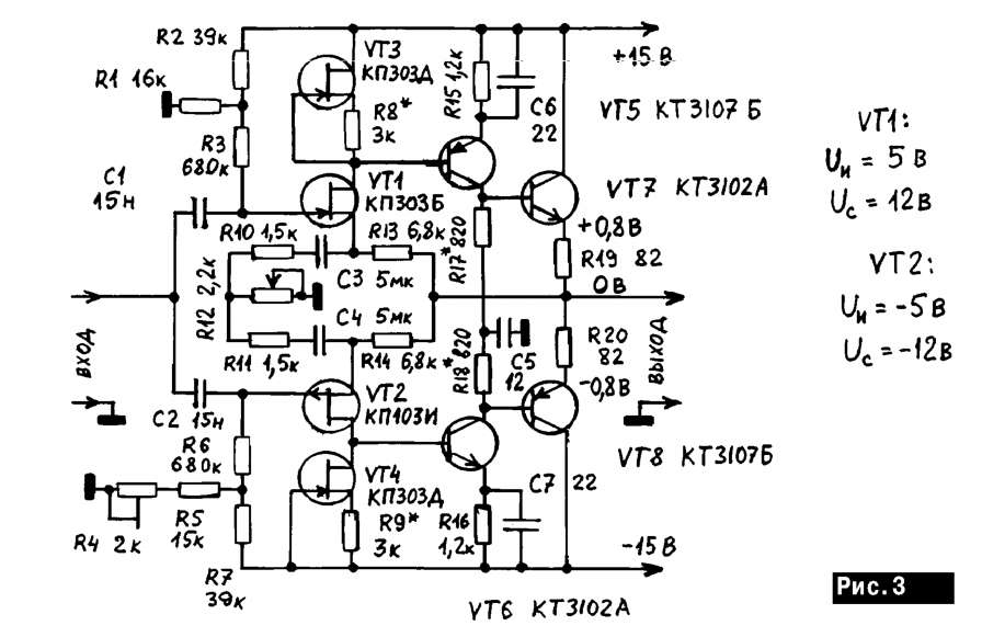

Preamp from Matyushkin, magazine "RadioAmator", #8-9, 1998.
We can arrange the transistors is a little different.Here's a circuit I've played with using Bob Cordell's SPICE models. BC550 and 560 only. First stage input bias currents are NOT negligible so either AC couple it, or build a DC servo.
Bandwidth is 4.7 Megahertz at gain = 21X ((R13+R14)/R14) , therefore gain bandwidth product is 98 MHz (!).
Consider heatsinking the output stage.

Then we get a dept of NFB of 120 dB in the audio range, and 105 dB at the edges.
This preamp, except for very small distortions, has the advantage that does not introduce distortion when it works with the volume controls a lot of resistance.

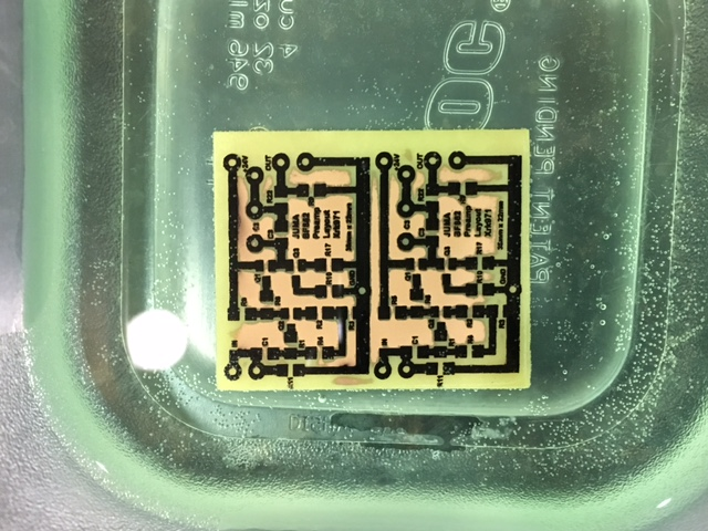

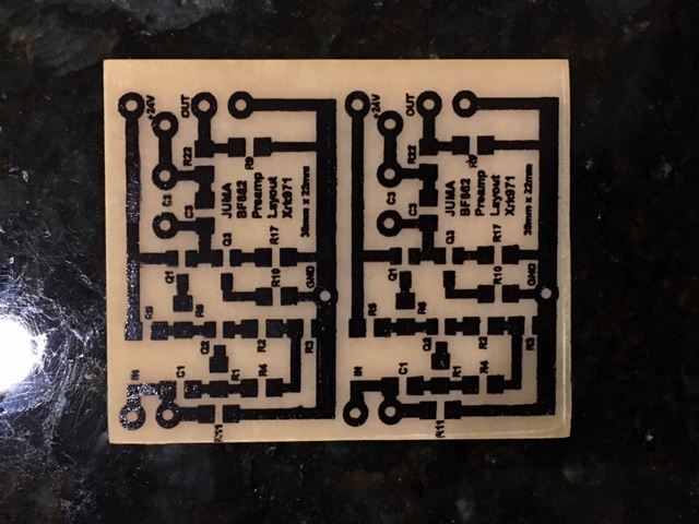

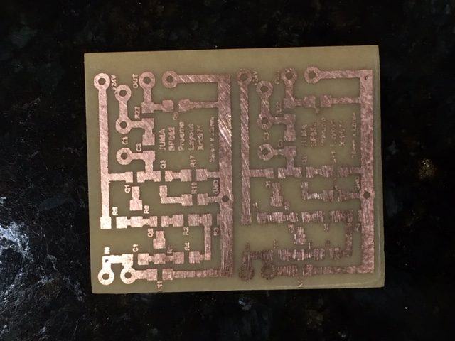

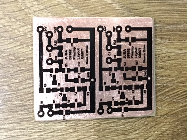

Here is what I am going to print with (35mm x 22mm):
Iron transfer etching worked like a charm and took less than 30min start to finish.
Step 1 - iron on transfer to copper:
Step 2 - etch in 1 part HCl (muriatic acid) & 2 parts H2O2 (5% hydrogen peroxide) bath for 20 minutes:
Step 3 - Remove from etchant and rinse (laserprinter transfer toner still on copper):
Step 4 - Clean off toner with paper towel and "Goop" chewing gum remover:
Done. Nice clean features and ready for drilling and soldering.

Thanks, Prasi! This was fun, I can't believe how fast it is to do a small job like a pre-amp. Layout done using PowerPoint 😀 I am too dumb to use Eagle or Sprint. 🙂

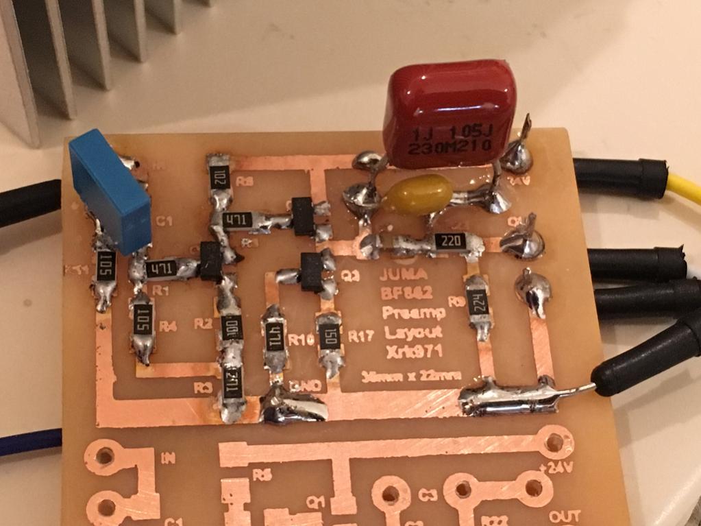

Juma BF862 preamp build
I built up the preamp as shown in the schematic with a few changes: inout cap is 100nF X7R SMT plus a bypass 22nF film cap; output cap is 100nF X7R SMT plus 10uF 50v MLCC and 1uF 230v film cap bypass. I connected it to a 20v supply and first listening impression is that it needs a quiet PSU (regulated and with cap Mx), but I don't hear much gain, and it sounds distorted. I wonder if it's all the SMT 100nF X7R caps I have in the signal path? Or under voltage?

1. What voltage (ref. to GND) do you have on the drain of Q2 (input JFET) ?... I don't hear much gain, and it sounds distorted...
2. What's the value of R3 and what's the voltage across it ?
3. What's the voltage across R7 (15 R) ?
4. Whats the voltage (ref. to GND) at the source of Q1 (Drain of Q3) ?
5. Did you measure the Idss of your JFETs - the values in circuit are JFETs with Idss of 12-15mA and very clean 24V PSU ?

Hi Juma,
Thanks for helping me debug.
The photo shows the values of resistors but I will have to get in lab to measure voltages.
R3 is 270R, R7 (I mislabeled R17) is 15R, I did not measure Idss as I don't have a rig that can take SOT23's. I have one for throu hole parts. I could solder one up to a converter and measure it and hope it's representative of the whole roll of parts. I will give it a clean PSU on final setup. Won't have measurements until later tonight.
Ok snuck in lab before leaving today. With inputs grounded and clean (relatively) 24.0v PSU I have following:
V across R7 is 185mV, R7 is indeed 15R
D of Q2 is 6.85v ref to gnd and S of Q2 is 4.75v ref to gnd
S of Q1 and D of Q2 is 7.19v
V across R3 is 4.58v, R3 is 270R

Looks like Q2 is running about 17 mA, seems to be on the higher side Idss wise. That's pushing voltages a bit low with a 1k resistor up there. Try something more like 680-820R.

Your Q2 has Idss of about 20mA so you should increase R2 (start with 22 R instead of 10 R) until you get about 2.7 V across R3 i.e. about 13 V at the drain of Q2 (with 24V PSU).
