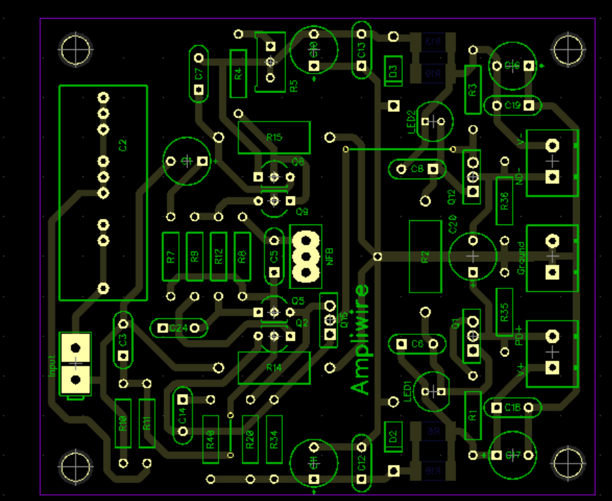

What happened to the circuit in post 126 that uses C3503 and A1381 for the outputs? Is it not any good?
That's the circuit I'm interested in trying to alter Albert's layout for if possible.
By the way, I sent Albert a PM yesterday for the layout file and haven't heard back from him.
Hi Ammel,
That one is the line stage. This one here is particularly configured for driving any kind of headphones, including the low-ohm ones.
I've got boards but they include a PGA2310 volume control and a pre-buffer. I'm using this for test equipment, so the design is tailored for my application. They are compact surface mount boards.
If you want to use surface mount devices I can modify the layout to something you can use, or if you want to use through hole devices I think I have some layouts for input boards that can be easily modified to suit your needs.
Here's a single sided layout I did for hand etching. I can give you Gerbers for it if you like. I never did finish a through hole double sided version.

I just had a closer look at Valery's schematic, and he's added an extra pair of devices after the VAS in these. That would make them VHex+ boards without the output devices installed. I have those in stock too.
Are they through-hole or SM?
I would like a through-hole board with all the C3503s and A1381s(that need fastening to a single heatsink) close to the back edge of the board and eliminate the portion of the board with the VHex+ output devices and their components.
Perhaps I can take the board you have, load it into Sprint and remove the components that aren't needed, which should decrease the size of the board some.
The VHex board is a mix of through hole and SMD. All transistors are through hole. The layout is excellent for a 2U chassis design, but to modify for a preamp design would be harder than starting over. Adding a pair of transistors to the Ampliwire layout would be much easier, and it's completely through hole. My files are all drawn in Diptrace, but you can import the Gerbers in Sprint and modify them if you like.
I would like to get a Gerber of Ampliwire - looks nice.
