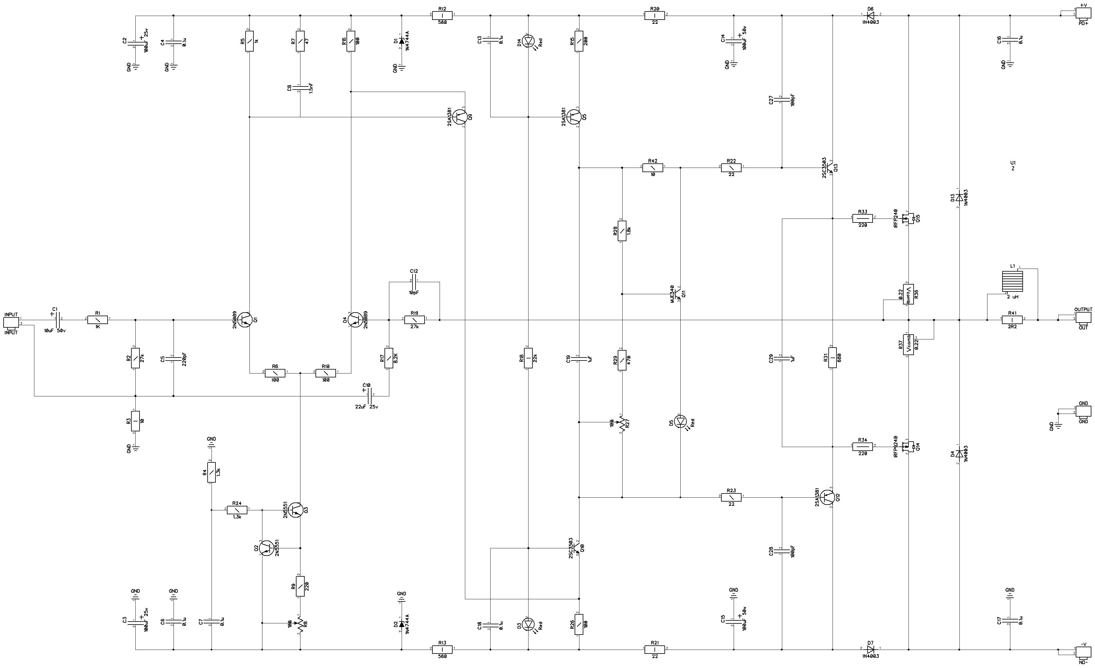

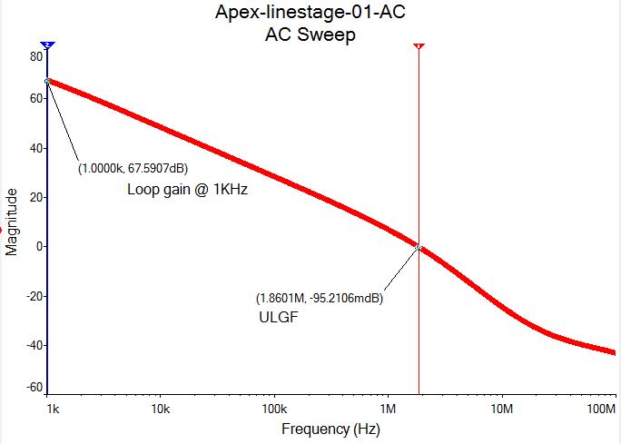

Just for fun - my version. The front-end from VHex amplifier, slightly adapted for line stage requirements.
Basic parameters:
OLG @ 1KHz = 95db
THD @ 1KHz open loop = 0.04%
CLG @ 1KHz = 12db
THD @ 1KHz = 0.00006%
Output impedance = 1 ohm
ULGF = 7.5MHz
No Miller compensation (allowed by current-driven VAS).
Fast and clean step response.
In fact - same grade as the one from Apex above. Key difference - I like this compensation scheme sound-wise. Ultimate clarity.

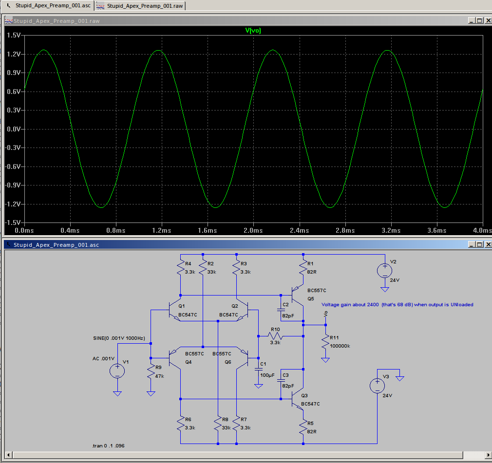

The huge weakness of this design is that almost all the voltage gain comes from the output stage; that voltage gain is obtained by having each output transistor work into a very high impedance (the collector impedance of it's complimentary partner).
Now, if you load the output, that huge load impedance is gone. When it falls, so does the open-loop gain. The lower the load impedance, the worse the problem is.
If, for example, you connect 32 ohm headphones to the output, the voltage gain of each output transistor is about one-third; 0.33, or -10 dB! The gain is less than unity, it's actually throwing away gain, like a potentiometer!
This is because each output device has an 82 ohm emitter; its voltage gain is therefore a bit lower than (32 ohms/82 ohms). Lower because there is also the dynamic resistance of the emitter-base junction to deal with, which adds to the 82 ohm resistance.
There isn't a whole lot of voltage gain happening in the input stage, either. This is because there is rather a small voltage drop occurring across those 3.3k collector load resistors. The voltage gain of a transistor stage is directly proportional to the DC voltage across the collector resistor - keep this voltage low, and the voltage gain will be low, too.
Okay, that's what's happening in my words, but how do you know if I'm talking through my hat? Maybe I'm yet another nitwit spouting total nonsense on the Internet?
So I wasted 15 minutes of my life entering this schematic into LTSpice. The exact transistors in this amp aren't included in LTSpice, and I didn't want to waste even more of my time simulating a design of dubious quality, so I used small-signal silicon epitaxial transistors from the same family.
If anyone is feeling particularly picky, I'm attaching the .asc (simulation) file. Cordell Audio (dot com) has LTSpice models for the BC550C and BC560C. Please feel free to plug in the Cordell Audio models, and re-run the simulation.
There is one other change to the schematic; I used a 100uF cap to remove all the (AC) negative feedback, so what you see is the full open-loop gain of the circuit.
Note also that the sine wave input signal is 1 mV peak. Look at the graphs, read off the peak value of the output in millivolts, and that is the open-loop gain. If you see, let's say, 6 volt peaks on the output, the voltage gain would be (6000 mV/ 1 mV), or 6000 times.
So what did LTSpice say? When the output is unloaded (best case) the voltage gain is 1200 times; Nearly 62 dB. Not great, considering the complexity of the circuit, but at least not utterly horrible, either. (I unloaded the circuit by making the load resistance very, very large - look at the value in the schematic.)

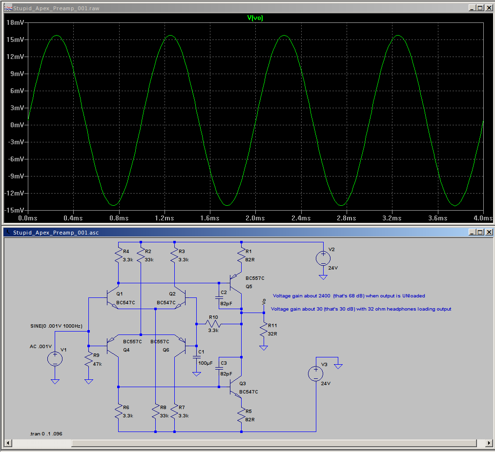

(NOTE: The screenshot says 2400 times instead of 1200 times; I forgot that when you tell LTSpice "1 mV", it actually spits out 2mV peak-to-peak. Actual gain is half of what I wrote on the screenshots, which is 1200 in this case.)
The second screenshot shows what happens if you connect 32 ohm headphones to the output. This is a typical impedance for generic portable-device headphones, and probably a worst-case load for this little preamp. The input is still 2 mV peak-to-peak, the output voltage (open loop) is only 30 mV(!) The open-loop voltage gain is only about 15 times, around 24 dB!
An open-loop gain of 15 times? This might have been passable if it was obtained from one single primitive triode valve in 1915. But from six modern high-performance silicon small-signal transistors in 2016? That's so bad, it's absurd.
I know nothing about the designer of this circuit, and I don't want to; this is not a personal vendetta. But failing to buffer the voltage gain stage makes no design sense at all, unless this circuit was intended to never have any load on the output. (Well, that makes no sense at all, either.)
Anyone can have a bad day, and perhaps the designer just had a really, really bad day when he/she put together this particular circuit. Perhaps all his/her other circuits are brilliant. I don't know.
But whatever the cause, this is a poorly designed circuit. Buffering the output stage would make it a lot better.
-Gnobuddy

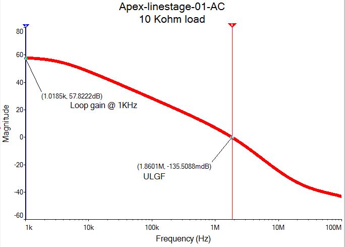

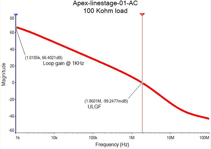

Attached images illustrate the feedback loop gain with the LOOP CLOSED:
1) no external load (LG = 67.6db, CLG = 12db -> OLG = 79.6db)
2) 100 Kohm external load (LG = 66.4db, CLG = 12db -> OLG = 78.4db)
3) 10 Kohm external load (LG = 57.8db, CLG = 12db -> OLG = 69.8db)
No problem, right?
Of course, if we need a headphone amplifier, we need a power buffer at the output - I have mentioned my design configuration, suitable for the purpose.
Valery

VHex Headphone Edition schematic
OK, here is the schematic, based on VHex 1.1, amended for running as an all-around precision headphone amp.
Rails are +/-24V DC.
Set DC offset to zero, set the bias to 100mA, check/correct the offset once again, set the bias to 200mA. Make sure the heatsinks are good enough for running with constant 10W dissipation per channel. Use some DC offset protection at the output.
Have fun 😉

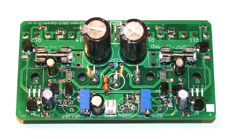

That's the circuit I'm interested in trying to alter Albert's layout for if possible.
By the way, I sent Albert a PM yesterday for the layout file and haven't heard back from him.
