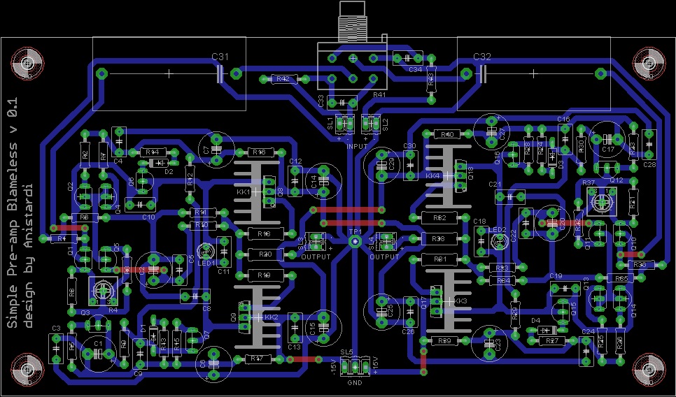

My version of simple "blameless" pre-amp. Not tested!
Maybe it better to add DC Offset adjustment.

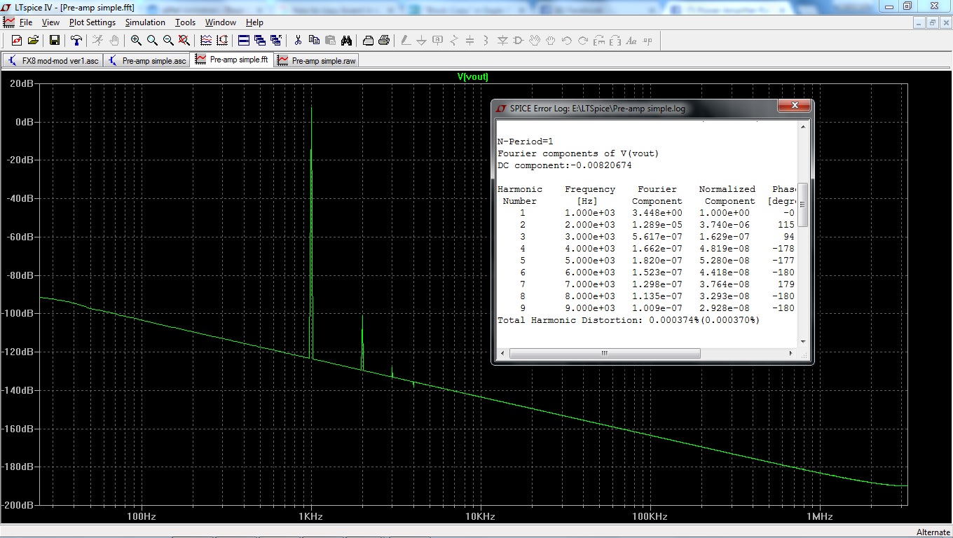

THD at 20kHz should be 0.002978%, sorry.
THD and FFT.

I would like to get a Gerber of Ampliwire - looks nice.

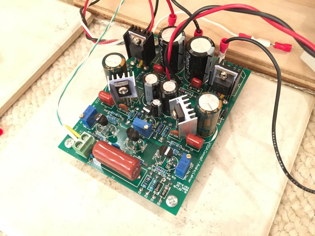

I have another idea for a preamp/head amp. I have a bunch of JK VSSA thru hole PCBs. Replace the the outputs (2sk1058/2sj162 latFETs) with IRF610/9610 with a twist of legs 2 and 3 and stand them up with small local heatsinks. Could probably run 24v rails without other modifications.
So I made a Jason K VSSA preamp/headamp using IRF610/9610's instead of SK1058/SJ162 latFETs.
I thought I could get away with local heatsinks but they are really hot. Maybe a smaller heatsink can work. I am running 80mA bias and that in itself generates quite a bit of heat.
It's actually able to power my speakers. I might switch out BC550 Vbe multiplier with BD139 mounted to one of the outputs.
Btw, this exercise shows that with a simple twist of the legs on the IRF610/9610, it can be used in place of the laterals. The bias is very touchy though - so will need temperature feedback Vbe multiplier.
