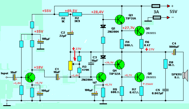

transistor amp not working after shorting output

Maybe this will help?

so you suggest that i measure voltage on output for transistors or ? i dont understand
You measure (or look at on a scope) the output voltage at the normal place. You should still be able to develop a couple volts RMS of clean signal driving a high z load. The tiny voltage across the speaker in series with it doesn’t matter much, but you should be able to hear clear vs. distorted.
The iffy meter can still show a couple of volts RMS, as in the presence of a “large” signal. Monitoring through a speaker (attenuated by the 100-1k ohm “load”) can tell you what it sounds like. BTDT. Got a little better when I managed to score an old green screen uncalibrated scope for $30 at a hamfest.
