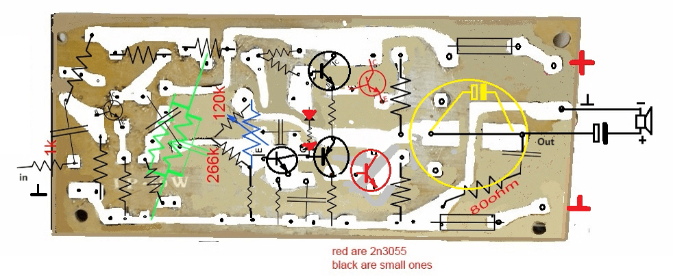

Have we even attempted to trace out a schematic yet? This thing looks pretty simple.

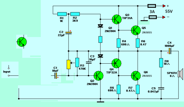

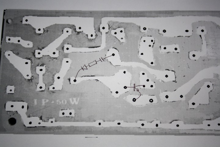

I tried making a schematic based on the image provided, but those wires from the 2N3055 are blocking the traces underneath it. It would help a lot if sg97 could take photos without these wires.

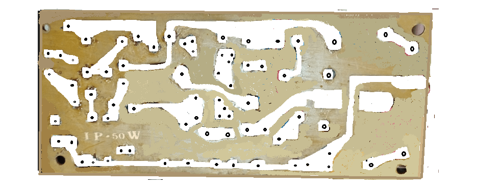

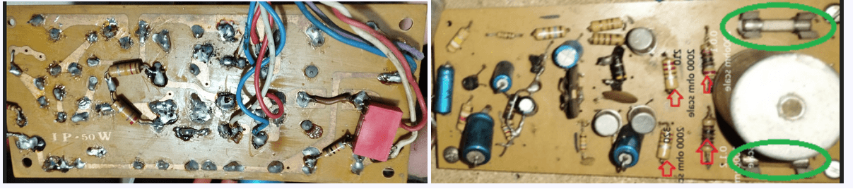

I also created an image of the board with no components populated.
Screenshot 2024-01-01 at 08-47-44 IMG_20231217_172411.jpg (JPEG Image 2048 × 1543 pixels) — Sc...png
sg97, please check if the copper trace is correct? Can you draw the components on it so we can make a schematic?

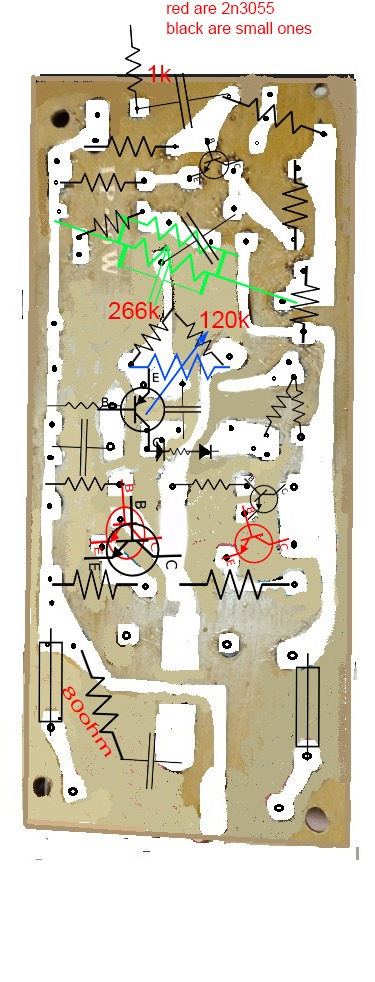

i will do my best in showing where components are but as i said i may not able to draw all because not all components are on board its stupid and not professional. if it was board from commercial product it would be easier for me
here it is it took a lot of time but its here, i did not put resistor values but you can see it it second pic. btw orientation for transistors may not be 100% true. but their place is. let me know guys what you think

That is progress 🙂, but there are things that don''t make sense to me. I dont have much time right now, but to start:
the two diodes with the resistor in series, I think they are the bias parts. The driver transistors (the small ones that have one leg connected to the base of a 2n3055) should have their base connected to the bias string, one on either side. But I don't see that in your picture, so I am confused..
