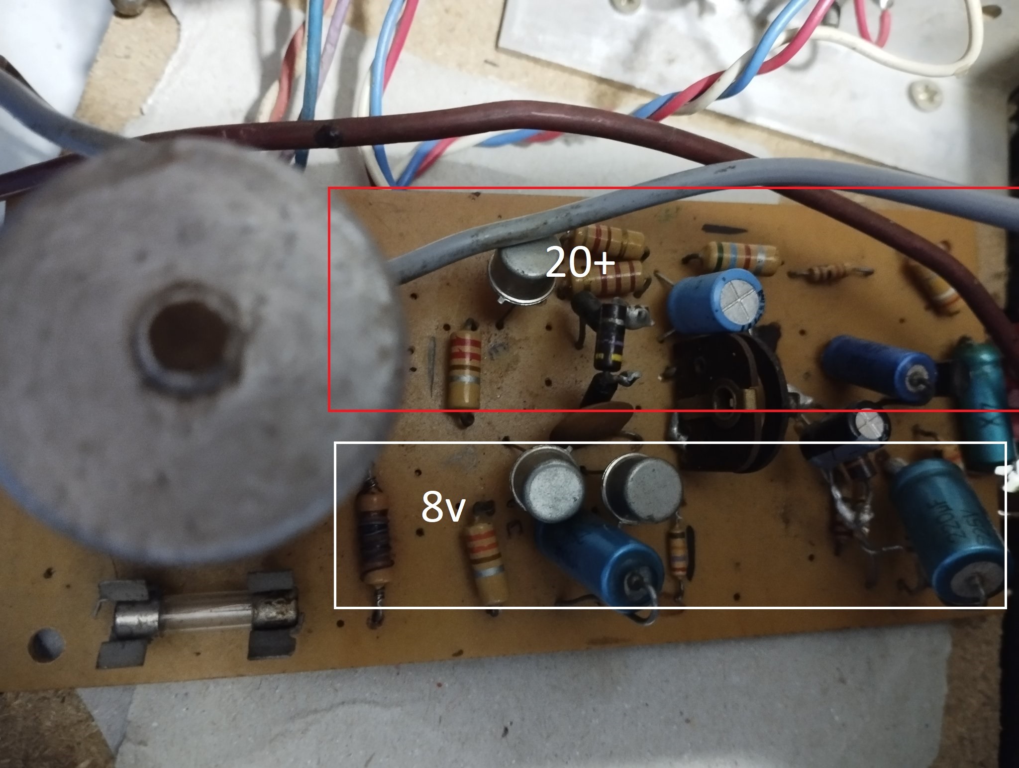

transistor amp not working after shorting output
Trimmers on these designs are either for bias or centre voltage. You would adjust the DC voltage on the output capacitor (circuit side, not speaker) for a level slightly less than 1/2 the supply voltage. You need an oscilloscope and oscillator to adjust it properly but that should be close enough.

I suspect something is wrong with the bias arrangement. Unfortunately we don't know what it is. Can you tell us what parts are between the bases of the two driver transistors?
If the trimpot is part of the bias circuitry, it could be the problem. Open circuit?
i did a lot of measurements i also found two 1,5ohm resistors i put in there its more then needed but i hope thats not a issue. also it seems like on one side of the board i have 20+ volts and on other like 8 why is that only thing that i did not change are caps but i dont knwo if that can do this let me know. so adjusting the pot do change voltage but only for one side
i checked literally everything i have no clue

Hi sg97,
You are our hands, eyes and nose here. Also, brain.
You need to learn enough to help us help you. It is so difficult and time consuming to try and help this way, and if you misunderstand something and report the wrong information back, it sends everyone down the wrong path.
Servicing electronic equipment is not as easy as it may seem to you. When I have something on my bench, I use all my senses and experience to point me in the right direction before even plugging it in. Once power is applied, the amount depending on what is happening, I make choices as to what to check next and that guides my efforts. Without a circuit diagram, we are all in the dark. There are some things we can check, but I know I have suggested things and you didn't follow through. Same for others.
I'll say it again. Use your meter, test some known good transistors and get a feel for it. Then, look up the parts to see what they do and gain at least a tiny understanding of how a part (whatever it is) works. Learn the symbols for the parts, and help everyone, including yourself, fix this amplifier. You'll gain valuable knowledge and the logic behind troubleshooting will help in all aspects in your life and work.
To make a schematic, we need to know what trace connects to which terminal of each component. For a transistor, that would be the base, emitter and collector. Diodes have an anode and cathode, capacitors often have a positive and negative terminal. If you could at least draw out where the parts are on the board, then draw lines to show where the foil on the back connects to, that would give us a fighting chance. Use your meter on continuity test to confirm what you have drawn - then show us.
