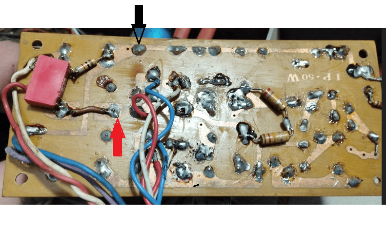

transistor amp not working after shorting output
btw as i said yesterday bulb is now looking like this i got new one same as previous 75w and it looks like this it does not go brighter , what would happen if i dont use it amp will burn ? btw this picture is only representation of what i see

please post the voltage of the following point:
Screenshot 2024-01-06 at 08-23-07 IMG_20231217_172411.jpg (JPEG Image 2048 × 1543 pixels) — Sc...png
It should be around half of the power supply voltage = 27.5V, if not, adjust the potentiometer to get the voltage as close to 27.5V as possible. It will increase power and reduce distortion.

i am not sure if all caps work, i am not a pro when it comes to this but if resistors are all working transistors are working what else is there? caps i dont have equal voltage on both 2n3055 so one comes hot really fast and other one is mildly hot after a few minutes so the voltages confirm that. adjusting trim does almost nothing to equalize that voltage. so my suspects are caps. i will test them but i am sure that one of them may be bad ones on board probably.
i may have time to test it in the evening. but voltages that i already tested are 26v for one transistor and 7.5 for other one. they should be equal ? i will test what you told me last time but i am just giving suggestions now what problem could be.
Hot transistors does not point to defective caps. Defective caps are when the amp comes up seemingly normal (with low heat, normal voltages) and you get a lot of hum or very low audio.
Hot transistors - what is the voltage between the bases of Q3 and Q4? Does the heat GO AWAY if you short those two points?
