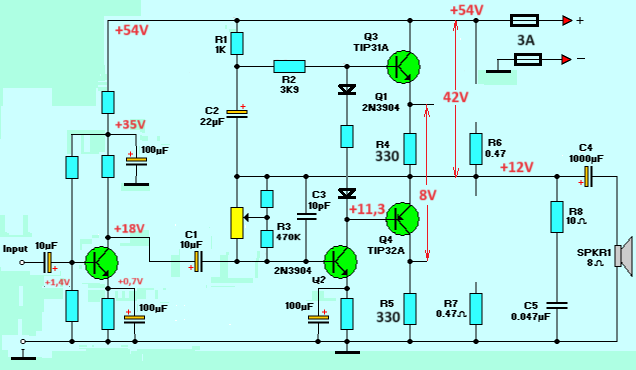

But the top transistor should measure 55V, not 26V if the schematic is correct and if sg97 measured the collectors to ground.
Much if's...

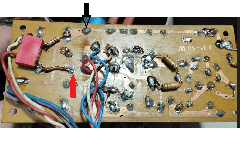

The black arrow is ground and your black lead should connect to that.
The red arrow is where your red lead shoud measure.
Meter on DC voltage.

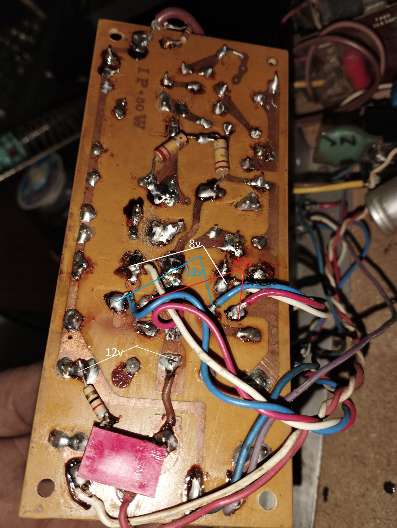

its 0.7v between bases of both transistors white wire between collectors is 28v between emitters is 07vHot transistors does not point to defective caps. Defective caps are when the amp comes up seemingly normal (with low heat, normal voltages) and you get a lot of hum or very low audio.
Hot transistors - what is the voltage between the bases of Q3 and Q4? Does the heat GO AWAY if you short those two points?
This voltage is correct.between collectors is 28v

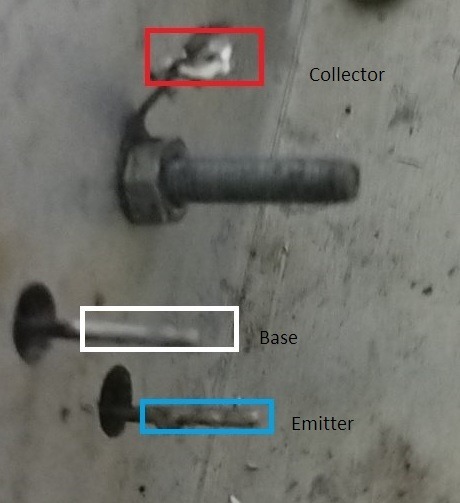

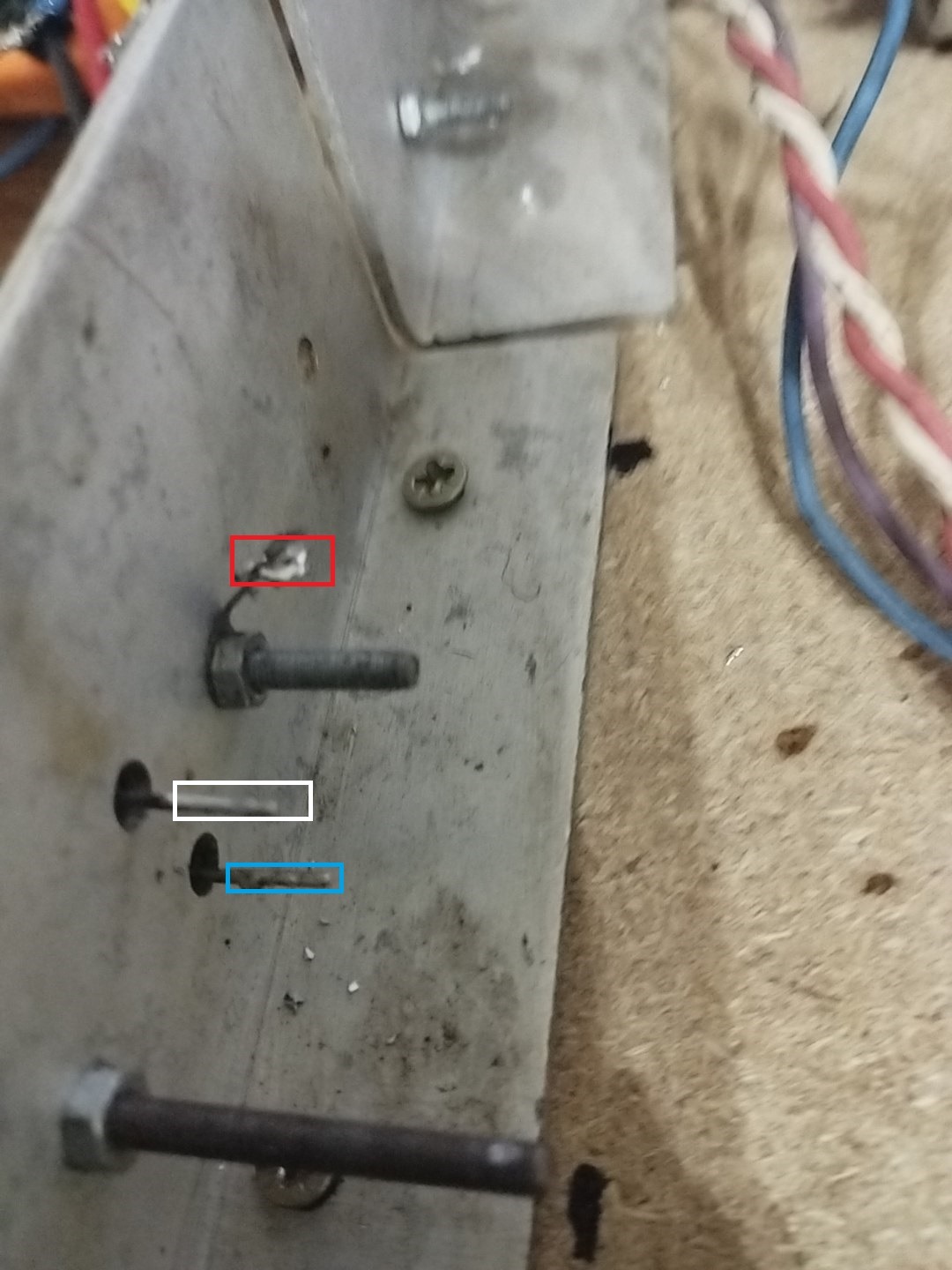

Please clarify:
The white wires goes to?
The red wires goes to?
The blue wires go to?

Do 330 Ohm resistors get hot?
It is necessary to have voltages relative to ground on the legs of small transistors.

guys i cant read this scematic btw use this one to tell me to measure thing i understand this better 😀 btw when i adjust trim now to the left i get a bit moe volume bulb is not lit even amp is on max, but still a distortion. when i did that with the trim collector voltage increases to a 30v

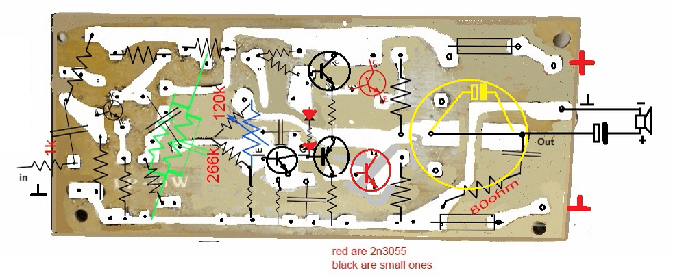

The fact is that if you change both 2n3055, the amplifier will still not work correctly.
There is one more error that needs to be found.
After this, the trimmer will start working, with which you can set the middle point at the output.
Only then will it be possible to connect 2n3055 and get an output power of 50 W.
