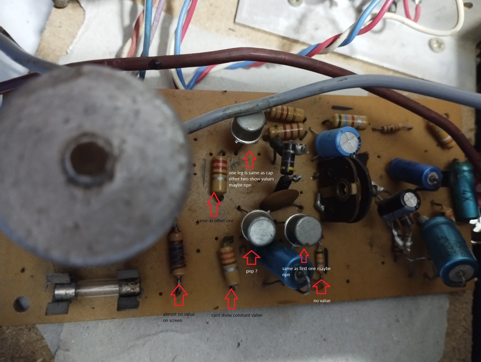

i hope so, people as for same things all the time xdd thats main issue for me. i posted my measurements and thats enough for one who knows. my profession is music so i know when i have to make a song what i have to do when customer tells me what they need. so my point is that for people who are pros my info should be enough, this amp was built by someone who is not skilled xddd
Dont get me wrong , all of you helped me and i am really thankful so i need someone to give me possible solution based on all info i provided

@sg97, In post #44, there was a resistor that was no value reading, did you replace it?

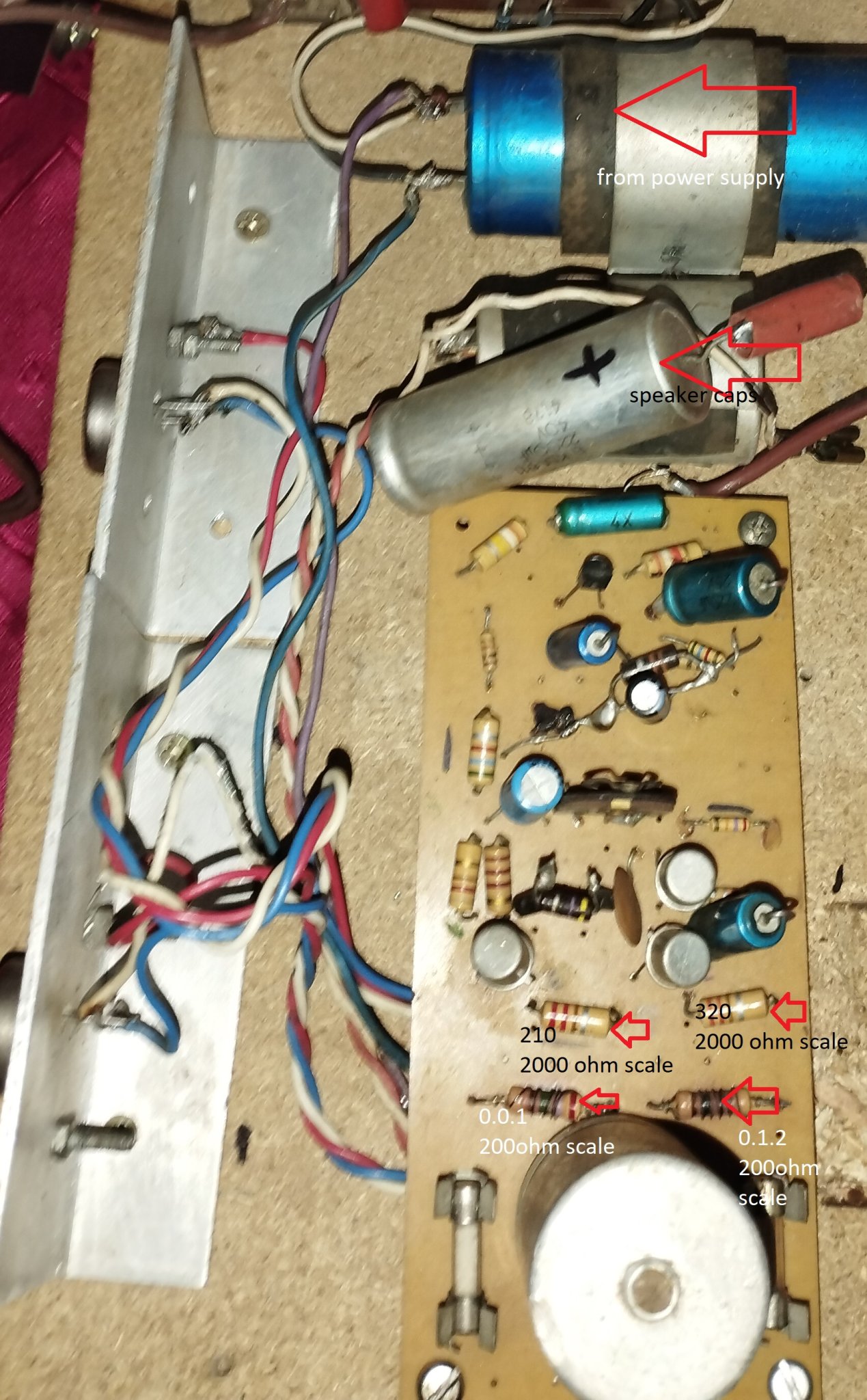

In post #57, one of the two 220Ω resistors showed 320Ω, did you replace it?

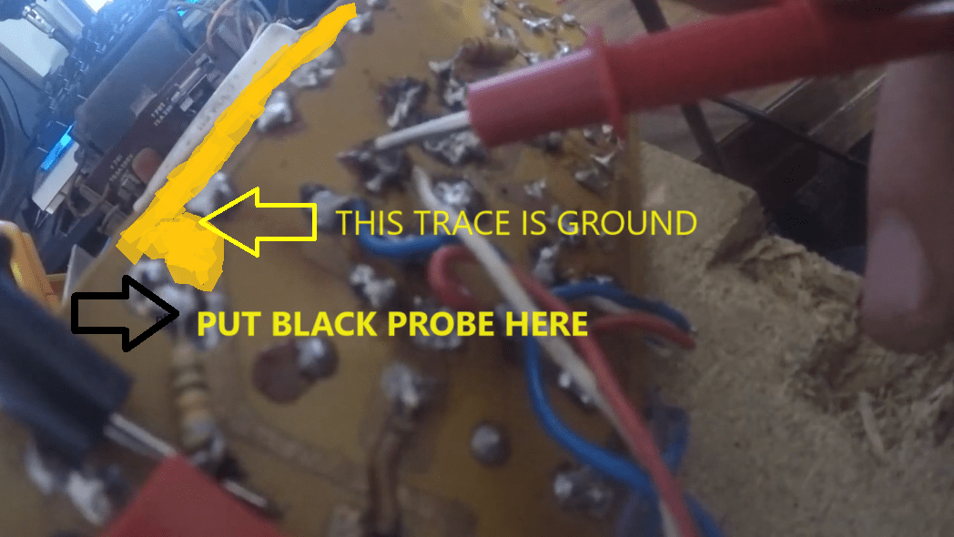

I also noticed that when you measure the voltage in post #489, the black probe is not on the ground trace.

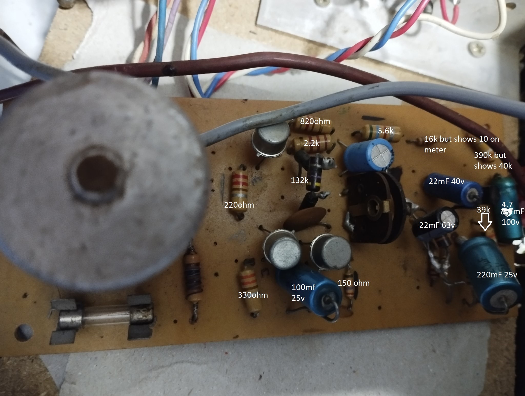

those wired ones are replaced with 1.5ohm that people said is ok, other resistor values you can check in piture that i provided@sg97, In post #44, there was a resistor that was no value reading, did you replace it?

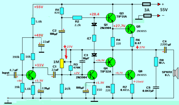

The resistor between the two diodes (132KΩ) definitely needs to be replaced! Please replace it with a 22-47Ω resistor and post the results.

If you don't have a 22-47Ω resistor on hand, you can connect the two diodes together with a short wire and check the center voltage.

In post #210 OP says this 47 ohm resistor measures 46 ohms...The resistor between the two diodes (132KΩ) definitely needs to be replaced!
If, when connecting 2n3055, the output is 0.8V, then the lower transistor has opened strongly, and there is no connection with the upper side.
This means that the 2 diode circuit is broken.
We need to restore it according.
