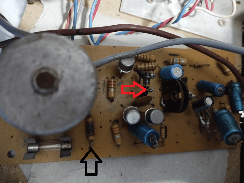

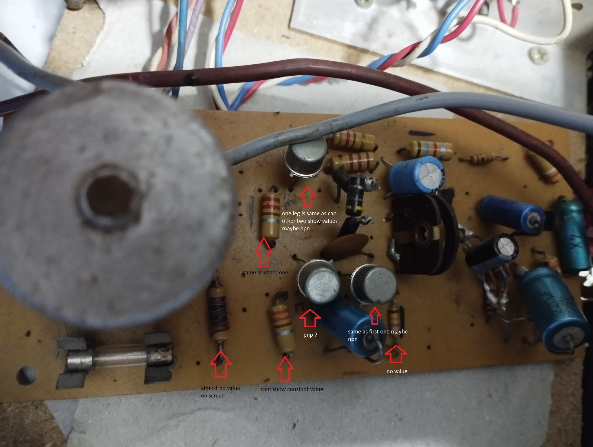

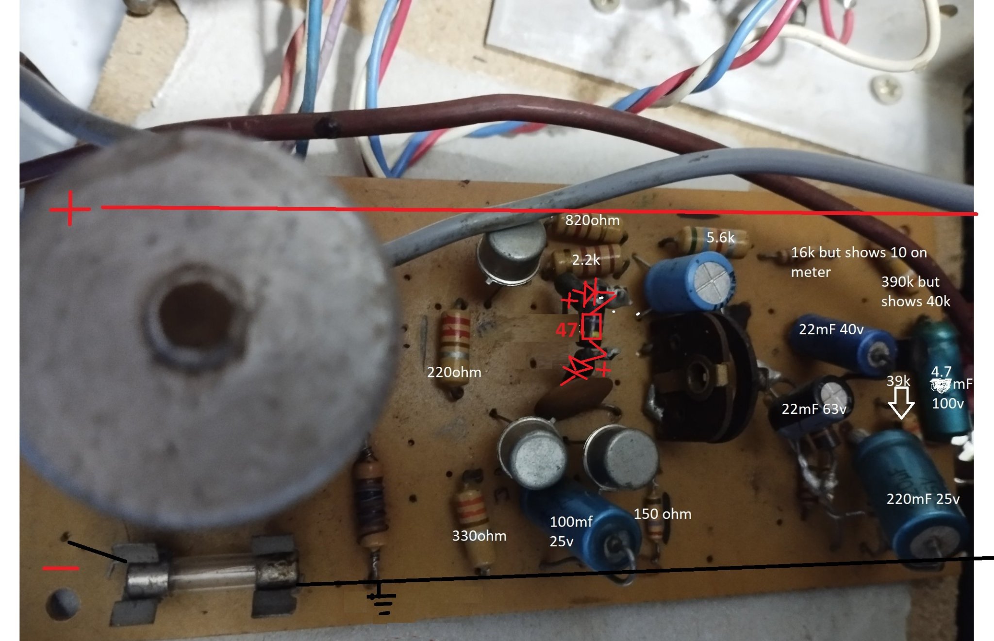

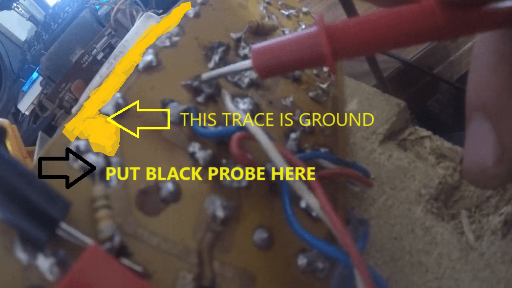

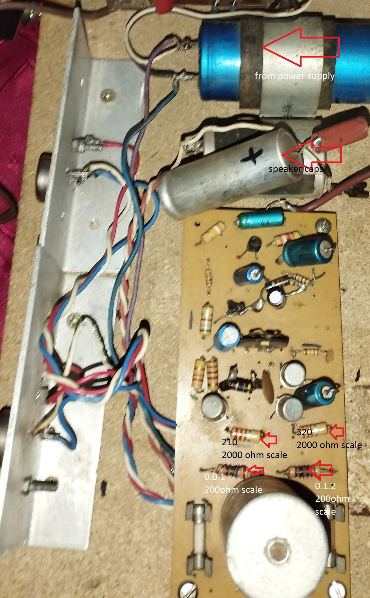

btw mostly those are old pictures so check one i posted today for correct values of components@sg97, In post #44, there was a resistor that was no value reading, did you replace it?
In post #57, one of the two 220Ω resistors showed 320Ω, did you replace it?
I also noticed that when you measure the voltage in post #489, the black probe is not on the ground trace.

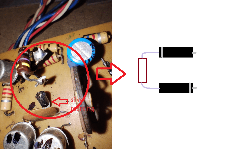

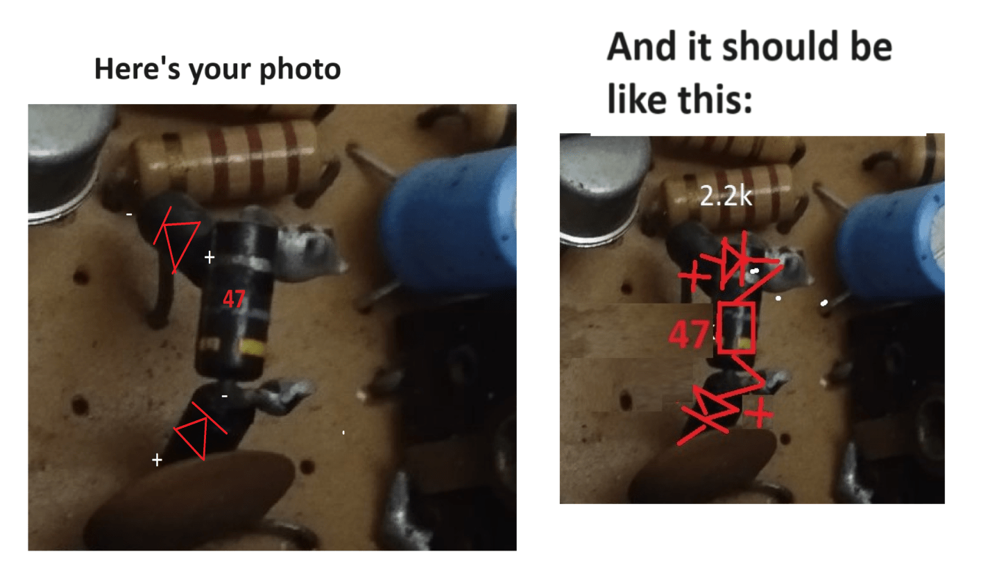

The diodes in the last photo are not connected in series. One needs to be 1 diode turned on the other way around.
But I can’t say which one, since the photo is very close and the rest of the details are not visible. 🙂

- transistor amp not working after shorting output
