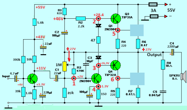

I don't see measurements for my question in post #482 on page 25.
Before measuring, you need to set the output voltage as close as possible to half the supply from +55V. This is approximately +27V. The 2N3055 output transistors must be completely disconnected from the board.
Approximately, for proper operation, there should be at six points:
1) +2V; 2) +28V; 3) +26V; 4) +1.4V; 5) +27V; 6) +1V.

Hi Wakh,
Yes, mostly correct. The centre voltage is set to a little less than 1/2. The supply sags under load, so the proper way to set it is to adjust for equal clipping at full power using an oscilloscope. Setting it to 25 VDC with a 55 V supply might be closer. 1.4 VDC at TP 4 would mean a 234 mW dissipation in the 2N3904, it's going to get pretty warm. 1 VDC at TP 6 will mean pretty high bias current in the output and the TIP32A is conducting less current than the 2N3904.
I would confirm R4 and R5 are not open. If either was, you would get very high bias current in the outputs. By open, I mean even a bad solder joint or broken trace would do the same thing exactly.

Before measuring, you need to set the output voltage as close as possible to half the supply from +55V. how exactly to do that ?I don't see measurements for my question in post #482 on page 25.
i forgot to say on first transistor is c-b 40v or 26 depends on trim position. but on second is always 7.5v
if i set trim to show 25v then bulb is glowing if i put it to the left to 38-40v then its not glowing, and i get bit of volume. but thats only for q5 if i am right other 2n3055 does not have same voltages
