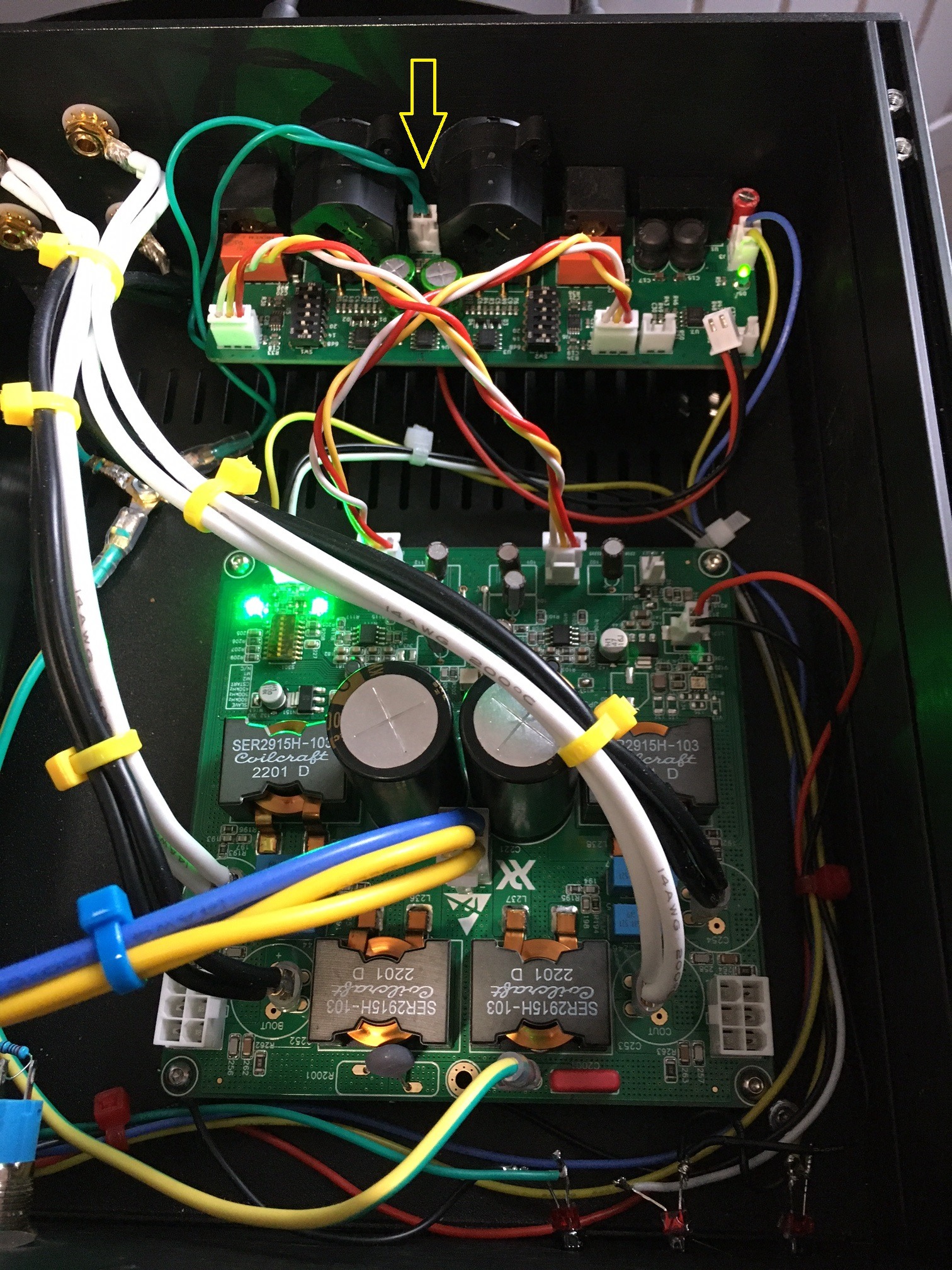

Really interesting stuff guys.
With the new amp board with external 15v from the SMPS 15v regulator and a new buffer board, I find that the amp does not make a horrendous buzz with no input connected and speakers connected. Very strange. Maybe this has something to do with the external 15v PSU for the ancillary voltages in the amp?
Regarding the RCA noise/buzz. With RCA inputs and my ear within 1in of speaker woofer zone, I can barely hear a buzz (60Hz) but almost inaudible. With XLR no sound at all.
Next, I disconnected the Buffer board ground (the dual pin JST between the XLRs) and the mild hum from RCA from iPhone dongle is now silent. It is still silent with XLRs as well. So it seems that there may have been a change to the grounding topology with the 15v coming from the external PSU in the SMPS. But using RCA from my DAC (which also has XLR) has the slight hum still. I suspect this is a ground loop from the RCA to the DAC. Connecting the buffer ground at this point does reduce the hum a tad (for DAC based RCA).
So my recommendation is this:
1. Do not connect the ground on the BTSB panel mount to the star ground point. Leave it disconnected if you have an isolated source like a DAP, phone, battery powered laptop etc. I can confirm that the buffer has no ground loops in this mode.
Note: the XLR shield is grounded to the chassis via a vampire connection on the XLR when it is screwed in. It bites into the chassis. Otherwise it needs no chassis ground.
2. Make sure you have a good ground wire from a screw holding the SMPS to the star ground. The plate for the SMPS is black anodized to not a good conductor.
3. Connect protective ground of TPA3255 amp to earth star ground.
4. Make sure the insulating silicone pad for the TPA3254 heat sink is good so there is no connection from chassis to the thermal pad of the chip.
5. Where is analog signal ground located? The best place to get it on the TPA3255 board is the middle pin of the two balanced input jacks at X101 and X111 (pin 2).
On Buffer board if you are not using the single ended outputs, pin 1 on J6 and J7 are the signal analog grounds. Also pin 2 of the balanced out of J4 and J5.
Of course, if you use XLR input none of this is an issue. I’ll continue to research this but I know the Warp-1 in the first batch had RCA’s that were silent.
Hope this helps for now.
