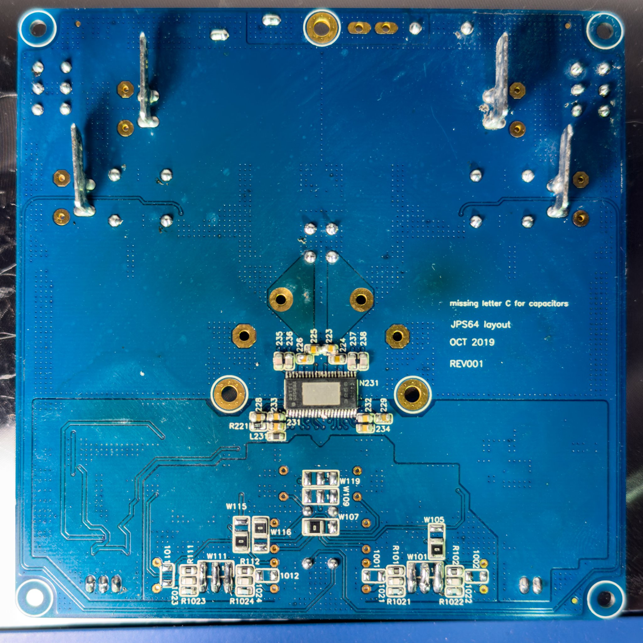

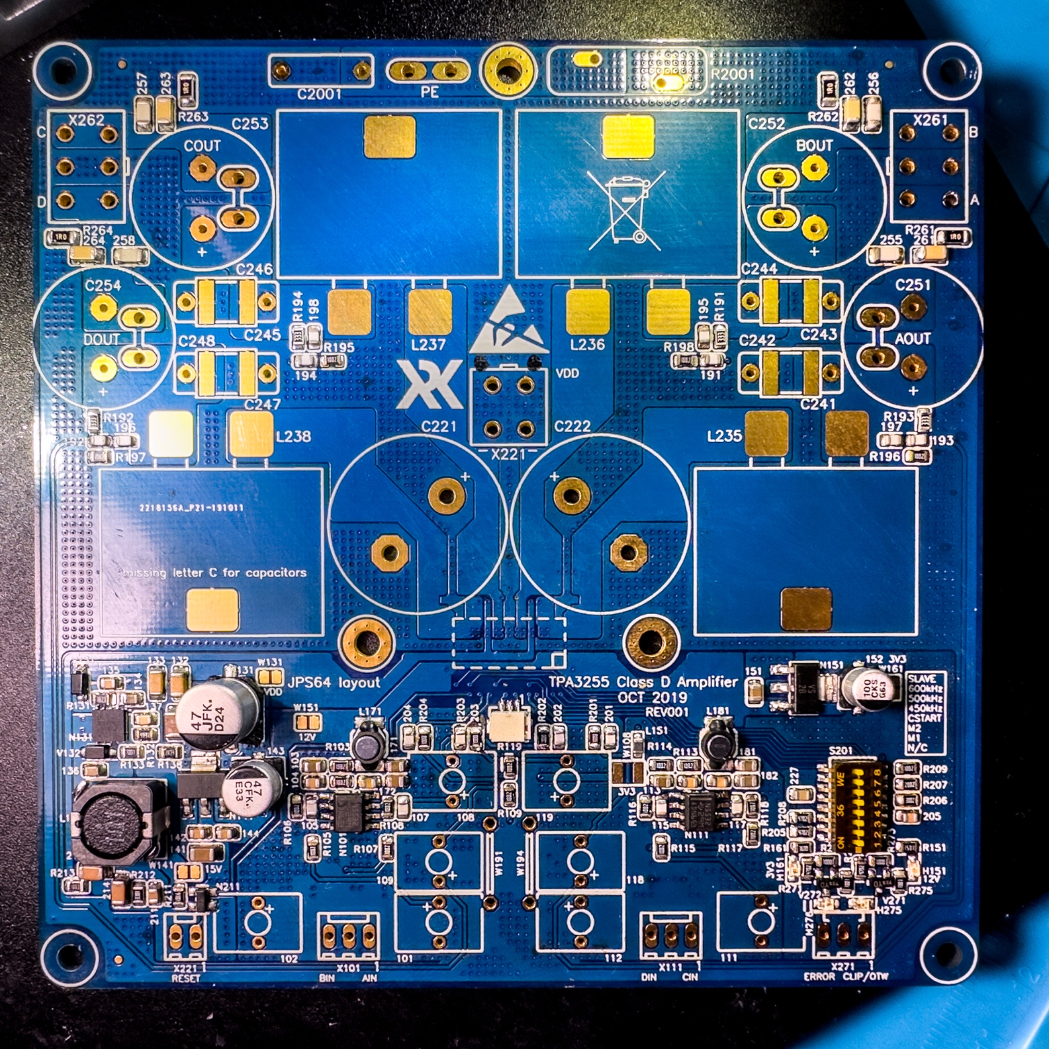

Hi all, been lurking on this thread as I work on this as my first DIY build, just finished all of the SMD parts. But I had a couple questions.
1) For the solder/wire bridges, I know I need w191, w194, and from looking at the pic posted earlier, I also need w161, w151, w141, w111, and w101, correct? I don’t need to bridge w131?
2) so for no PFFB 0ohm jumpers on the A,B,C,D?

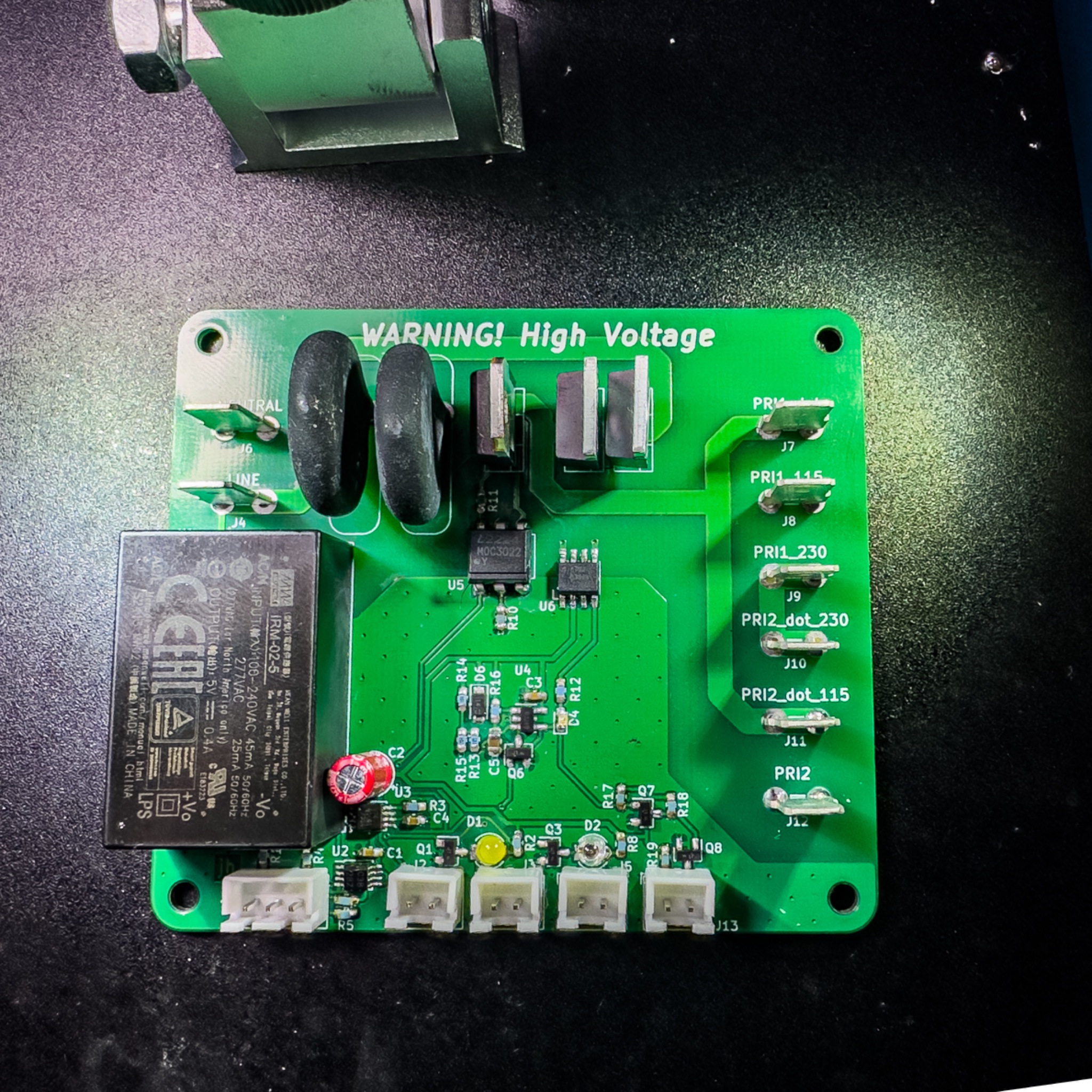

3) currently waiting on a SMPS from Micro Audio, question I had was that I was planning on using the SFPP. Realized I probably don’t want to instal that before the SMPS, as I want the always on going to the buffer, correct? So can I install it after the SMPS? Or do I need a different soft start module?

I’ll have to look at all the jumpers but all the ones on top side need jumpers so W131 yes. The bottom side selects mode of operation so go with diagram I provided.
No soft start needed. That’s only needed for linear trafo PSU. SMPS don’t have huge in rush current. The on/off low voltage switch is provided by the PSU connections.

Use 0ohm jumpers for no PFFB on A/B/C/D.

Actually just realized my board doesn’t have A, B, C, and D. 😅

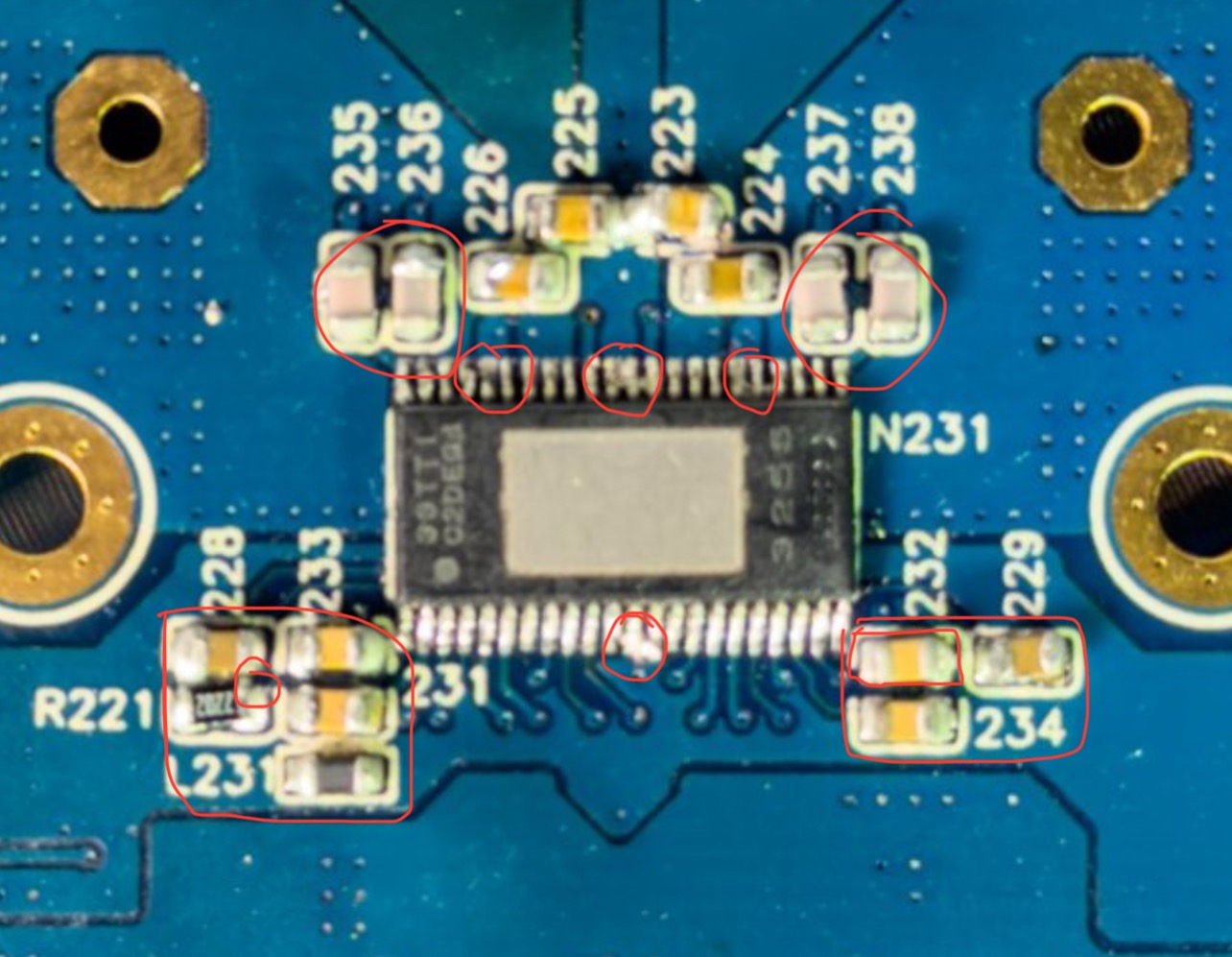

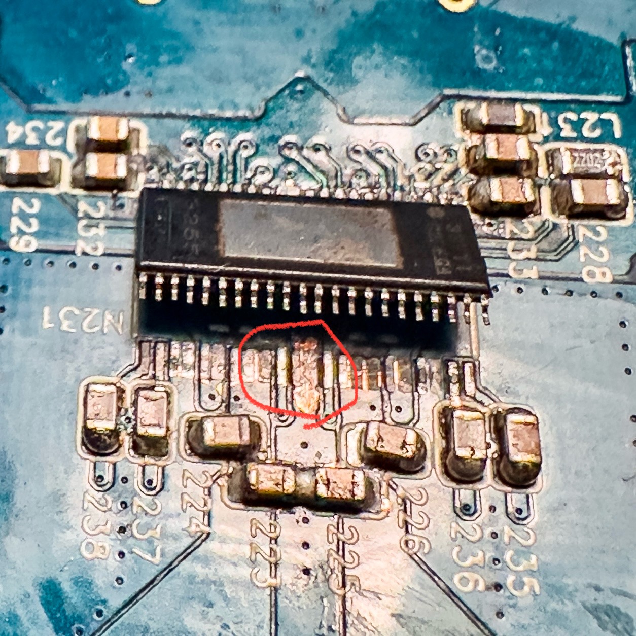

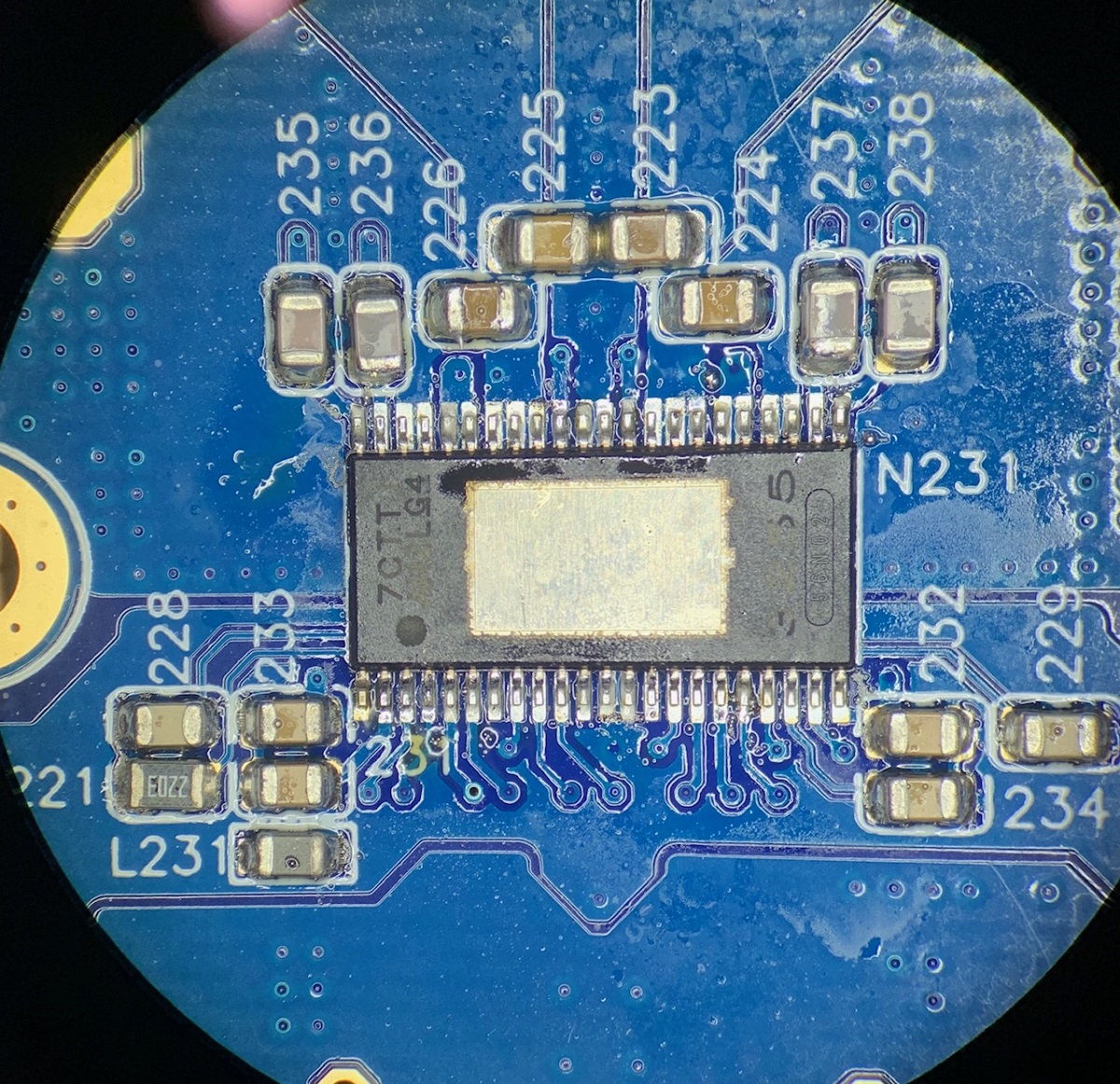

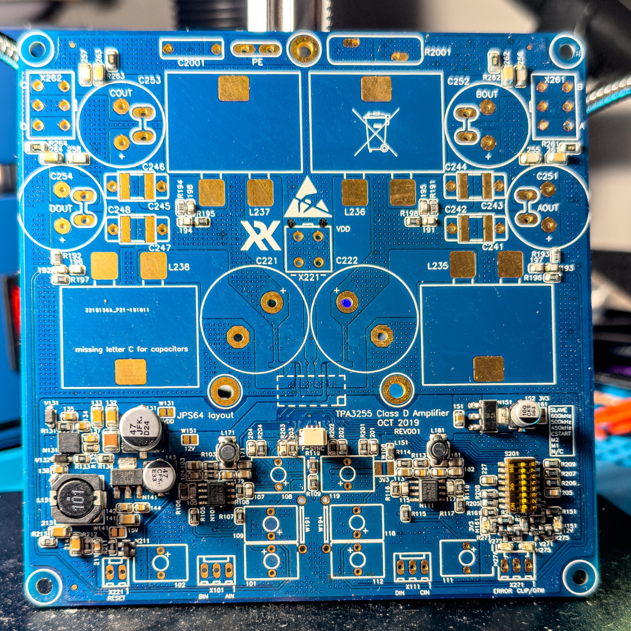

I would go over the solder joints on the legs of the TPA3255 chip with a hot iron and liquid flux on copper braid to clean up excess solder. You may have bridged joints. Also the solder looks crusty and not glossy smooth like the temp wasn’t hot enough. Reflow it with a hot chisel tip. Same with red boxed areas on the chip capacitors etc. especially the bootstrap ones on the output side. Those get a lot of voltage stress. Your chip looks a little shifted on bottom edge causing the diagonal shift.
Here is what mine looks like with hot air topside and solder paste with frypan on bottom side. Frypan temp set to just below melt to provide preheat to the PCB.
I would recommend paste vs soldering iron for this. You can use an iron but be sure there are no bridged joints on the legs.
It’s ok if the two center pins are bridged since they go to the same ground.
But just need to wipe it with solder wick. Those TPA3255 pin pads look like they may be damaged or peeled off? Be careful cleaning them with solder wick.

Looking good! If the two LEDs showing 3.5v and 12v light up and you did everything else correct it should work. Check DIP switch settings for correct configuration. I assume you are doing stereo BTL?

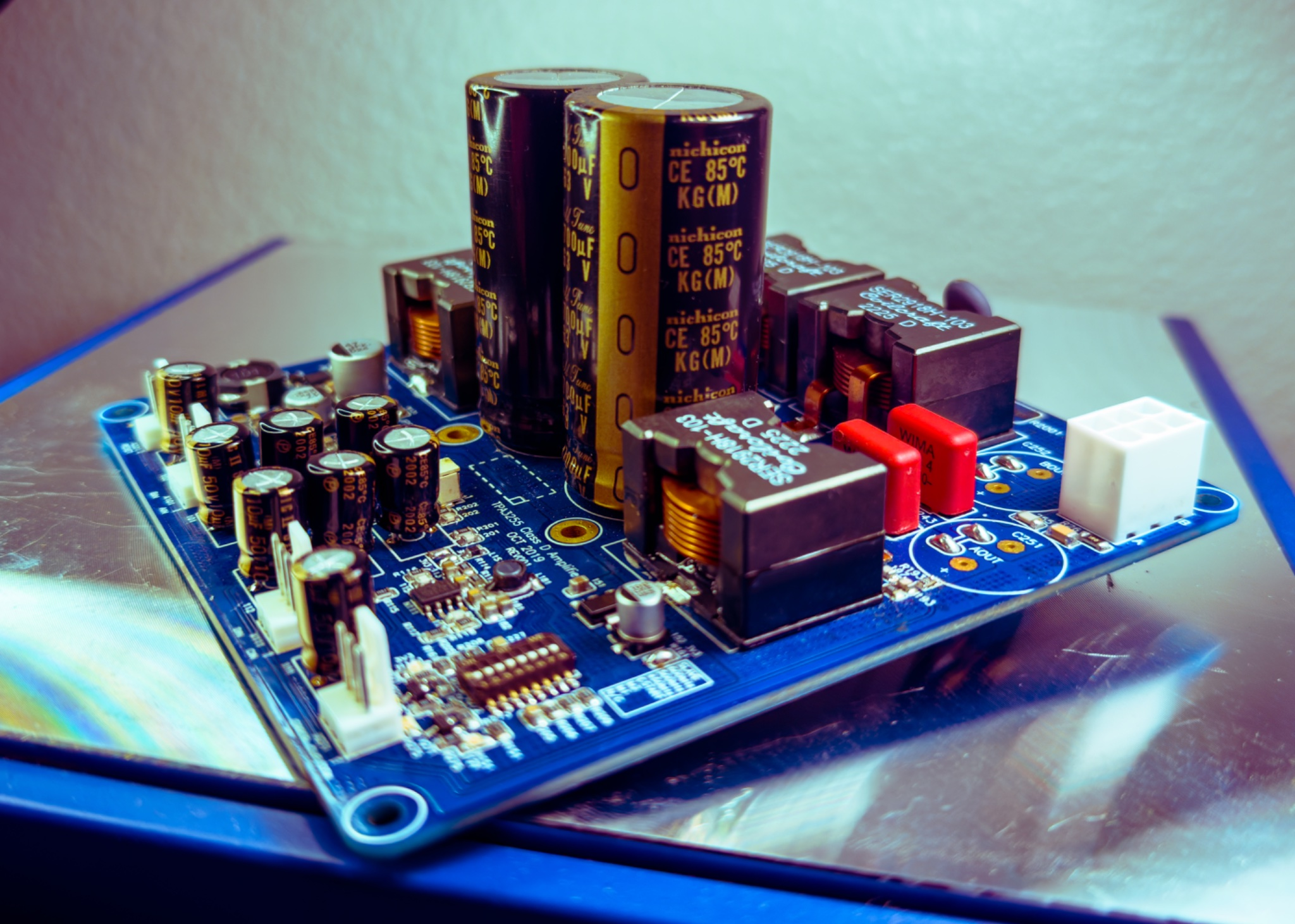

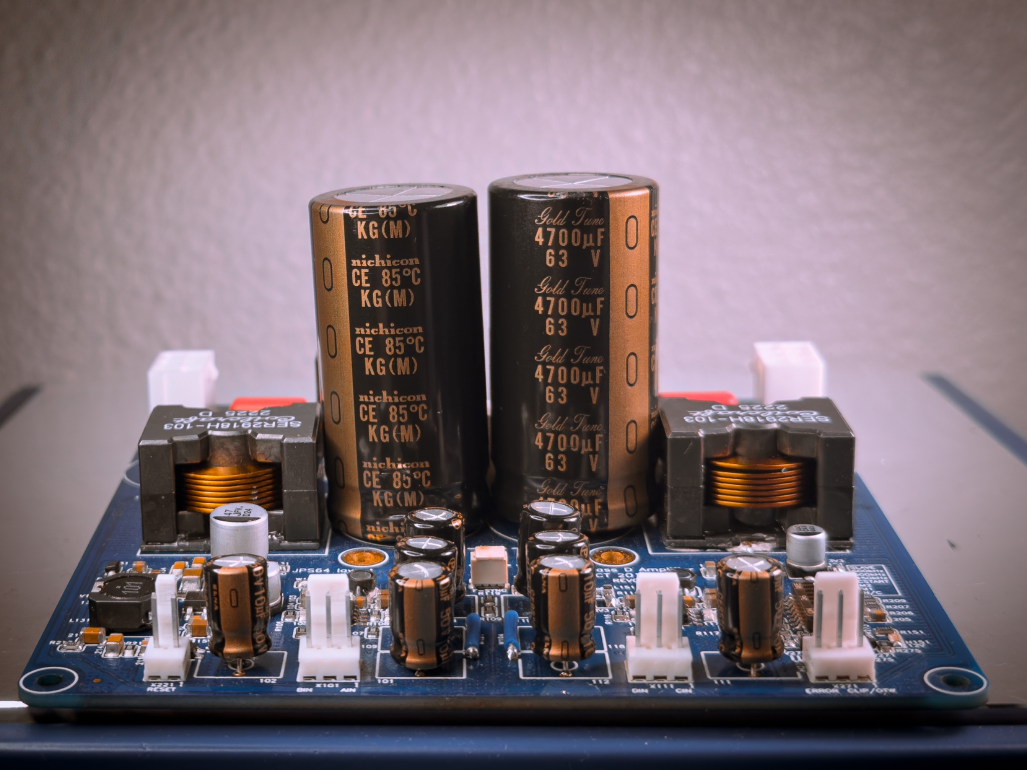

Thank you! Think I got it! Finished the main board, SMPS comes in next week, so I guess we’ll find out then! Can’t wait!
Looks beefy for such a small board!
