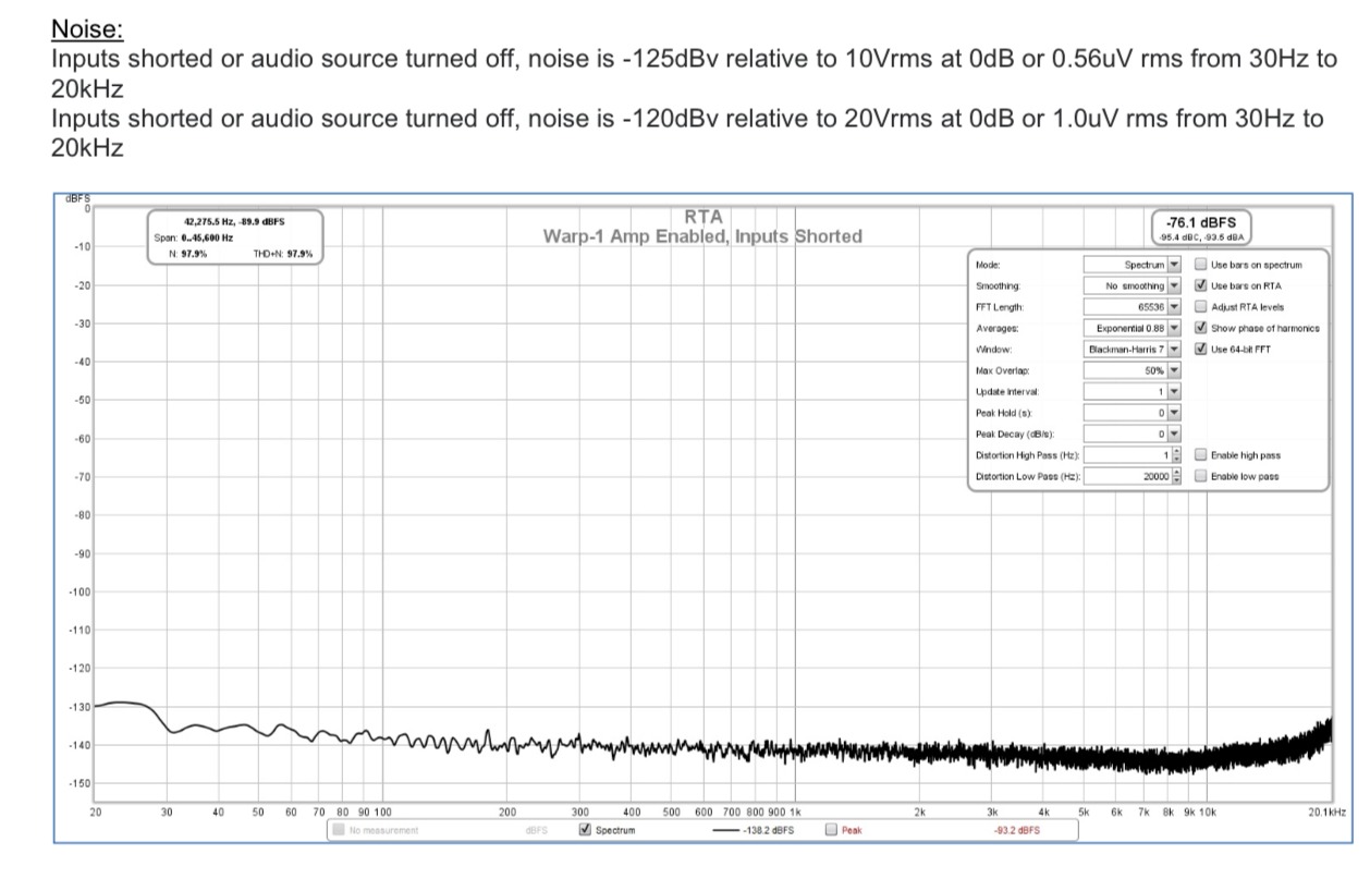

Balanced is great stuff. With shorted inouts, the Warp-1 (this exact combo of PSU, BTSB, and amp) is one of the quietest amps I have ever measured with about 1uV rms noise background. Essentially black black background with no music playing.

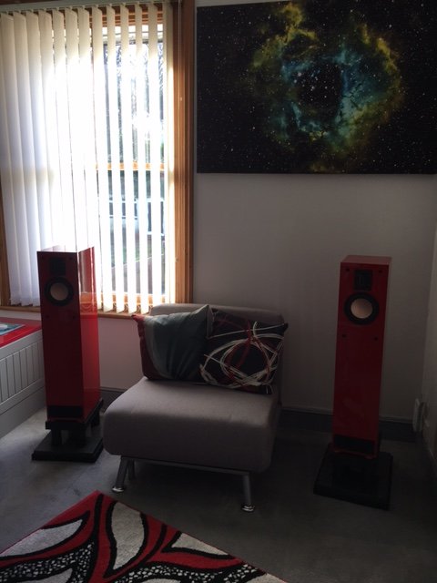

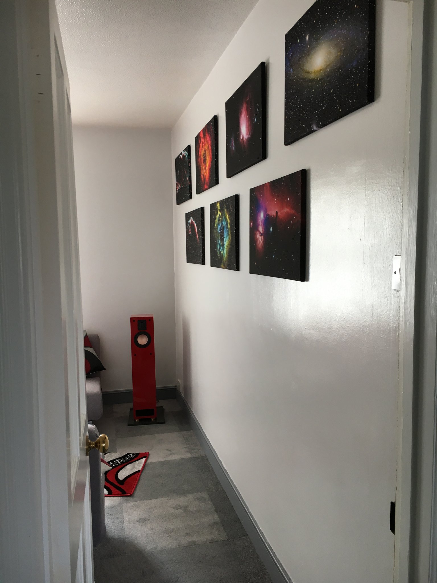

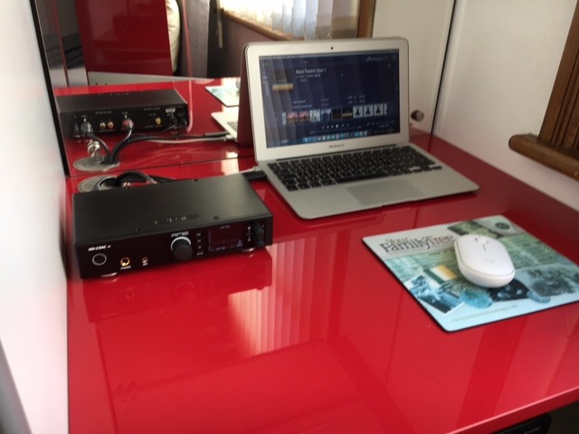

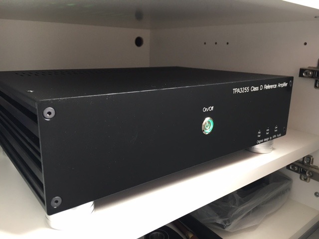

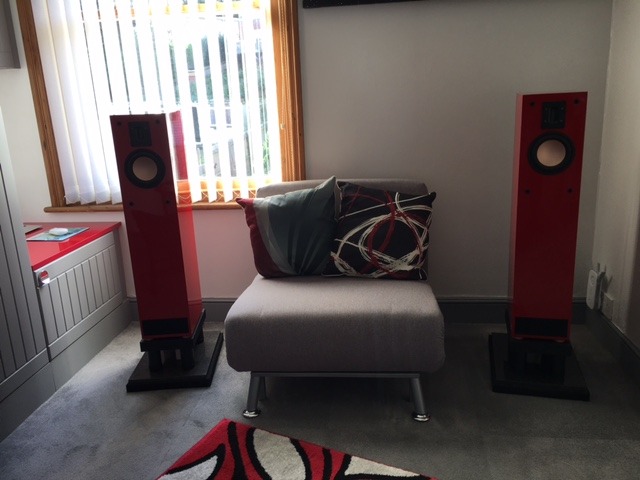

Hi XRK,

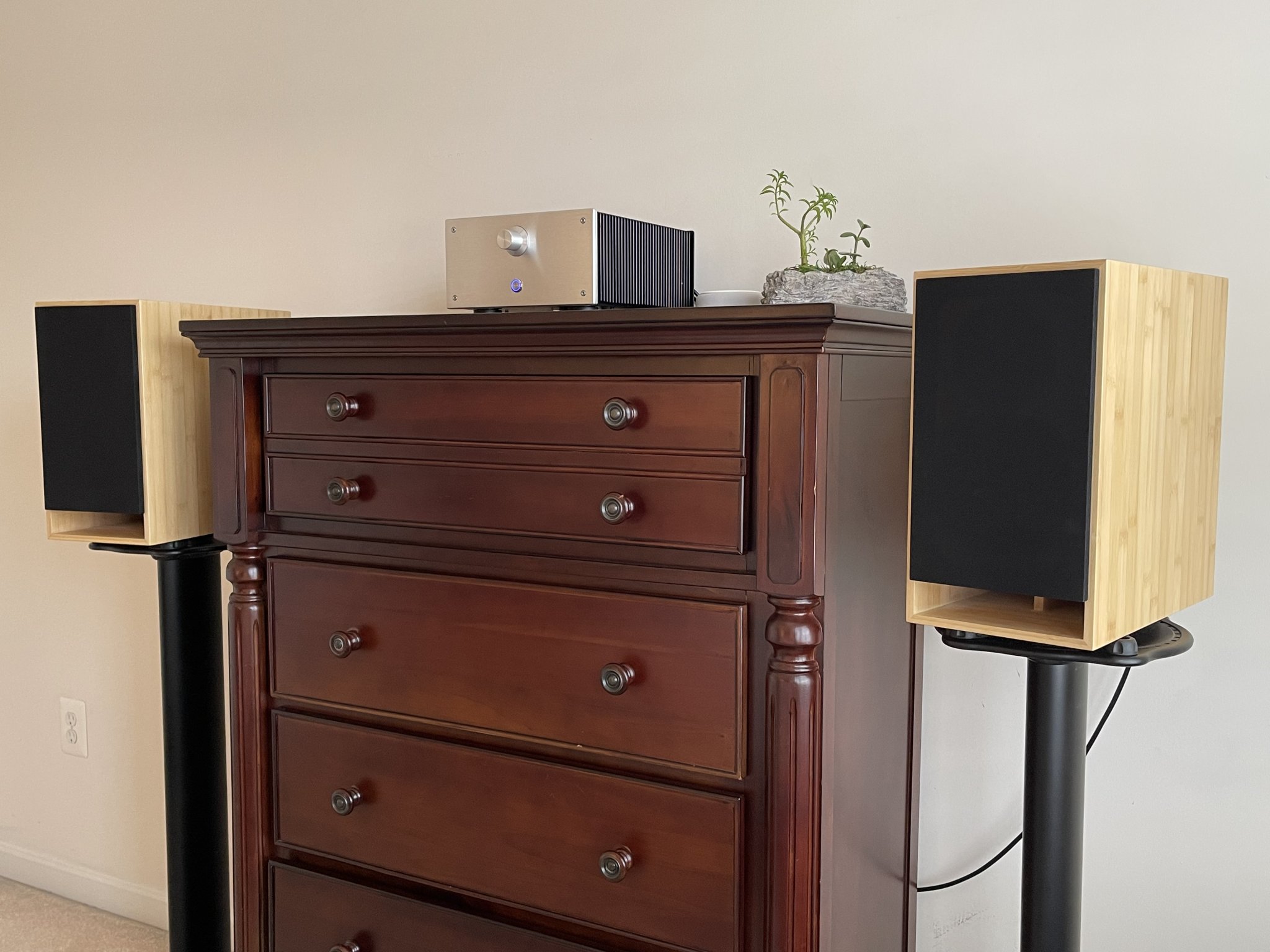

Some photos attached ...
Details:
1. Setup is Macbook Air running Audirvana 6.5 -- RME ADI-2 FS dac -- TPA3255 -- IPL Acoustics M1tlm transmission line speakers (also DIY built by me). Van Damme STARQUAD Balanced Cable with Neutrik Gold XLR connectors. Audioquest Cinnamon USB cable. 2.5mm OFC speaker cables.
2.. My small 'music room' needs to double-up as a spare bedroom, hence the laptop/DAC/amp being confined to being on/in the corner cupboard as shown. This dual purpose use means I also need to live with the 'put-me-up' bed-chair placed in between the speakers. I guess many of us need to live in real homes and make hifi sacrifices ... none of this is ideal, but ce la vie!
3. Amp chassis pics already shown in my post #278.
4. My apologies and thanks to @soundwavesteve for his inspiration, because I've blatantly copied his superb design for the front panel text! Sincerely hope you're OK with that soundwave, as it's meant totally as a complement to you - your result looked so good, and so right, I couldn't resist doing the same! If you're offended by me doing so, please do slap me on the wrist and I'll happily redress this!
5. You'll notice a few astro pics on the walls as well - I'm into astrophotography, what you see are all my own work!

Nice setup! Looks very neat and tidy and I like your TL speakers!
Do you have a link for more info on those? What drivers are you using on the speakers?
I don’t think Steve is going to have any issues with you copying the front and rear panels. 😉
IPL Acoustics: https://www.iplacoustics.co.uk/
Small company based in Devon in UK, owned by Ivan Leslie, specialising in 'best bang for buck' speaker designs . A range of DIY speaker kits to suit all tastes and room sizes. After seeing a multitude of rave reviews I purchased the complete M1tlm Ribbon 'kit' which, at the time, included all pre-cut woodwork as well (I note he doesn't supply the woodwork for many of his kits, now). I then assembled the kit and, after one or two abysmal attempts at painting by me I got a local car paint spray shop to paint them in 'Ferrari Red'. I know my limitations!! Once drivers and crossovers then fitted, a few more days experimenting with different amounts of long haired wool at the top of the TL port (just behind drivers) until I was happy, and job done.
Bass drivers are Ivan's 'IPL matched' units, which are Hi Vi Research (part of Swan Speakers group now) shielded double magnet 5" magnesium cone that have been specifically selected and matched as a pair by Ivan (more details on web site that explains this). Tweeter is Fountek CD1.0 ribbon.
Ivan is quite clear on matching the size of speaker to size of room - so much so that he'll dissuade you from going bigger (i.e., more expensive) if he feels it won't work for you. Now that's what I call service! For just 5" drivers, they really 'rock' as well - nothing like a transmission line design for deep powerful bass!

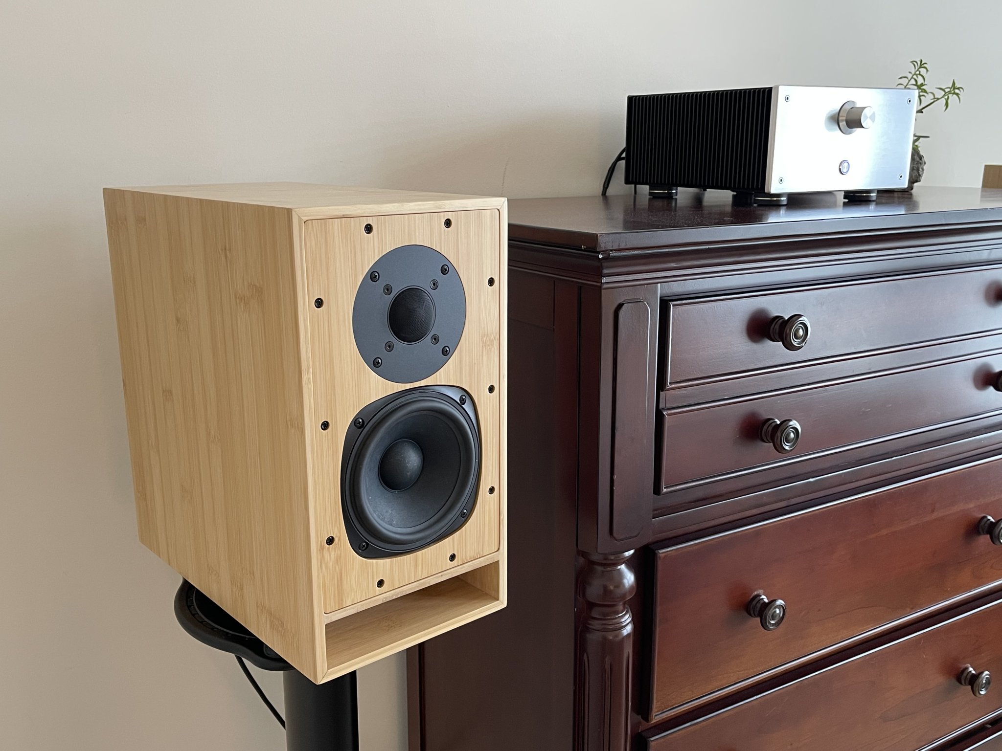

I also am a big TL fan. I have a DIY version people have built with good success. Also 5in woofer but with 28mm dome tweeter.

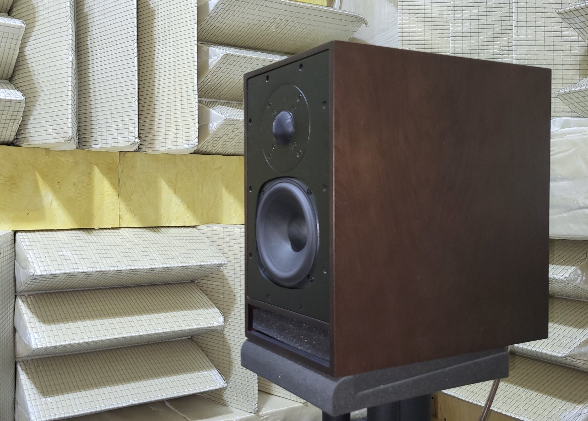

I have a TL now commercially licensed to Galion Audio in Canada. It’s called the TS Voyager TL.
My prototype is in bamboo but Galion production will be stained birch.
Here is the Galion TL getting measured in a chamber:

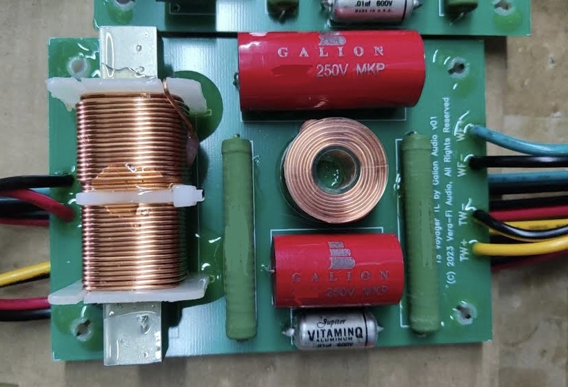

Custom crossover I designed:
